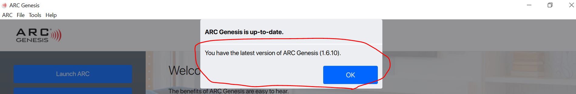

I have now just upgraded to ARC 1.6.10, i will have another look again if this version works well for multi sub blending and Subs to mains blending.
Back to 4 dedicated vs 2 blended pairs using 1.6.10, will share my findings.
I can confirm ARC 1.6.5 doesnt work well for multi sub blending and Sub to mains blending. It works nicely only if you have a single sub set up in the system.

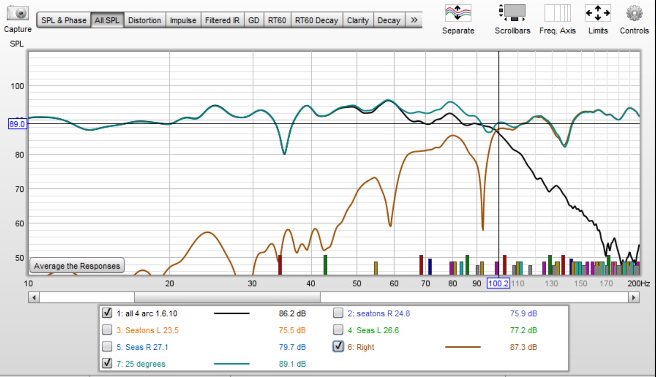

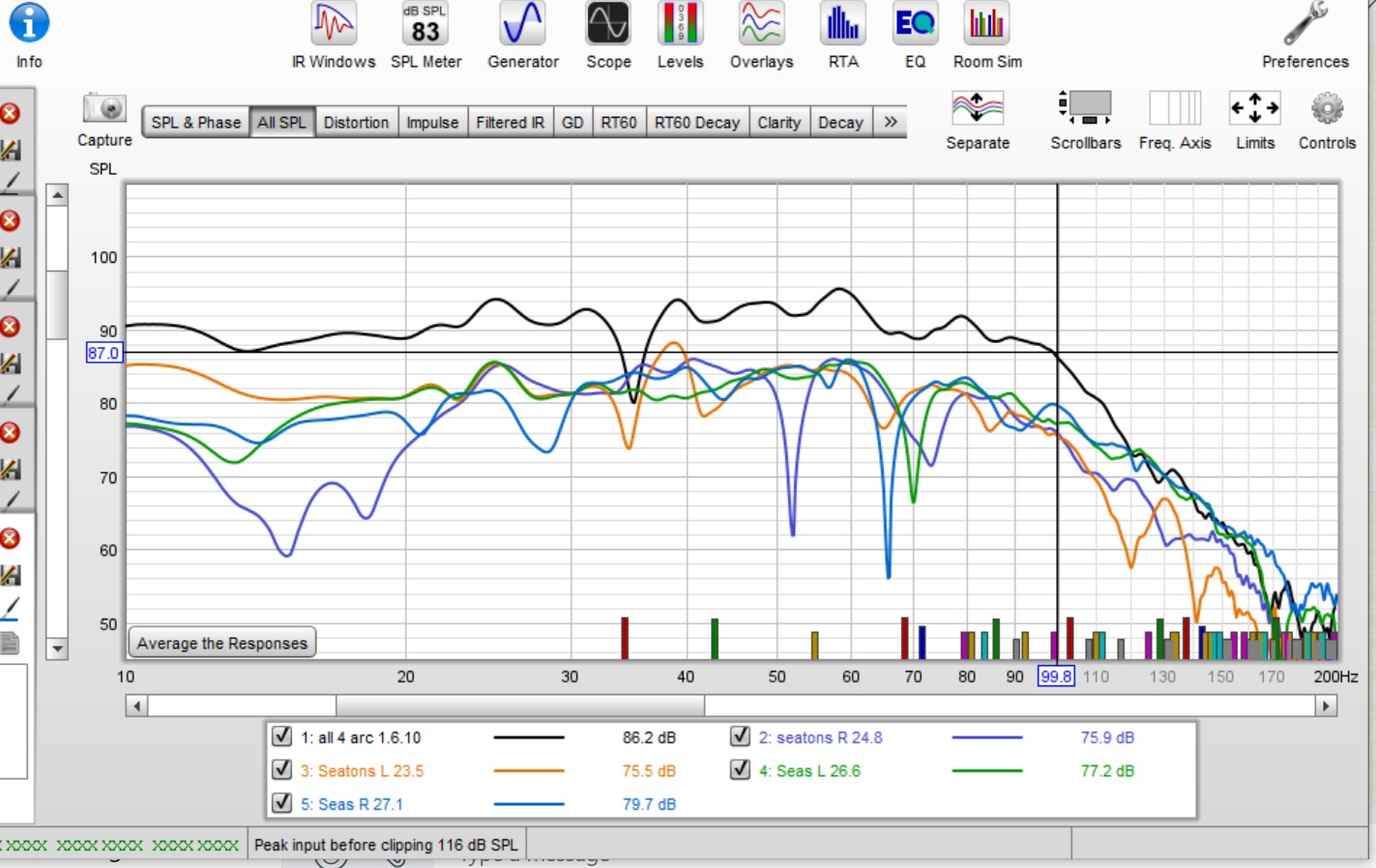

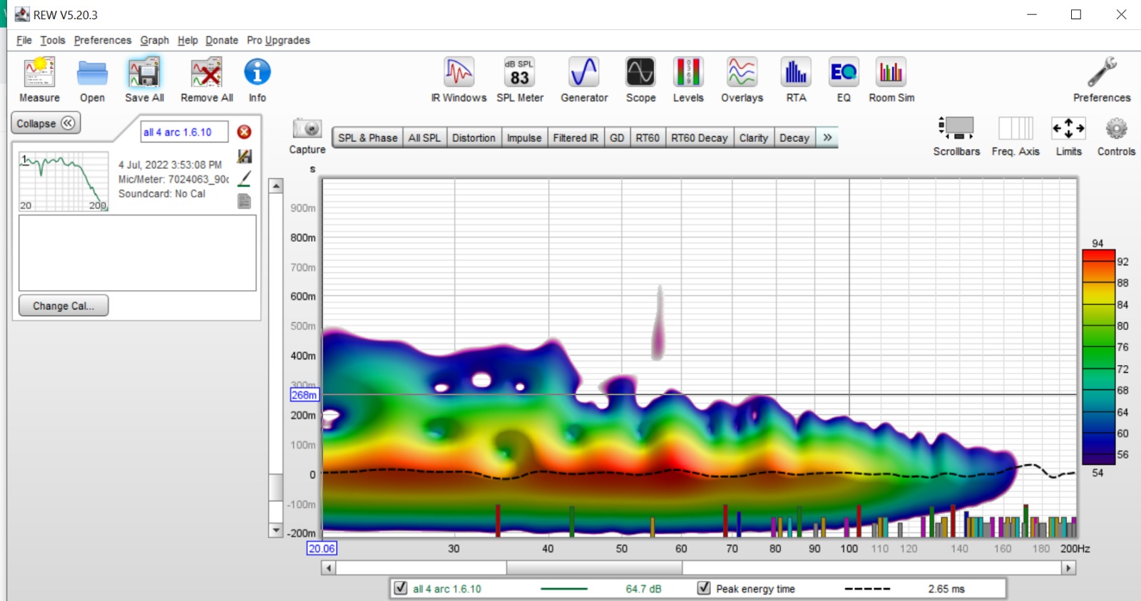

Good news and bad news ! I did a quick 2.4 stereo to confirm measurements on all subs
With version 1.6.10, all 4 subwoofers are blending nicely now. I have just completed the verification process. All SPLs, decay, THD numbers are all good
Perfect sum in black
The summation of all 4 subs now look very similar to the lyngdorf eq. decay also looks better below
Woo Hoo!
Can ditch the splitter !! Ditch ahhhh
But the auto phase feature is still not ideal…
You can see there is slight cancellation at 95hz, but not too bad !! Can be fined tuned .

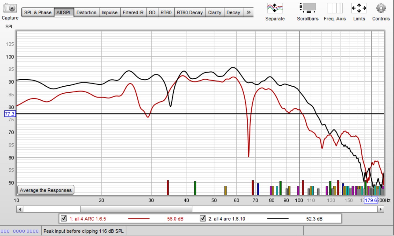

Wah looks like 1.6.5 is no go for multi sub users. 1.6.10 is the software to use when blending 4 subs.
See comparison of 4 subs using different version of firmware 1.6.5 vs 1.6.10. No changes to sub location, at most slight variation of mic placement by a few cm
So poor the blending on 1.6.5, anthem must have realised it and provided an updated 1.6.10
Wasted 3 days of my time confirming 1.6.5 ! Grrr… should have started off with 1.6.10… hmmm
