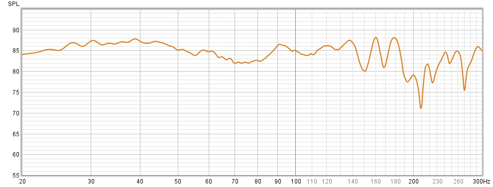

Below is the FR taken using REW with no smoothing applied. Have 3 subs ( 2 front + 1 rear ) integrated as 1 using a miniDsp 2X4 HD. Did ARC then auto phase. Crossover was set at 80Hz by ARC. No dips peaks in the sub to mains crossover as well as the sub region. There are dips though from around the 140Hz to 300Hz region specially from 185Hz-240Hz. Any advice to help improve the response? Thanks.
Are you asking for advice from ARC perspective or bass response in general?
Since this is already a combined output, I assumed there is already some EQ or shaping done on the miniDSP?
From HT perspective, I would not be too bothered with anything above 120Hz as most common sub crossover setting would be around 60-100Hz… thus all response beyond that is irrelevant (ie not used/no impact).
On paper, the response is pretty solid, the dip between 50-90Hz is pretty shallow and ARC can easily fix that I would think.
I’m asking from the ARC perspective. Yes a house curve was applied by using room gain+deep bass boost. Also EQ was limited to 500Hz. I have no complaints on the bass response…pretty even from 140Hz and below. On the 80Hz crossover region it’s quite good as well. My concern are the dips on the mid bass region. Arc doesn’t seem to have corrected. I’m not sure but I think those dips don’t show up in the ARC PDF file but when I checked via REW it’s there. My suspicion is it might be SBIR related?

Is the chart a combined FR for your L+R + sub?
How do you measure this on REW?
Single L or R channel or combine L+R channel?
Those dips are most likely due to room, speaker + MLP interaction.
So it’s quite difficult to analyse without a clear visual of all these parameters.
Are your room treated? Usually higher freq can be improve with proper diffusion and absorptions at 1st reflections.
SBIR (Speaker Boundary Interference Response)
Is the chart a combined FR for your L+R + sub?-Yes
Single L or R channel or combine L+R channel? Combine L+R
Are your room treated? Yes
Usually higher freq can be improve with proper diffusion and absorptions at 1st reflections-Front half of the room is treated with absorption panels…the rooms decay time is just a little over 200ms which is already on the dead side
Anyways it’s not really an issue for me since the most important thing I think is to have an even bass response plus a good sub to main integration which shows that in my 80Hz crossover region there’s barely a dip. I was just curious to know if there’s anything that I can improve upon.

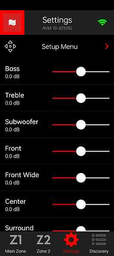

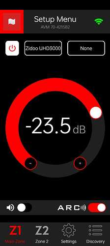

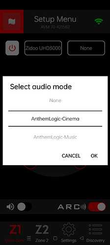

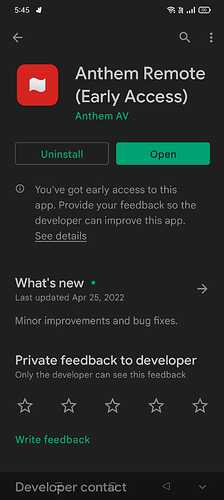

Thanks to a bro whom shared this APP and I tested it work with my AVM 70. :slight_smile:
Hard remote put aside. :slight_smile:

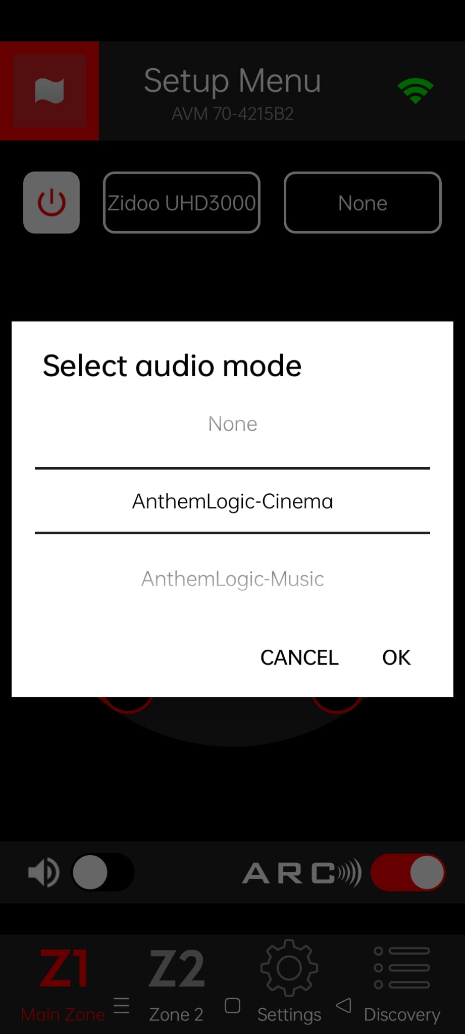

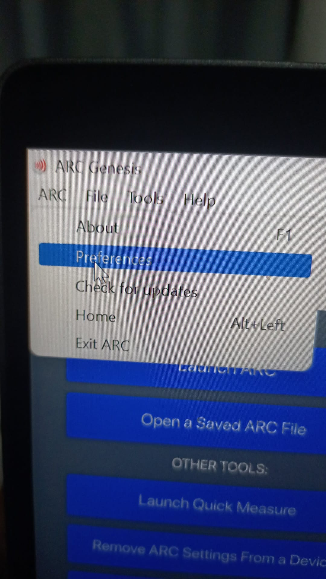

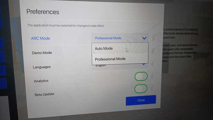

Have encountered this frustrating issue encountered with 2 bros with regards to ARC genesis.
They have installed it default auto mode and cannot find the adjust curve function etc.
Need to install professional way first time if
not need set preferences to Professional mode via below ARC Preferences:
Need set the ARC Mode to PRofessional mode instead of Auto Mode
Yes. You will need to set to Pro mode in order to make adjustments to ARC settings. Auto meaninv let ARC takes over the whole calibration “automatically”… Let the name suggest.

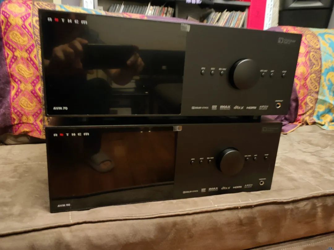

AVM90 vs.AVM70 vs. Arcam AV40 vs. JBL SDP55, unfortunately in chinese
Anthem AVM90 experience, compared to Anthem AVM70, JBL SDP55 and Acram AV40

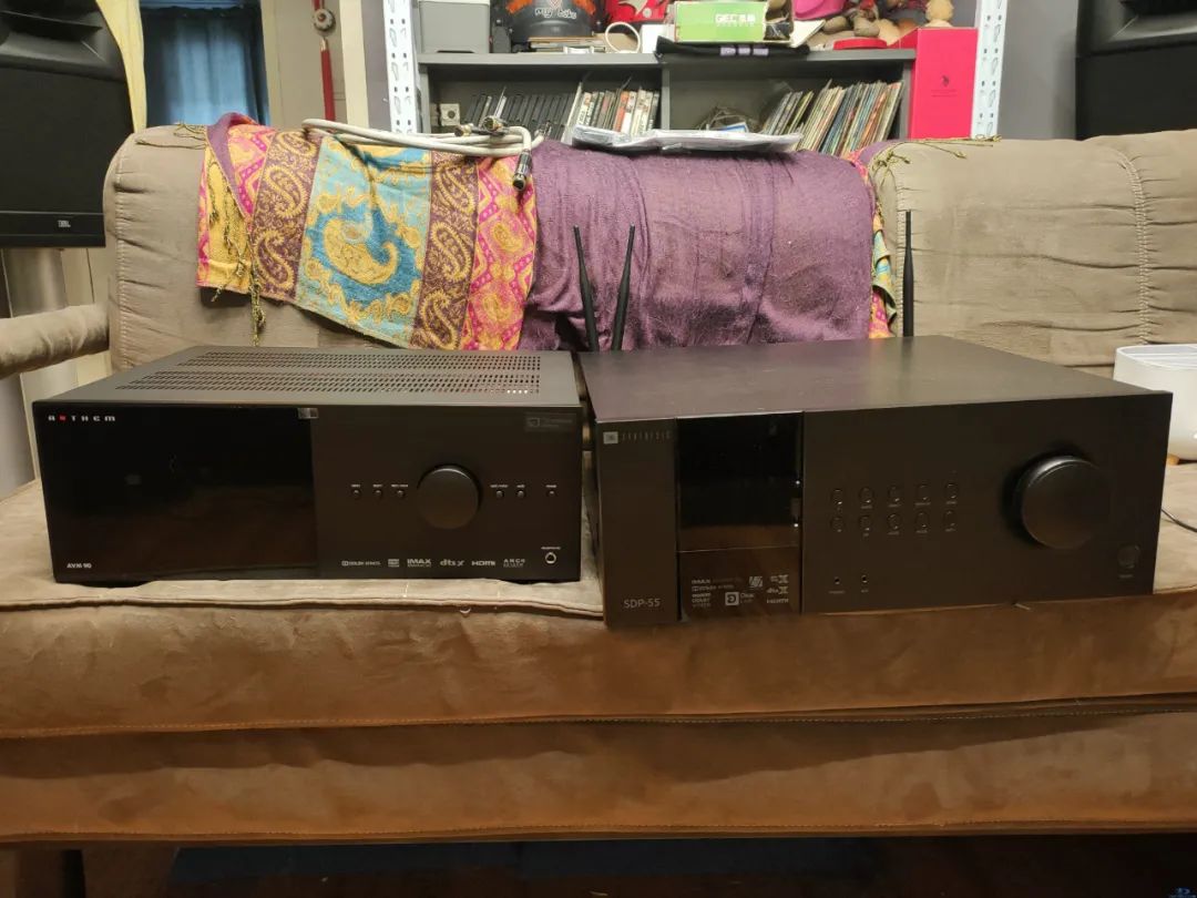

Group photo of AVM90 and SDP55

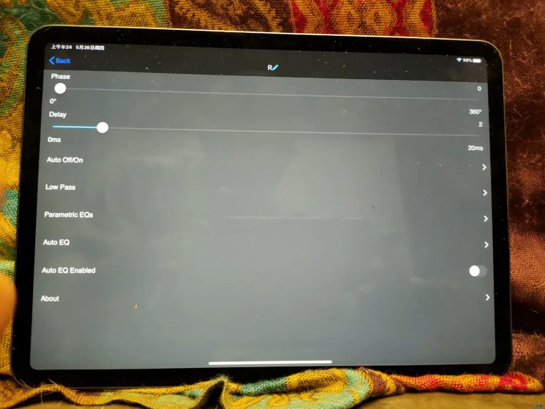

Yili’s own low-level management can be completed by using the APP

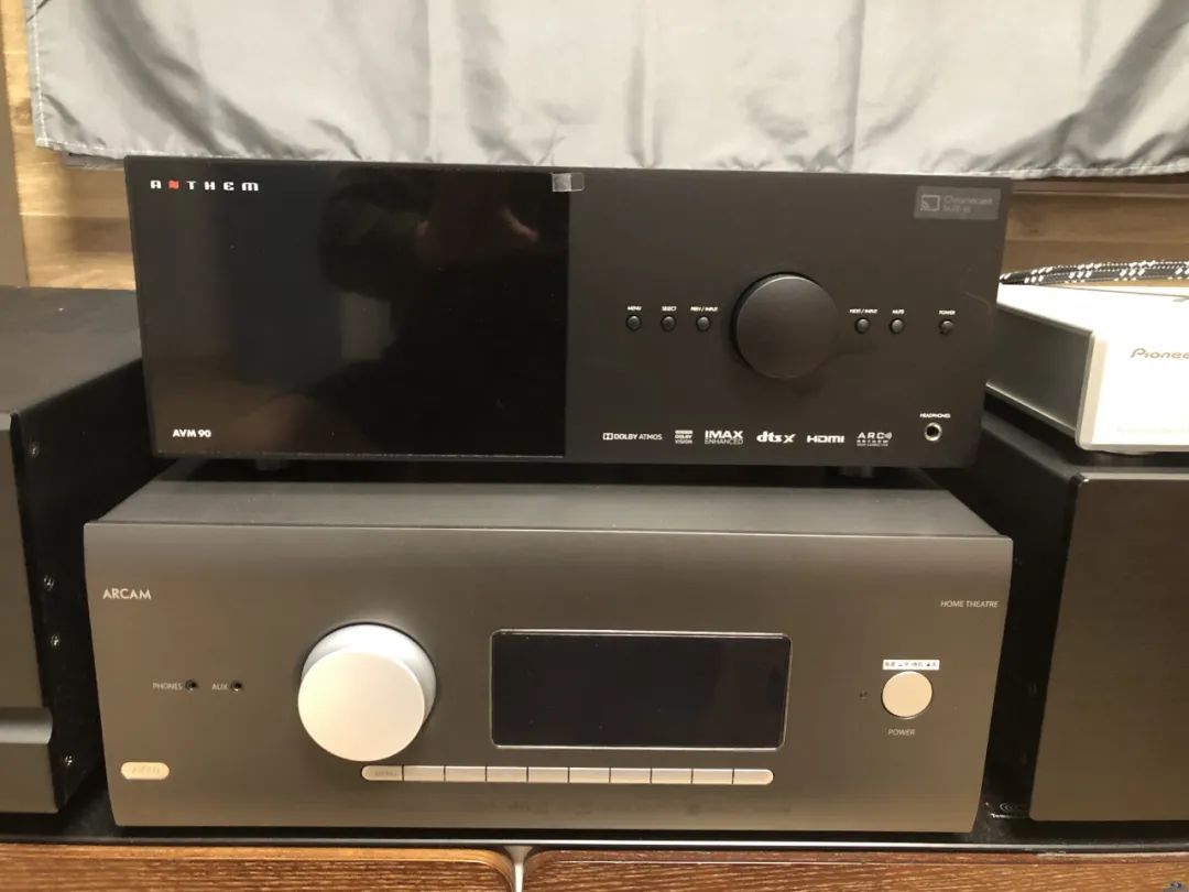

Group photo of Anthem AVM90 and Yajun AV40 at Xiaoshutong’s home
In order to keep the front end from affecting the sense of hearing, I brought my customized version of the MK2 from Macau. The power cord was not changed to the American standard because the book boy’s house did not change the American standard. I temporarily replaced the head and tail of the Watt American standard with the national standard Ou Yade, and the power cord was still Minli.

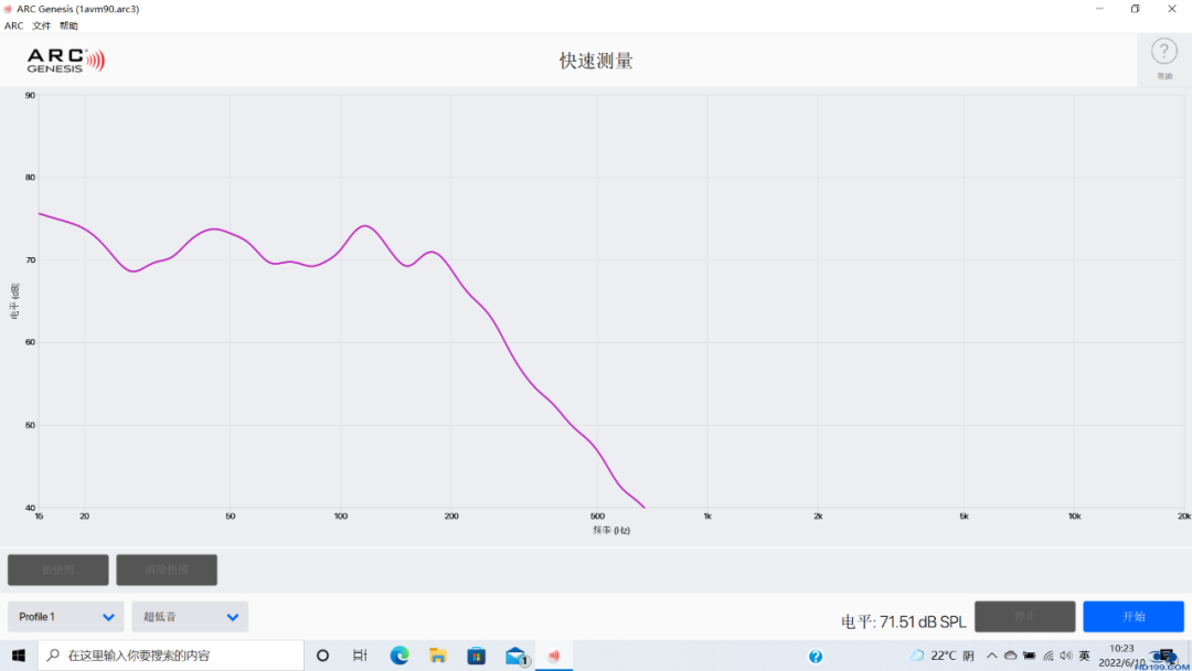

When I got to Xiaoshutong’s house, I connected the AVM90 to the Pioneer player (Nongao version 9708V2 mk2) and the power amplifier, and the ARC started automatically. The debugging process is not shown. From the measurement results of ARC, we can see that the curve of Xiaoshutong’s house is much better than that of my house. The large space and the effect of the acoustic module are obvious. Above 500HZ, it is almost a completely overlapping straight line. After tuning and opening, the kick-off series came on stage. The AVM90 sound field was finally opened, the surround was very active, and the sound field was very detailed. The positioning accuracy of the swarm attacking the UAV around the lake in “The White House Has Fallen”, and the clarity of the trajectory drawn by the space interspersed, amazed me and my fellow student Xiaoshutong, and confirmed that the main frequency of this piece is 1.6Ghz The powerful spatial calculation reduction ability of the brand-new dsp; the guns, car engines, and various sounds of “Bumblebee” being pursued by the US military cannot cover up the passionate background music. It can make people’s emotions fly. Shutong and I were immersed in it while watching and communicating. Several hours in the afternoon passed in an instant, and the experience was very good.
In an environment of at least 25 square meters, the AVM90 has an overall level that is ahead of the Yajun AV40. Whether it is an active surround sound field , 3D spatial positioning accuracy or the authenticity of the sound image, it is ahead of the Yajun . As for the dynamic sound quality performance, needless to say, it is far ahead. The AVM90 has a high signal-to-noise ratio and a large dynamic range. Watching movies at low volume still has a good sense of stimulation. The strong dynamic of weak sounds will cause the sound to be loud in the sense of hearing. In fact, it is only a large range of sound changes. The slices are not boring. None of the machines I have used have this level. The same gunshot at high volume is much stronger than the air burst of other preamps I have used, which is especially exciting. In the space less than 20 square meters, the performance of the Anthem AVM90 will be discounted. As mentioned earlier, the sound field cannot be opened, resulting in a squeezing feeling. This machine is prepared for large spaces. In any case, I am still very happy with this comparison result, because I will move next year, and the new house has an independent space of 6 × 4.5 × 3.2 meters, which can exert the full strength of this machine.
I wanted to post this experience for a long time, but a Shanghai enthusiast couldn’t get his AVM90 in time because he was sealed at home . In a hurry, he placed an order and bought another Anthem AVM70 for the dealer to deliver it to me. , and trust me very much, let me make a comparison between the Anthem 90 and 70, so I received the Anthem 70 and continued to compare it for a week . This comparison is very exciting. I also saw in the ANTHEM official link discussion thread on AVS that foreign fans really want to know what the difference is between them. Thanks to this fan for the first comparison experience on the whole network feel .
First of all, there is no difference between AVM70 and AVM90 in terms of sound style. In contrast, the sound of 70 is slightly dry, while the sound of 90 will be moist and durable. This difference exists in streaming music and movies. Big brother is big brother, which is in line with my previous expected. However, the biggest difference is not here, but after debugging at 70, I feel that there is a big difference from watching movies at 90. The sound field of 70 is wide, which is similar to that of SDP55 in my small room, indicating that the chant is basically complete. Understand the performance of this DSP. For watching movies in a small space, the overall difference between 70 and 90 is not large. In large space, 90 can definitely win. The surround activity and imaging ability of 90 are stronger than that of 70. This should be the benefit brought by the new DSP. TI’s previous generation DSP chips were used by Storm mark2 (2 dsp) SDP55, AV4 40, Anthem 70, Akili muse (used in the second version after 2020), and HTP-1, and the 90 DSP is the latest One generation, corresponding to far more than 16-channel computing power. However, this DSP is too new, and the hymn has not yet had time to digest it. From the ARC automatic test results, 90 and 70 are in the same space, and the distance setting values ​​are completely different, that is, the DSP calling parameters are completely different. Cause the sound field to change with the size of the environment, and the use is limited. However, judging from the flagship positioning of Anthem AVM90, this setting is also in line with its positioning, especially the subwoofer that supports 4 completely independent channels shows that this machine is prepared for large spaces, and I am looking forward to TI in the future. And Anthem gives the DSP algorithm upgrade program update, that will be a thing to look forward to.
