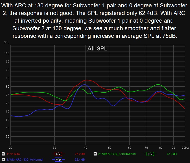

For those with 2 subwoofers and placed one in front and one at the rear, I assume you will make sure one of the subwoofers polarity is inverted. If so, pls make sure to use the REW to check your response curve as ARC:G will not invert the polarity for you. You will have to do it in the Anthem’s Web UI. If your REW response curve didn’t look so good, do the polarity trick I have mentioned in a few post up.

Yes, I didn’t use much miniDSP functions, in the very beginning, I tried 1) level align dual subs; 2) phase align dual subs; 3) create house curve with EQ through REW/miniDSP (later let me see whether I can find the graphs and share), then I use ARC Genesis beta v1.6.4 to calibrate. And then I read a lot on ARC and decided to try the simplest way - skip step 3), completely go without any EQ by miniDSP, and I’m happy with the results. I know in my almost square HT room, two subs are not sufficient to provide flat/even sub response across all seats (the most efficient way is either go for DBA/SBA, or multi-subs, ideally 4 subs in a good shape room with some acoustic treatment), so I’m not very particular on the flat curve, instead, I play demo clips to conclude whether the end results are satisfactory, not based on curves alone. But I still keep miniDSP as I use BEQ for almost all movies (unless BEQ is not readily available).
