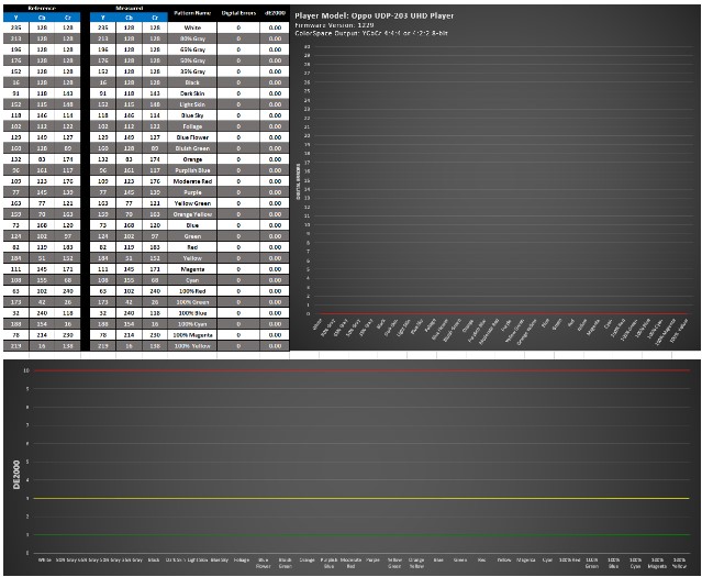

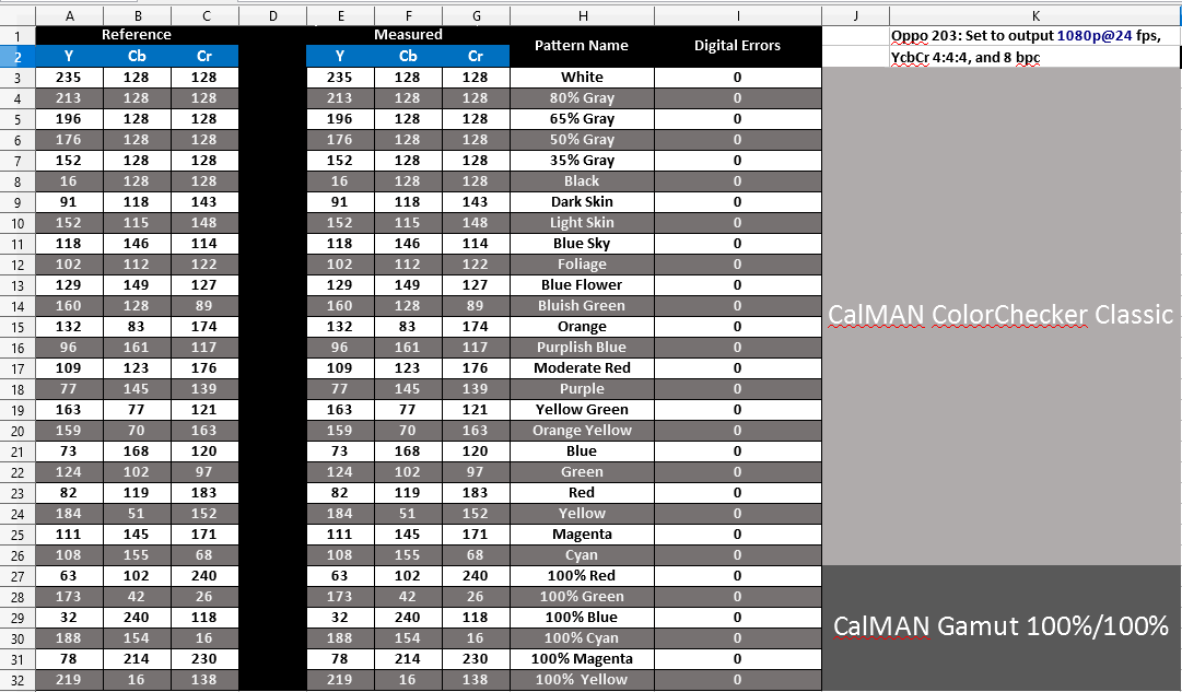

Also, this is what i have advised. which is to slot the USB Patterns into the Oppo 205 to Auto calibrate the LG and not the USB slots on the LG. The oppo then sends a bit perfect yCbCr signal for Calman Autocal
The Oppo as Pattern Generator is Bit Perfect, that is why we dont use the USB slots on the LG. & there is absolutely no need to spend money for another external pGen
We want to calibrate the whole video chain, with the oppo in the chain, which is what i have said above. See below
The patterns from LG is accurate. the Oppo is being used here as the pattern generator, and when set to YcBcR 4:4:4 or 4:2:0 is sending a bit perfect patch

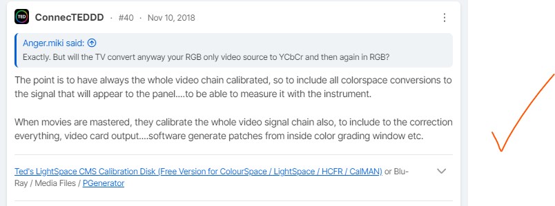

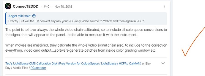

the above is exactly what i have advised, we want to calibrate the whole video signal chain, in cinlude the correction, everything, video card output… Thats what i thought was the correct method for calibration… which is also confirmed by Light space above

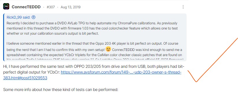

thats not the case, the Patterns are loaded on the Oppo vide its USB ports and played back for SDR and HDR to trigger the projector into the correct mode. These files carry the signal to the projector either in RGB or YCBCR, depending on what you set on the oppo under the video page. When watching movies, you do the same, you slot in movies onto a hard disk and you play your movies from there, it sends a YCBCR signal to the Projector. The signal that goes through the entire chain, has different bit depth with different players. I have been calibrating it this way for a number of years using the oppo, thats why i was shocked when you mention the patterns were not bit perfect. As i read up the thread you share, claiming Light Space told you , what i am reading is different from what you have described. Thats why i took a screen shot of what he said vs what you have said. They are entirely 2 different aspects. He is talking about Certain source players not being able to put out the correct bit depth for patch patterns. (ie when sending a full / Limited RGB signal, vs sending a YCBCR signal) all the source players are doing it differently with different accuray, that is what he is claiming.
This is why you calibrate with your source in the chain. Like what i have said , same like what Connectedd has mentioned below
You do not use the PJ USB ports to calibrate the display.
I had this same discussion with @Foodie many years ago, when he mentioned to use Chromapure with the laptop to calibrate the screen because of the autocal feature, but i thought it was not correct. The laptop’s video card is not the same as the Oppo RGB signal or Oppo YCBCR signal… The laptop is using the Full RGB 0-255, not YCBCR. There are tons of errors with the Full RGB . The black levels are not correct to begin with. That was my point
