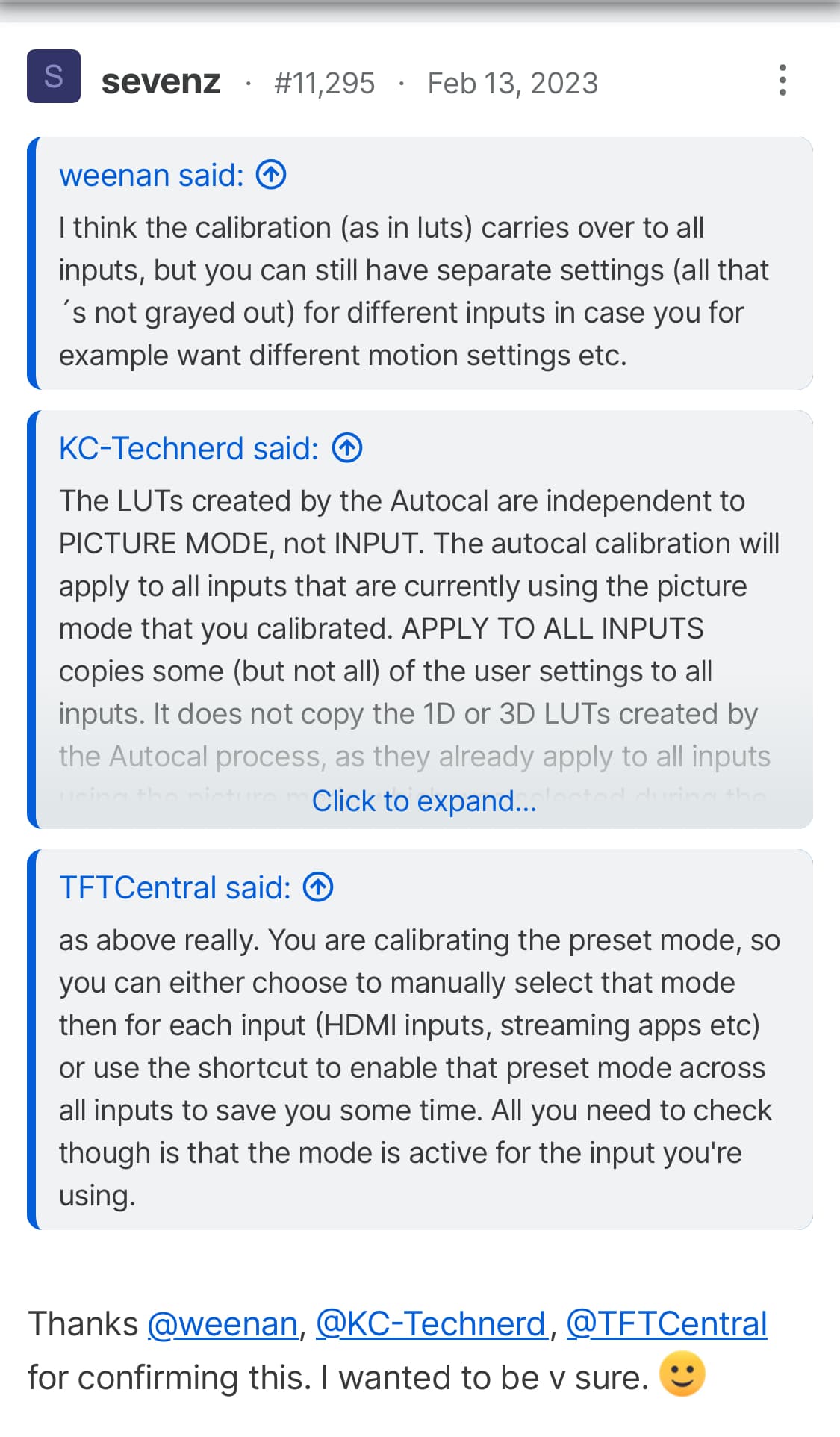

Yes. The different inputs may look different because it doesn’t reset many of the picture processing options for each input. But it definitely wipes out the 3D LUT for all inputs. Autocal loads it back up. So, for me, each picture mode can have a different 3D LUT, but not each input.
Here is @Foodie asking our very question on AVS Forum and some of the replies he received

Back in March or so of this year, when I was playing with PGenerator, I had the same idea you had that each input for each picture mode could be calibrated independently. However @Foodie corrected me that Autocal applies to all inputs. At the same time I had asked the question on AVS and was told the exact same thing that Foodie told me. I checked on my HU810 and indeed they were right. So, long ago, I confirmed this already… at least with my projector.
