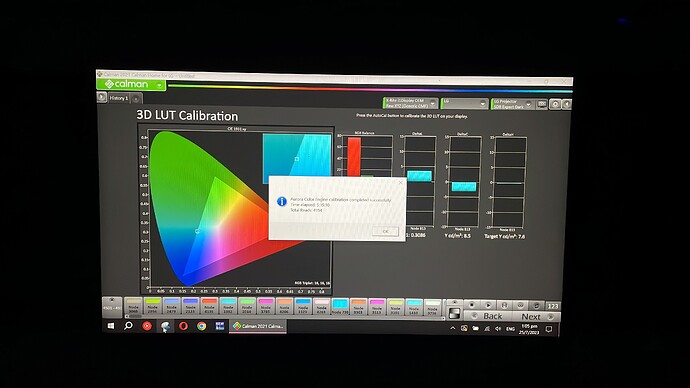

Calibrating the LG AU810PB projector with calman

Oh yes, I must mention the unit that got hung was using wifi. U r right. I never experienced that at home , in my case, even running 17 point grid was perfect, no issues
5 hours plus just for the 3D LUT grid 17, crazy long. But colours look so natural post calibration. The aurora engine’s improvement I’m seeing now is with skin tones. The skin tones look so natural !

When you run Autocal on Calman, 1D and 3D LUTs are uploaded internally, bypassing the factory LUTs for that specific picture mode e.g. Cinema. These newly created LUTs apply to that one specific picture mode across all inputs automatically. So it doesn’t matter if you use the USB input. After Autocal, there is only one 3D LUT for all inputs including all the HDMI inputs. However, each input has separate specific picture processing, such as dynamic contrast, iris etc. So they will look different unless you make all the picture processing settings the same.
I initially thought each input had a separate 3D LUT because I was coming from BenQ, where you could have a different calibration for each input. I was corrected by @Foodie who has been autocalibrating his LG OLED with Calman for some time. I checked and he was right. When I did an Autocal, it was applied across all inputs. If you observe any differences, its not from a different calibration, but from different picture processing settings that are still unique to each input.

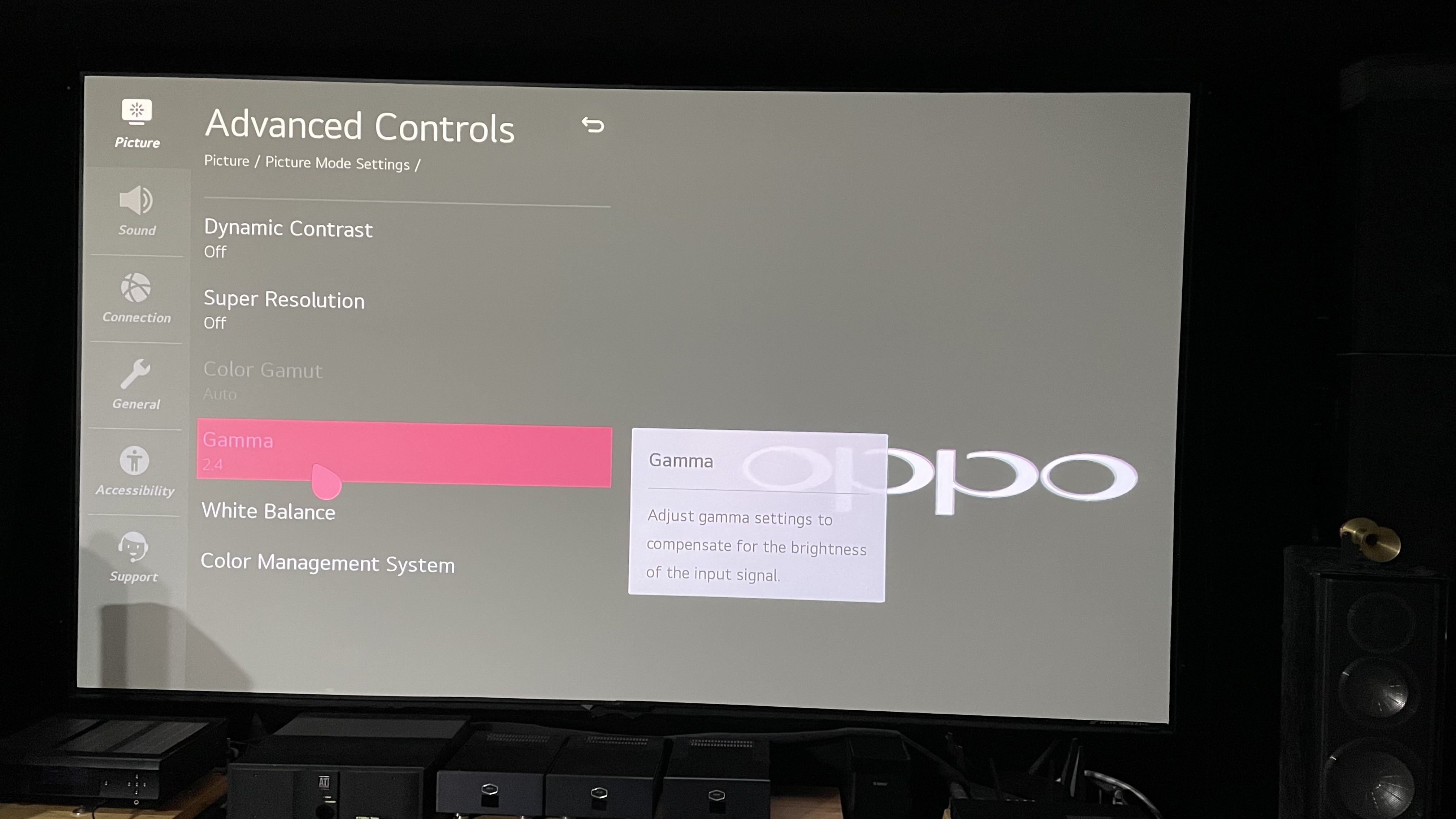

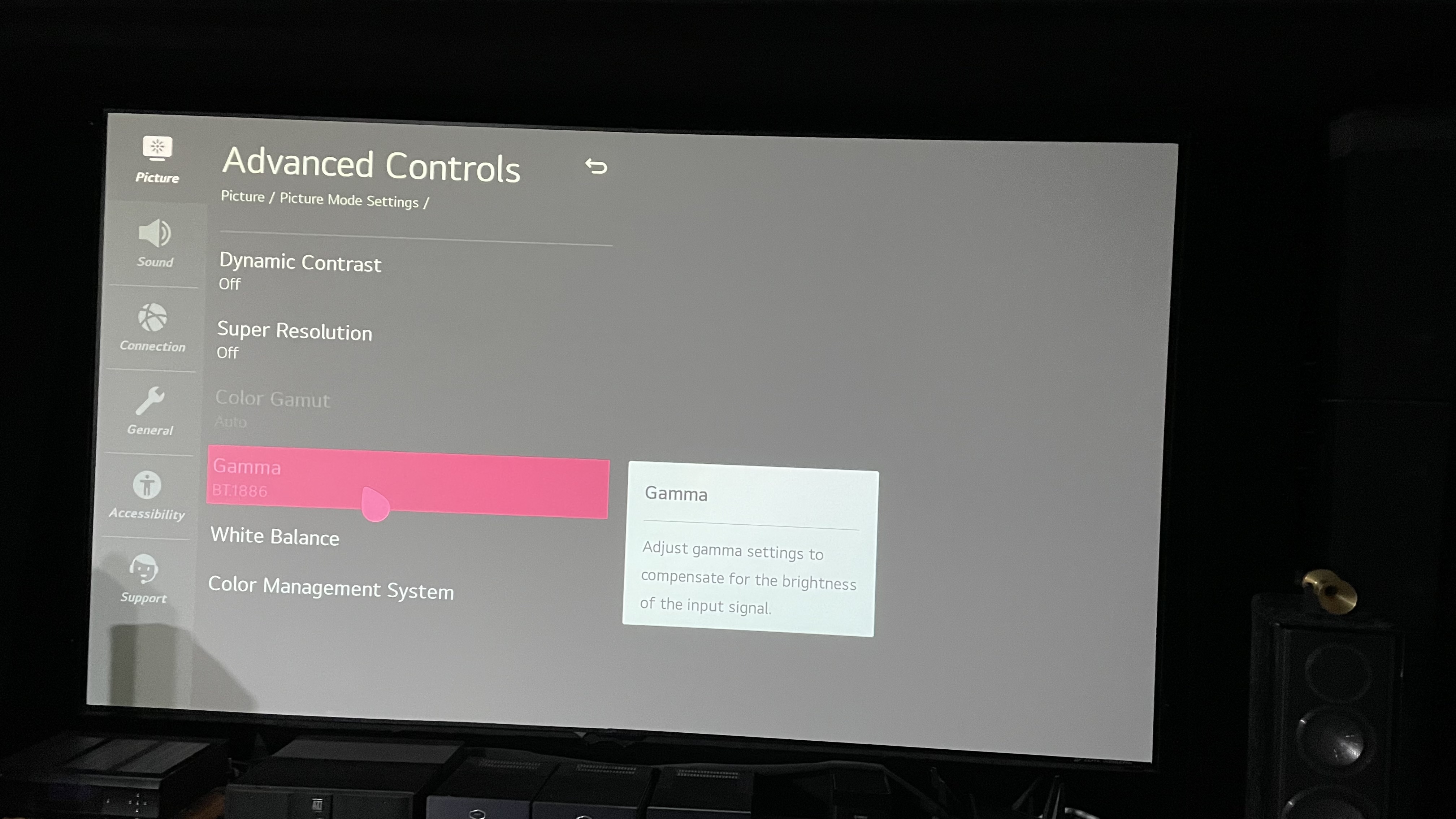

That is not the case. I’m observing it to be different. Based on what I’m seeing, the inputs are not the same. It “Does not” automatically upload the LUT to all the inputs. That is not true.
The above is the calibrated expert dark on input 2. It is using power gamma 2.4 calibrated with iris 0
Above is previously calibrated expert dark with gamma BT1886 using hdmi 3. They are greyed out and u cannot change this . It has been locked down for that input. Observe this one has the greenish tone to it because it was calibrated with iris 8.
So it is not correct that u calibrate through the usb port on the Pj and it automatically applies to all input. This is not correct
Even if u try and apply it to all inputs, it doesn’t, because it is locked down for that particular input only .

Yes it is exactly the same picture mode, expert dark. U can even observe one has more greenish tint to it… that was the old calibrated iris 8 version on input 3, the same expert dark on input 2, is calibrated with iris 0 recently. Nothing is updated automatically. The input 3 is still with old calibrated profile. And u can see one has gamma 2.4 another BT1886. I’m very sure they are not uploaded simultaneously to all the inputs , 100% sure about it …

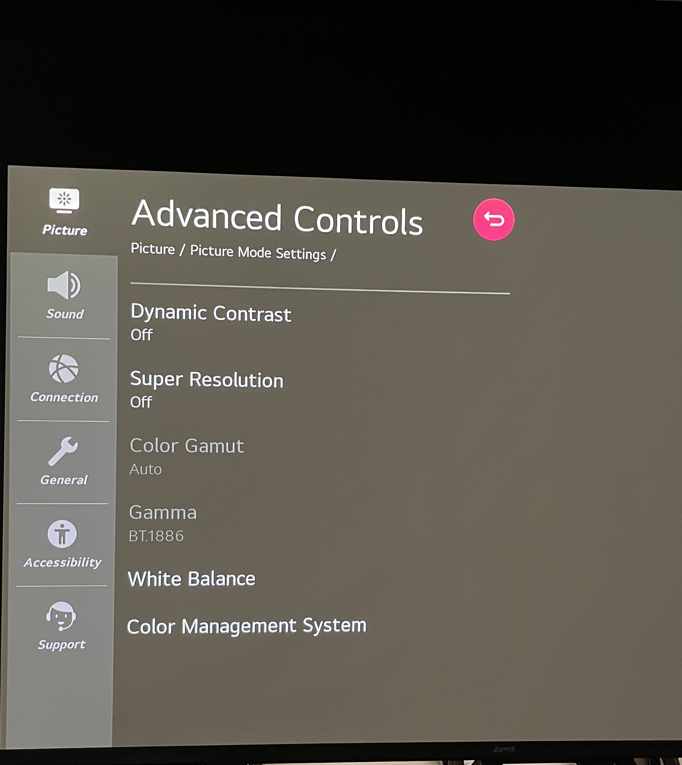

For me, HDMI1, HDMI2 and HDMI3 are exactly the same. Both Color Gamut and Gamma are greyed out. From what I recall, I only calibrated with the USB file running for Expert Dark and Gamma on all inputs were greyed out after I did the calibration. Using the USB file were Tyler Pruitt’s instructions. He even provided a link to download it. It seems that some modes lock Gamma and some don’t. My only possible explanation as to why you are still able to adjust Gamma on one of the inputs is that you have an early firmware. Mine is .37 and I’m using a newer version of Calman.

The reason I know is because I’m using gamma 2.4 on input hdmi 2 and BT1886 for input 3. Very sure the autocal update only does it for that specific input only, not across all the hdmi or usb ports . Even after calibration u apply settings to all input, it will not be updated. It is locked down for that hdmi input only , which is kind of silly from LG. It should apply to all inputs to make life easy for the calibrator

Since Gamma for inputs I never calibrated are greyed out in Expert Dark SDR, it’s not the case for my particular LG HU810. Perhaps it’s different for AU810s? Or the firmware, or the version of Calman. I also recall, when you reset DCC in Calman, it restored all inputs to the factory LUT
