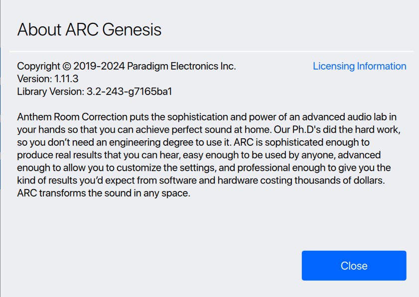

Ok new LCR Speakers stands finally in today and just finished calibration with 1.11.3!
Using 1.11.3 , reset AVP and done up a new calibration.

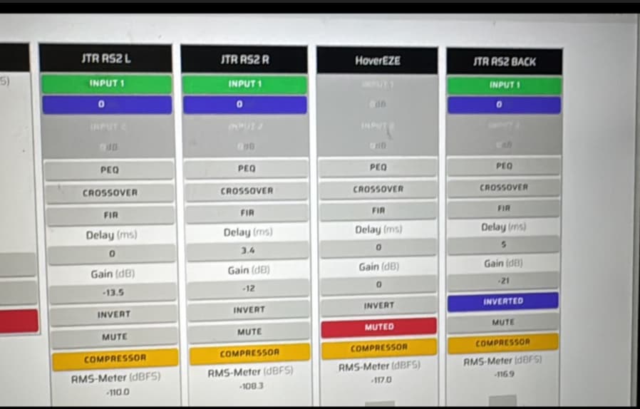

Subs gain are all fix at 12’oclock ( no change)

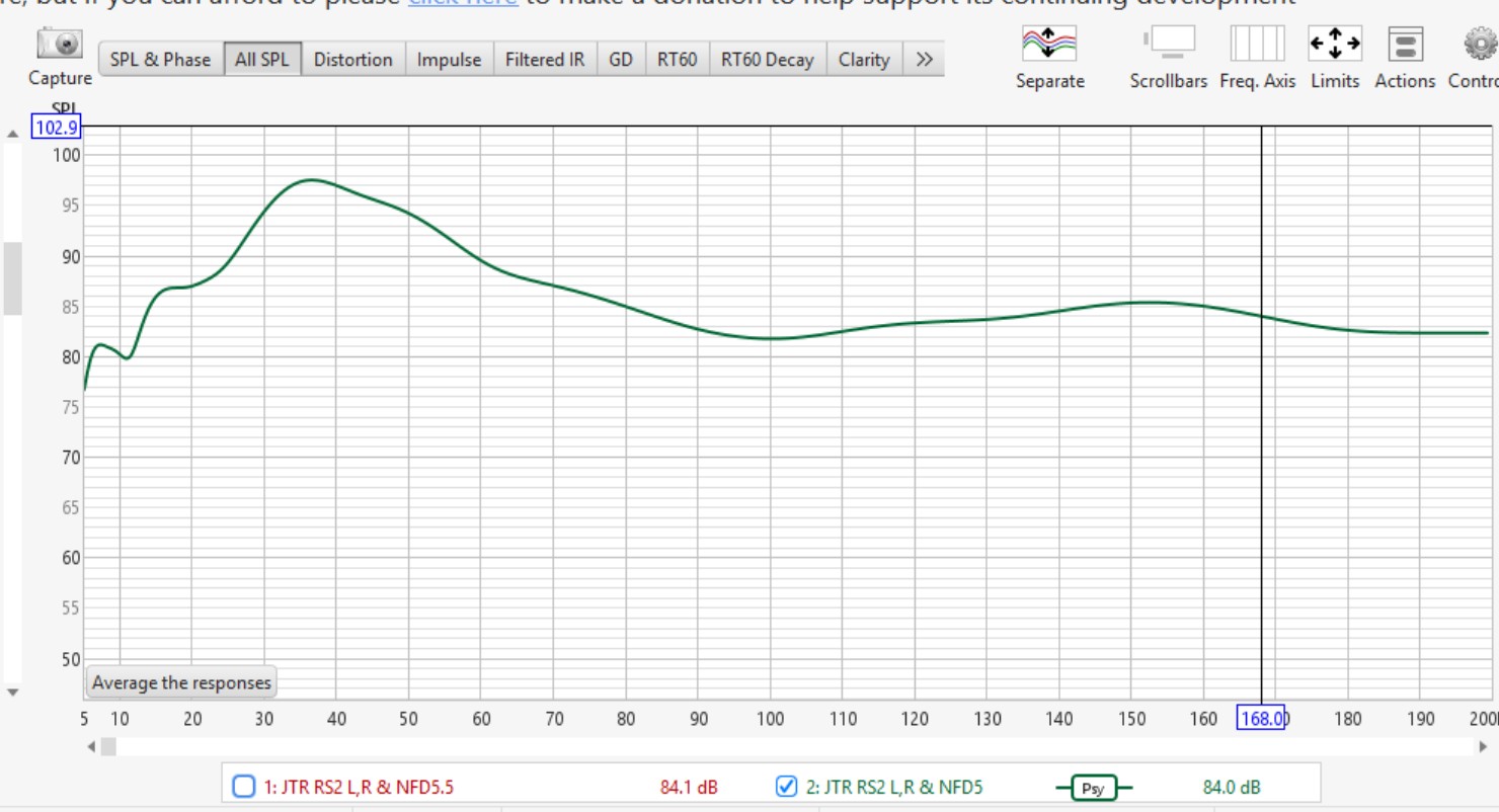

Adjust all the placement , Redone a level match of 3 subs via rew noise/SPL meter.
Time align 3 subs together.
*I did try hearing an added REW EQ house curve last week don’t rely fancy it.

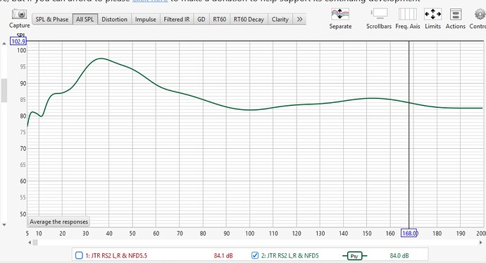

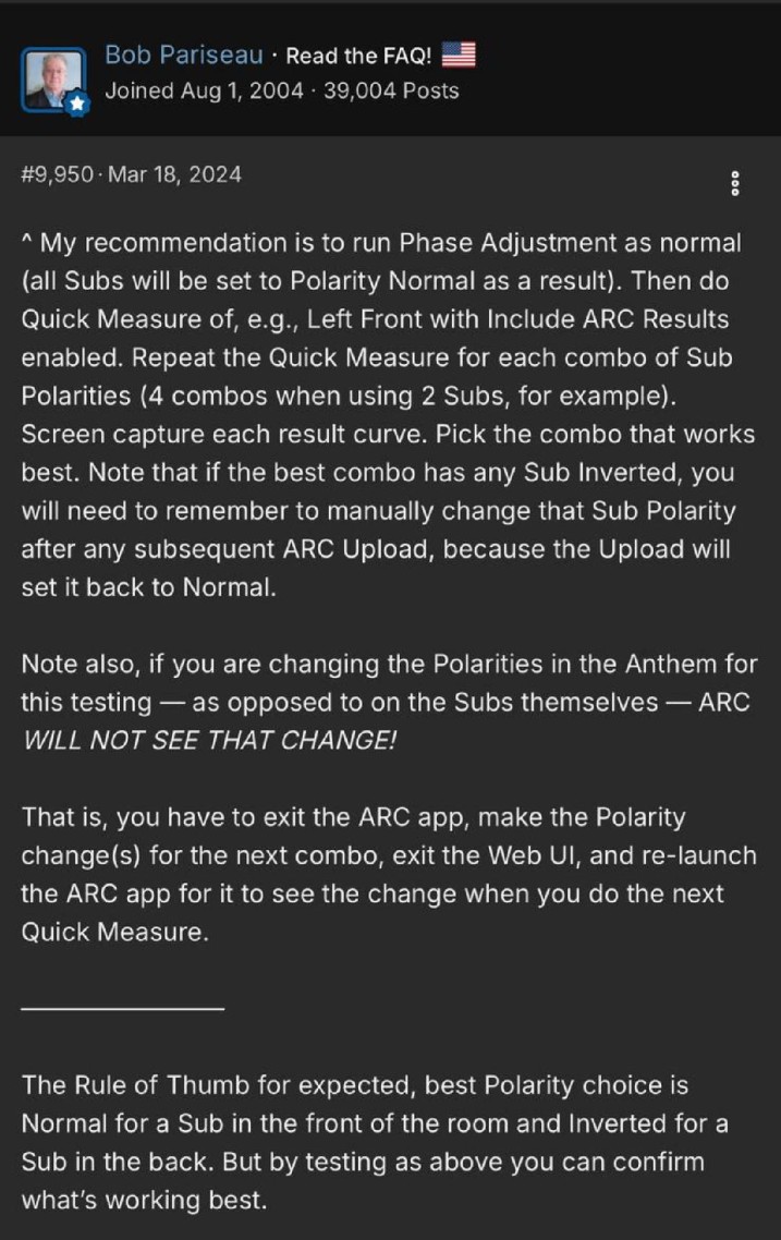

I remember @desray shared about the 180" Phase mode measurement

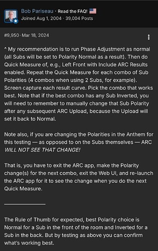

and have also seen this useful article on avsforum - posting here for the benefit of sharing.

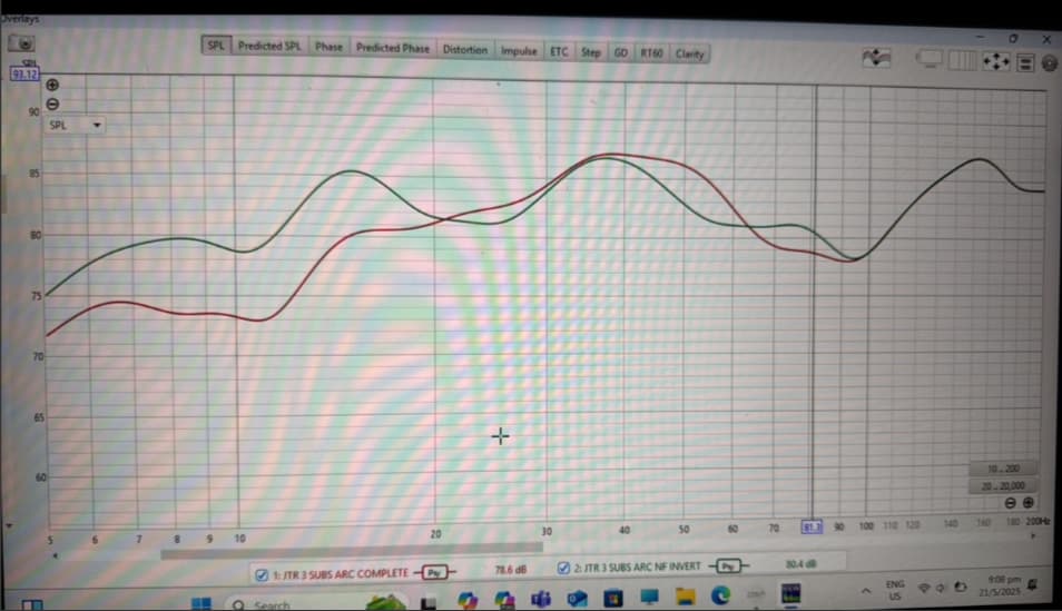

Yesterday night trying to meddle with the phase with 2 subs up front and 1 sub NF back.
Done an inverted Phase on the back NF sub
and can see more output from 5-20hz :slight_smile:
Will try out movie demos tonight. :slight_smile:

Not phase mode…I’m referring to the polarity change.

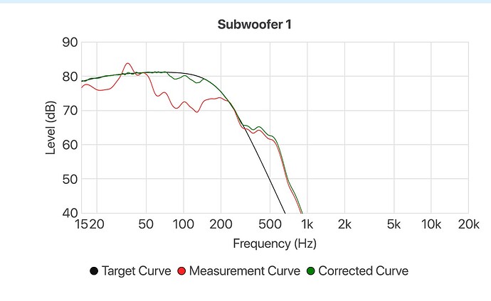

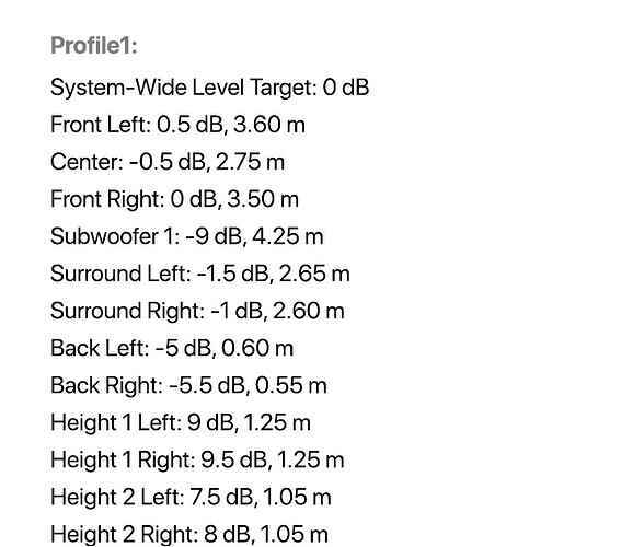

The new ARC seems to have dropped the reference target by 10dB.
Anthem used to be 10dB louder than D&M and other calibration. Meaning - 25dB on Anthem = - 15dB on Audyssey and Dirac etc.
With new updates seems ARC has dropped it to be in line with the rest.. Always wonder why and now curious why they changed it now.
Did anything else change with ARC EQ and logic other than the reference level?
Seems to sound the same to me other than the levels.
@Wechnivag
u r right. not sure why after recalibrated (2nd time) with this new arc, tested with some demos my reference is around -15 to 20mv now ! Some movies sweet spot around
-17 to -19mv for me.

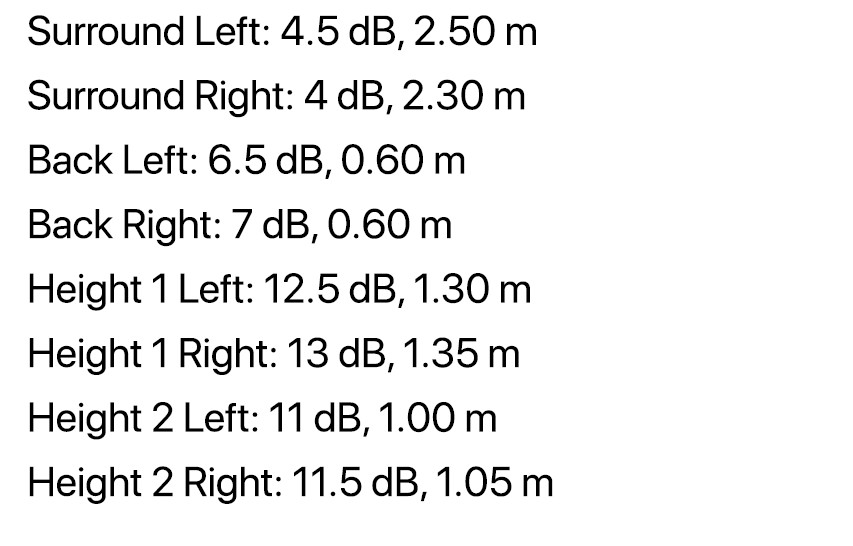

For me, the speakers +db and distance are much balanced after this new ARC EQ.

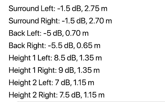

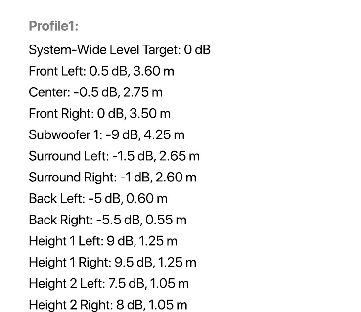

Using same set of speakers for previous and current arc as below.
Previous version ARC Level settings:
New ARC Level settings:

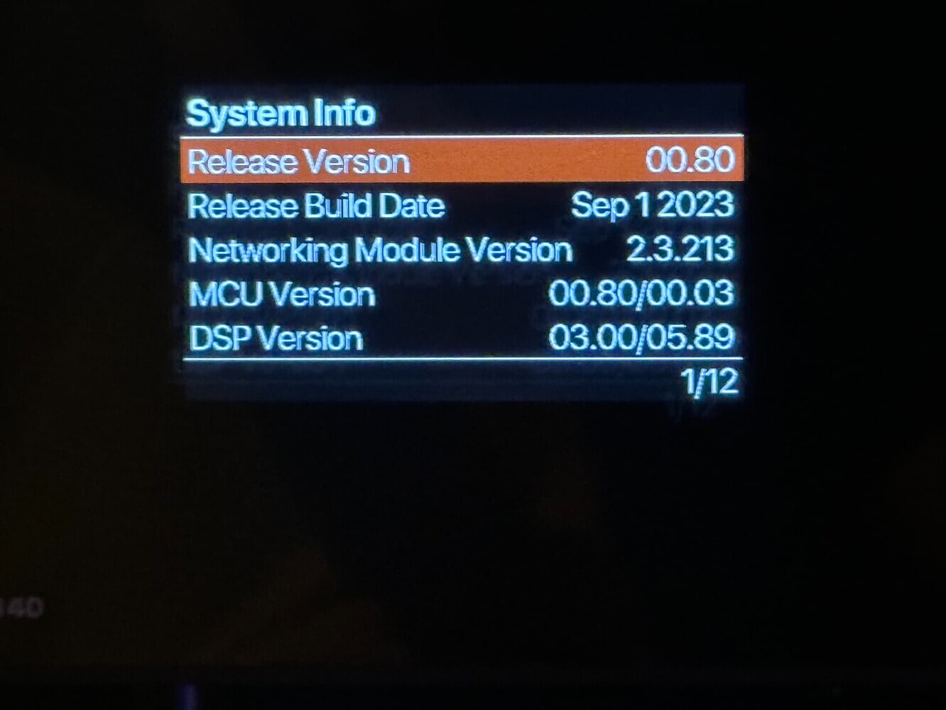

Hi there everyone, just a quick question, for over a year I am looking for a firmware update on my Anthem MRX 540 through the UI online control and through the remote control but no update found. It’s on firmware 2.3.213. Is this the up to date stable version. By the way I don’t do Beta so that’s out of the question.
Many thanks.
That firmware you have posted is referring to the Network module for the AVM/MRX.
I am very confused when you are asking whether this is the latest “stable” version? There is no stable version for network module firmware…if you are referring to the ARC s/w, then the latest version is 1.11.3 which is considered “stable” can be d/l from Anthem’s official download page: ARC: Downloads
So which is which?
Mine is showing the same network module firmware number as yours so I think I am ok now.
Yes basically it’s the network module firmware. What is that by the way. What do the updates do generally speaking.
