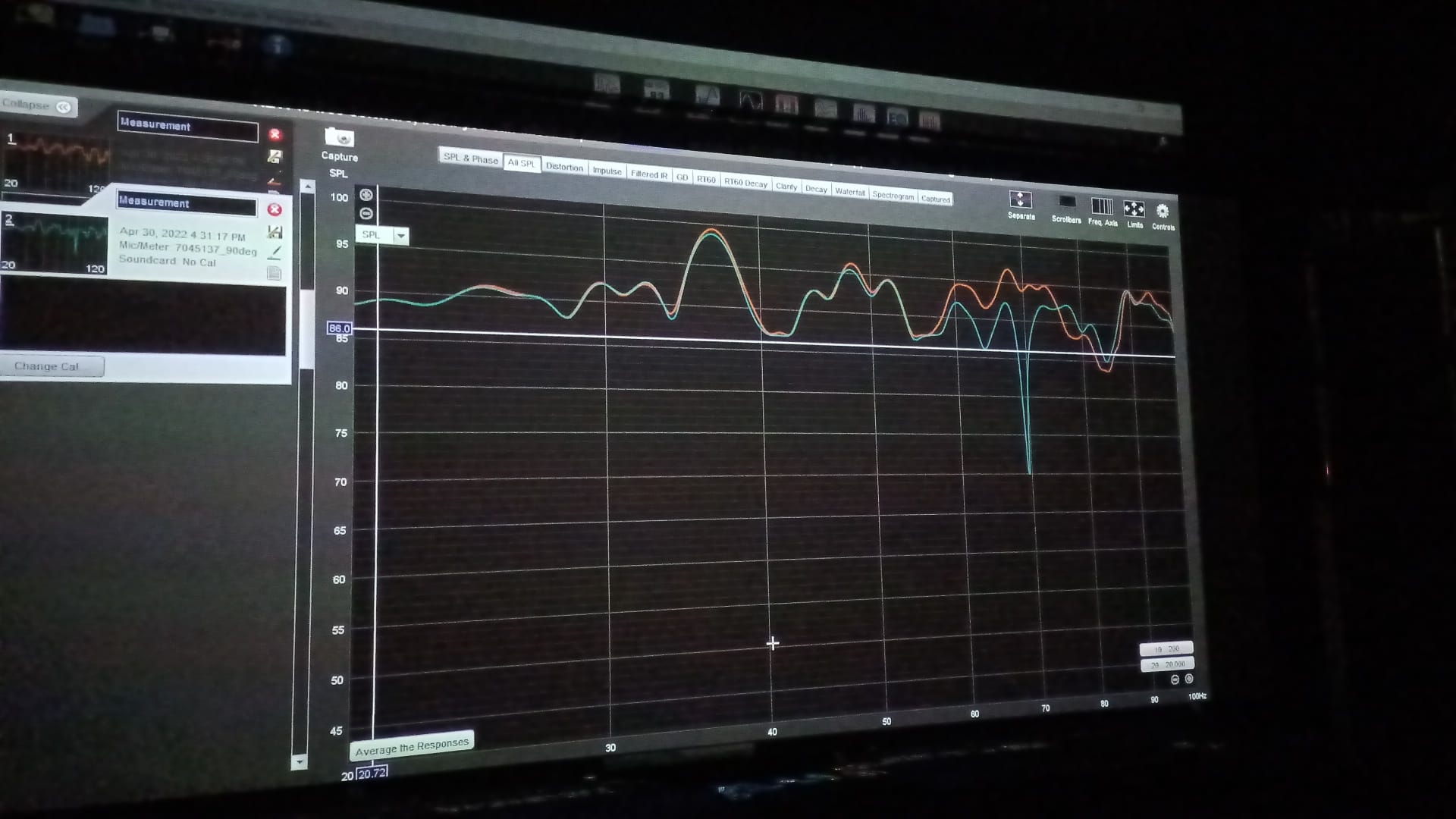

I am very happy to learn many aspects with regards to ARC from u @desray r very experiened ) , ARC quick tips, phase and overall suggestion and method for me to test trial for the next calibration and i can explore and see if i prefer the SQ next.
I share the ARC calibrated settings we demoed as we can have a ab reference last and next.
Just to share the 1st round when the guys came for demo,
Default ARC calibrated settings is as below:
Room Gain +3db
Subwoofer Web UI level : -0.5db
Deep bass boost : 0db
Action added : ( Subwoofer Web UI level : Increase by 4db = +3.5db ) Bass’s better
Jump track to today 30 April 2022
ARC calculated settings- Room Gain : +6db
Subwoofer Web UI level : increase +1db = +4.5db now ( Default is +3.5db)

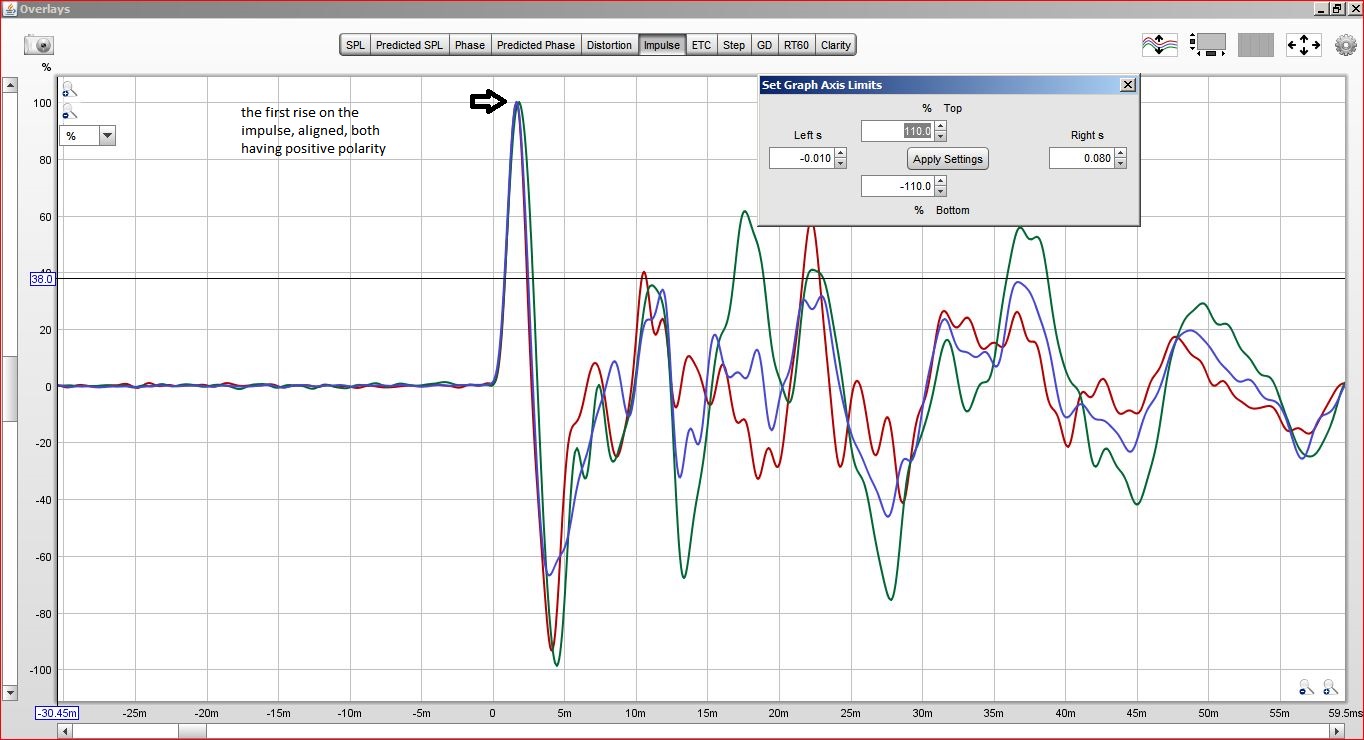

For those who are keen to understand, the impulse rise on Keai’s setup here shows
Both having a positive polarity , and the subwoofers drivers are moving in and out at the exact same time. That means they also stop playing specific frequencies instantly at the same time. This is important as it then doesn’t mask out details in the upper frequencies.( ie if u have one sub impulse moving slightly slower than that other)
We can also see the transient attack is a lot faster, with a steeper rise and fall from the impulse, instead of extended rise and fall that shows it Carries more weight. I suspect Keai is using smaller 12” type of subs
When both the impulses from the dual subs are aligned, they should automatically sum in phase . If however the impulses aligns, but they don’t sum in phase when combined, that means placement of subwoofer is not ideal. It also means the subs are not in a situation of “I help you, you help me”
Ideally, we will want to put both subs in locations where one has a peak and another a dip, that way, they don’t fight over the same frequency.
Good job Keai, having the subs at its ideal location and aligned before ARC, gives the room correction software the “headroom” for computation
But it’s important you verify this aspect post calibration…as with most automated calibration software , it can sometimes get it right, and sometimes not. So post calibration verification is important
