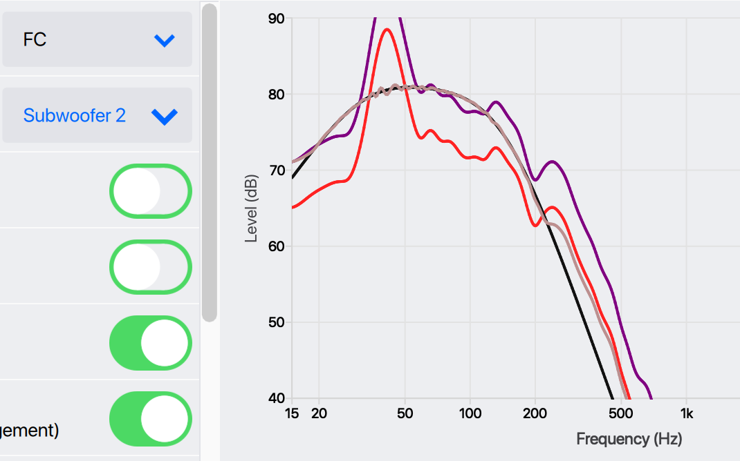

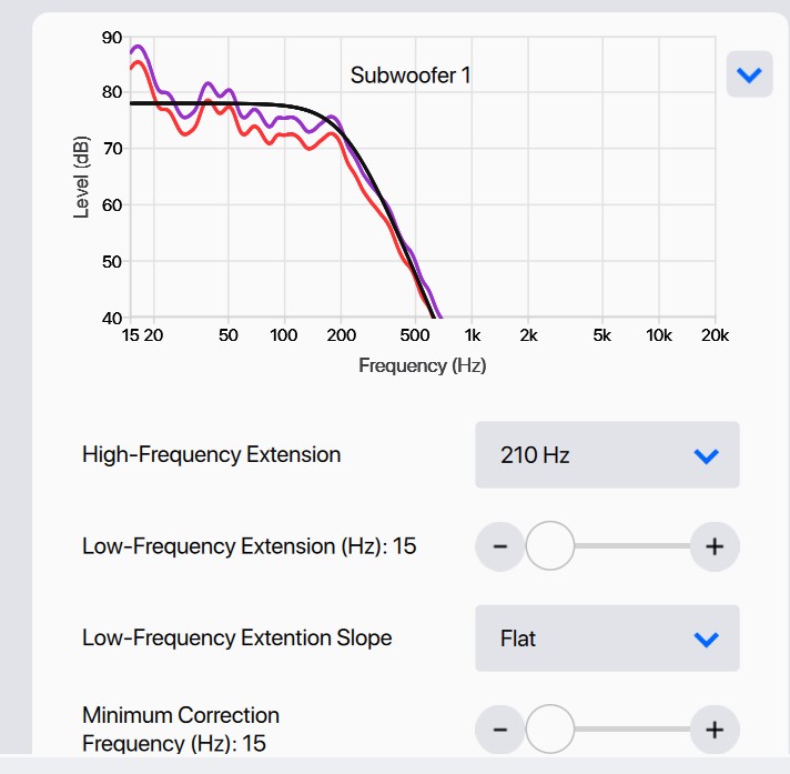

Today trying to meddle with ARC paramters of the Sub curve
Before is before:

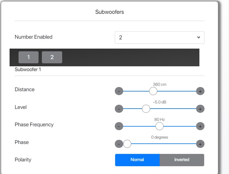

  1. I tried to add deep bass boost of +2db ( overall level curve boosted to 80db range )
  2. Change from minimum correction frequency from 15 to 80hz
  3. remain at after calibration -5db of the sub level ( I trying not to meddle with this level)
Tested some movies since, playing loud and wow balance , punch and it’s not over hanging and boomy.
Almost got it there! The fine tuning here really mattes

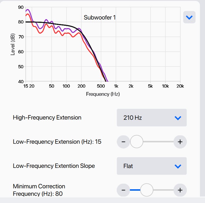

Below is after:
I try not to be too blunt, lol, yes, so so, but in view of the square room, simple setup, I think anthem power is not released…
Thanks for sharing. Very interesting to know why you set the high-frequency extension so high at 210Hz? Is this the original value provided by ARC after calibration or did you change it to 210Hz? I’ve heard some AVS forum members changing the minimum correction frequency to a higher value like you did from 15Hz to 80Hz to get that extra “oomph” from the subwoofers.

Oh yah this is the original value provided by ARC after calibration. Am connecting dual same subs via minidsp Input 1 to RCA Sub out 1.
Did you ever try to lower the high frequency extension to 120hz and retain the minimum correction Fq at 15hz?
oh nope. can test it out. :slight_smile: For subwoofer distance, am not so sure what to input via the web UI. :slight_smile: How about you @desray for your subs distance :slight_smile:

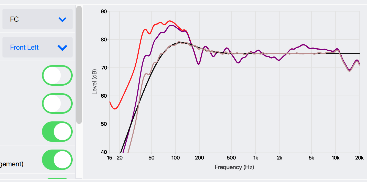

I’ve questions after looking at your settings:

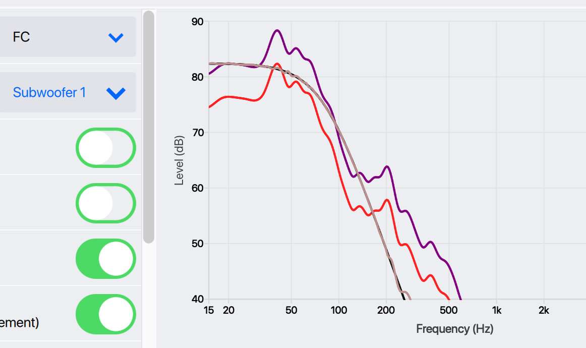

As for the tilt, you chose to start at 2.5kHz however all your spkr correction freq extends up to 2kHz.
From my understanding of how these settings work, essentially the tilt freq is pointless - ie ARC does nothing to the curve beyond 2kHz as evident from the graph plots.

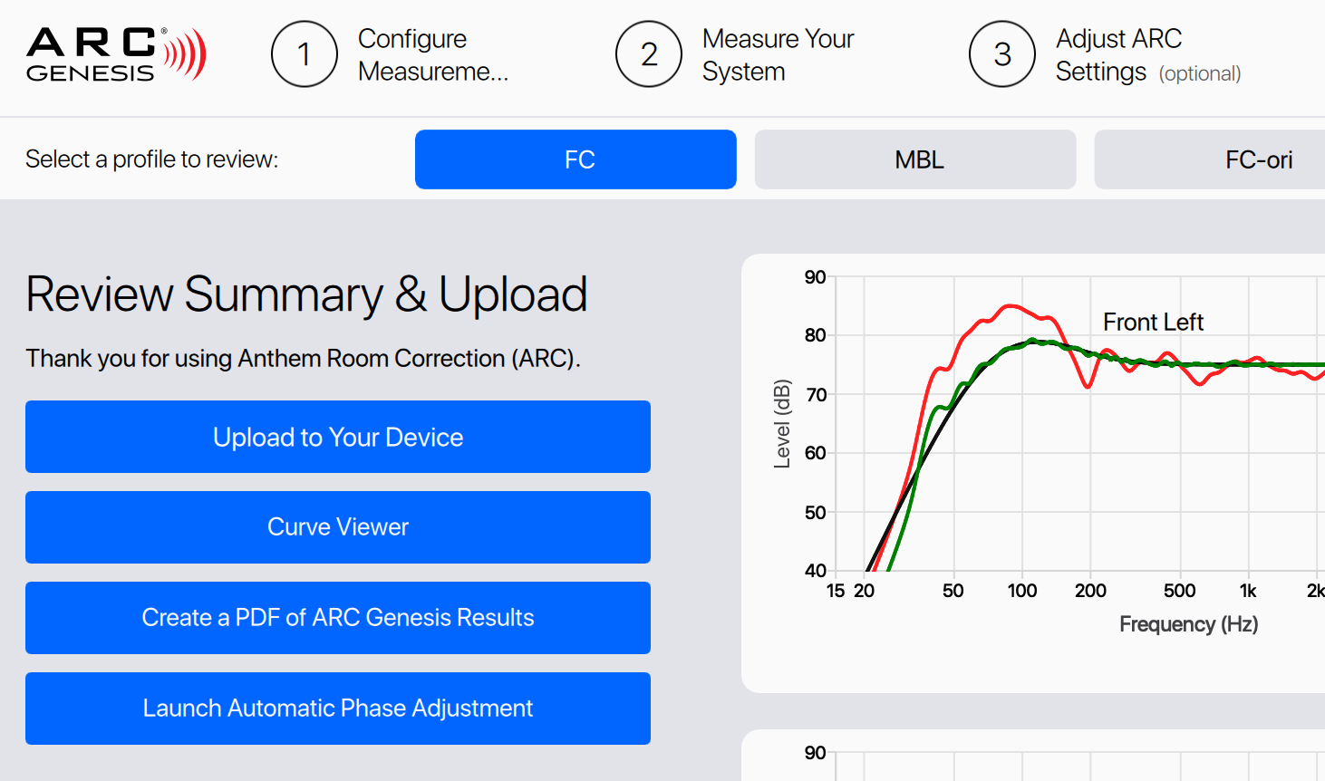

For sharing, my config:
Profiles
FC:
· Fronts
· Center
· Surrounds
· Backs
· Heights 1
· Subwoofer 1 · Subwoofer 2
MBL:
· Fronts
Level Settings
FC:
System-Wide Level Target: 0 dB Front Left: -0.5 dB
Center: 0.5 dB
Front Right: -0.5 dB
Subwoofer 1: -1 dB Subwoofer 2: -1 dB Surround Left: 1.5 dB Surround Right: 2.5 dB Back Left: 2 dB
Back Right: 1.5 dB Height 1 Left: 2 dB Height 1 Right: 0.5 dB
MBL:
System-Wide Level Target: 0 dB Front Left: 4 dB
Front Right: 3.5 dB
Subwoofer 1: -1 dB
Subwoofer 2: -1 dB
Target Settings
FC:
Room Gain: 6 dB
Room Gain Center Frequency: 170 Hz Deep Bass Boost: 1.375 dB
Deep Bass Boost Center Frequency: 50 Hz Tilt Level: 0 dB
Tilt Start Frequency: 100 Hz
MBL:
Room Gain: 3.75 dB
Room Gain Center Frequency: 200 Hz Deep Bass Boost: 0.625 dB
To be frank, I am still experimenting with the tilt setting. I am always constantly changing it to see whether I can hear any improvement. Personally, you can leave it intact if you wish if you don’t hear any difference.
For me, I can hear some distinct differences if I play around with tilt. You need to play with both the tilt starting frequency and the tilt level to “hear” some difference. The goal here is to move the target curve to be in line with speaker’s natural (roll-off) response and let ARC re-calculate. I have previosuly covered this in this thread here *Official Thread* Anthem AVM 70 & 90 and MRX 540, 740 & 1140 - #145 by desray
Can you comment a little on your experience with your current config? Are you satisfied? What is really good and what areas could be better? I noticed your Room Gain is set at very high (6dB)…is your setup in the living room? The need to crank up the room gain is the fact that you feel the LFE is lacking…
Use the same old method as I always do. It’s tedious but gets the job done. That is to use REW and play the sine tone frequency at the crossover set for the Mains. In my case is 80Hz. Previously I have Audyssey read the distance for my 3 subwoofers which have the delay computed for me. So I’ll start off with the distance which I have derived from my Audyssey setting and then use that as a baseline. Next, I will slowly play with the phase control for each pair of subwoofers and I will either add or subtract 3ft from the baseline distance and then take a summation reading with all 3 subwoofers playing at the same time. The goal is to get the response curve of the 3 subwoofers to be as flat as possible. Lastly, to add a house curve, simply add at least 3dB room gain (depending on your room mode as well) and add at least 1dB of bass boost to the modal region to get that extra rumble on your seat tactile feel.

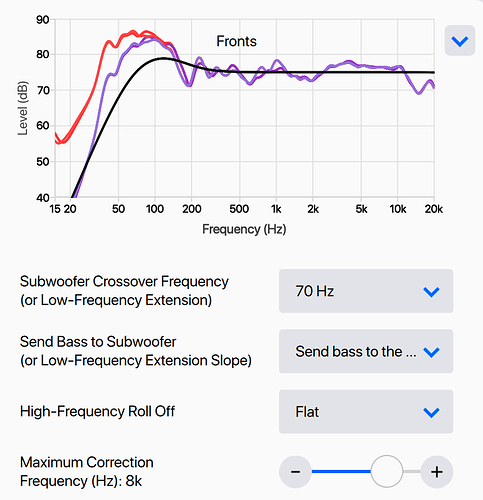

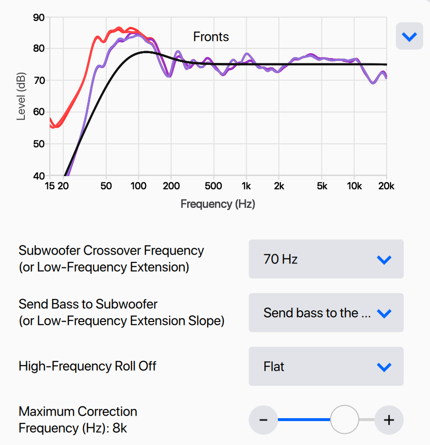

Based on my understanding, you need to include 2 other parameters into consideration.
On my setup, I aim for a flat response, thus I did not put any tilt ie 0, thus the starting freq is irrelevant.
The 2 parameters that I’m talking about is the Max correction freq. and HF roll off.
From above they are set to flat and 8kHz.
The resultant effect from the ARC correction is shown below.
While I chose flat, the correction does nothing beyond 8kHz, thus does not unecessarily push the system beyong 8k and just follow the natural response.
My understanding is that playing with the tilt and level is usually to address the output at the higher freq range. One needs to consider the freq response plot against the target curve. By def the Max Corr Freq is 5k and if the correction is needed beyond this limit, it needs to be raised higher. For example in my FL plot, I raised the limit to 8K to address the spike that extend all the way to 10k.

I noticed your subwoofer 2 SPL drop quite a fair bit from 40Hz and below. I guess the SPL for subwoofer 1 more than make up for it. Did you do a summation of the 2 subwoofers? What’s the combined output level?

Sub2 is actually a combine response for the 2 Focal at the back.
I believe it is due to the positioning, both are against the back wall but abt 1m from the corners.
On the RIGHT side, there’s a structural column and immediately next to it I have my equipments thus the offset.
On the LEFT side, it’s the door entrance swinging inwards, thus I need to leave 1m gap.
As the room is pretty small, the MLP is within 1m from the back wall give or take 6" to 1’ as the chair is a recliner. If you ignore the huge spike at 43Hz, the drop is not too bad. Actually due to the huge spike, the ARC kept complaining about high output during the measurement and I had to turn down the volume significantly to very low ie 3 o’clock or less.
When I’m in the mood, will try to shift the sub around,… maybe swap to the front and bring the single sub to the side… :thinking:
