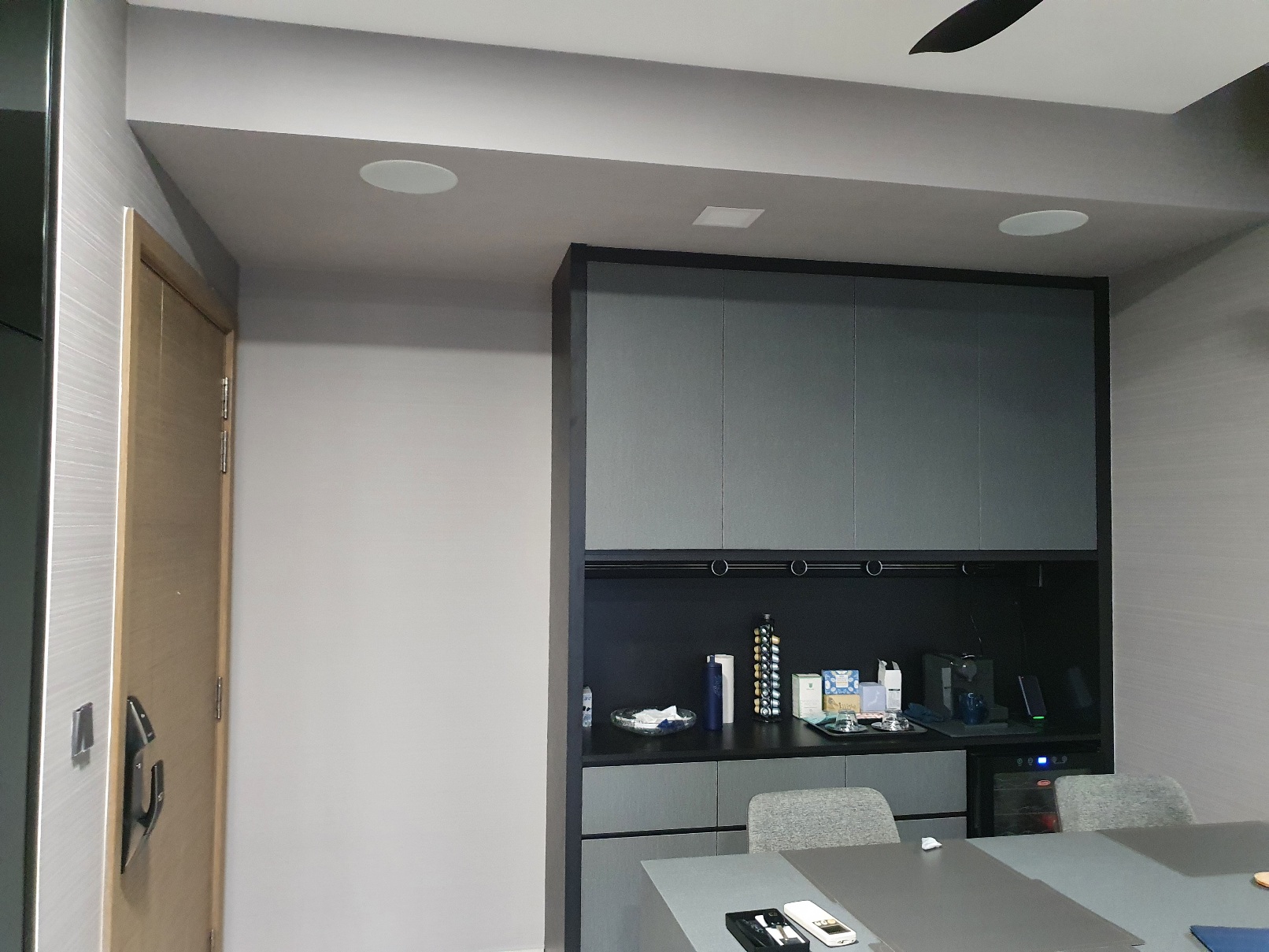

Eventually we decided to renovate our home instead of moving out. So take the opportunity to replace and rebuild.
Add in 2021
Dedicated HT Room
  • Redesign place to include treatment, 80% aesthetics. LOL
  • Bought Legacy Audio Signature SE for LR
  • Bought Legacy Audio Expression for surround
  • Bought Sonance VP86R for Atmos.
  • motorised curtains and Hue lightings.
Living Room
  • In wall Sonance VP66 series for LCR, Surrounds and atmos
  • Yamaha A-4A
Dining and Bedroom
  • Sonance VP62 in ceilings
  • Yamaha RN303
Photos spam coming
Here it is
