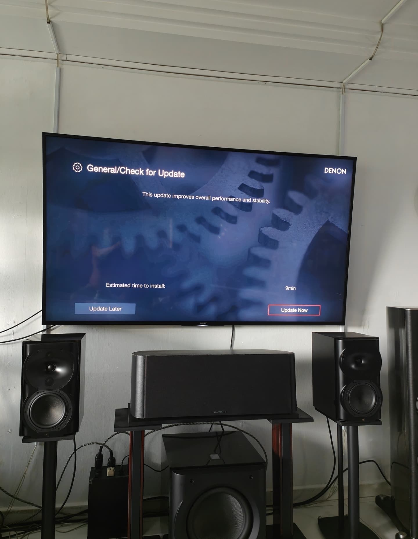

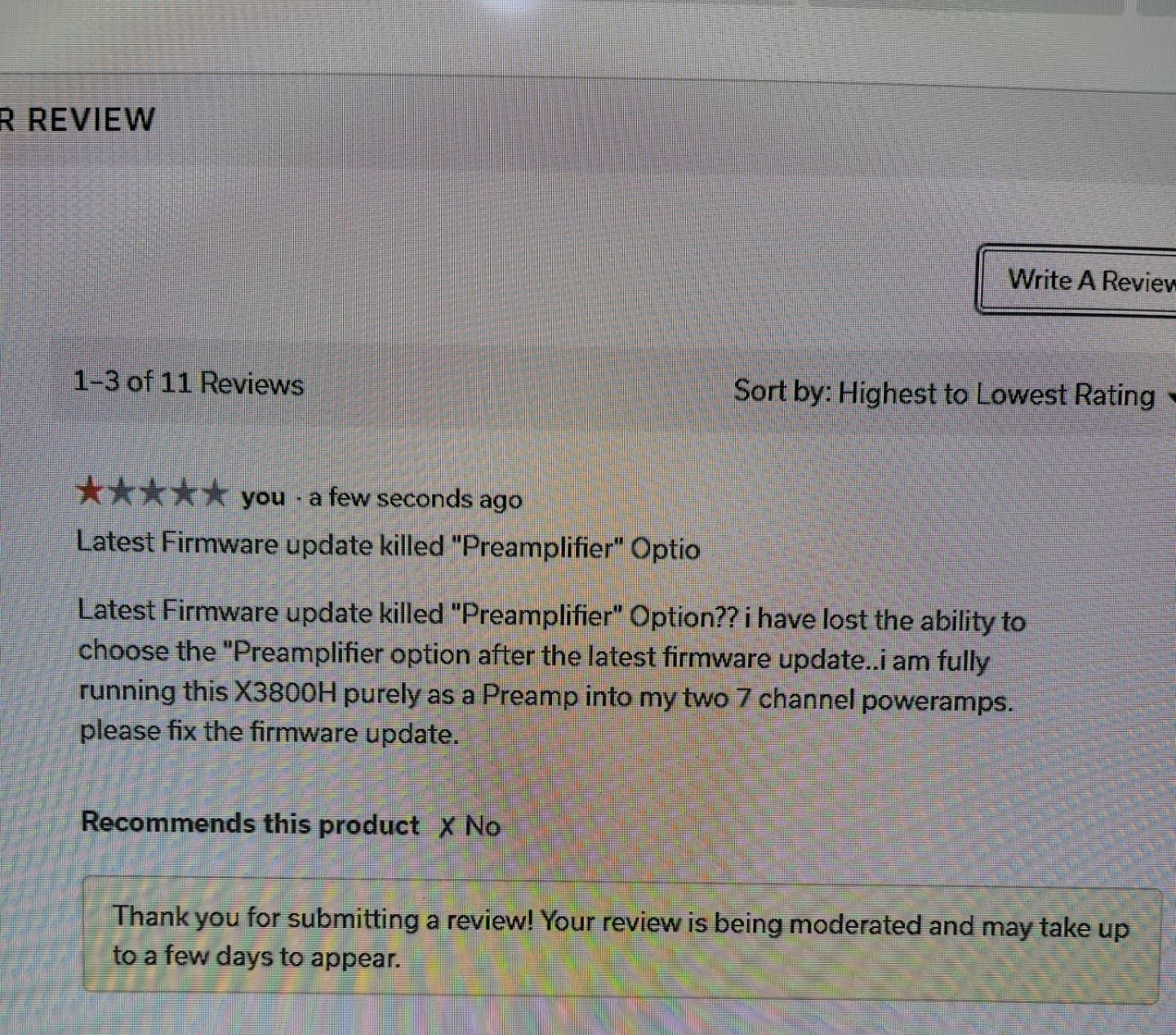

i strongly believe that the “Latest Firmware Update for the Denon X3800H” has killed or removed the “Preamplifier” option/mode…
Damnit!!!

Just let go a review in Denon USA Website…
;D ;D ;D ;D ;D

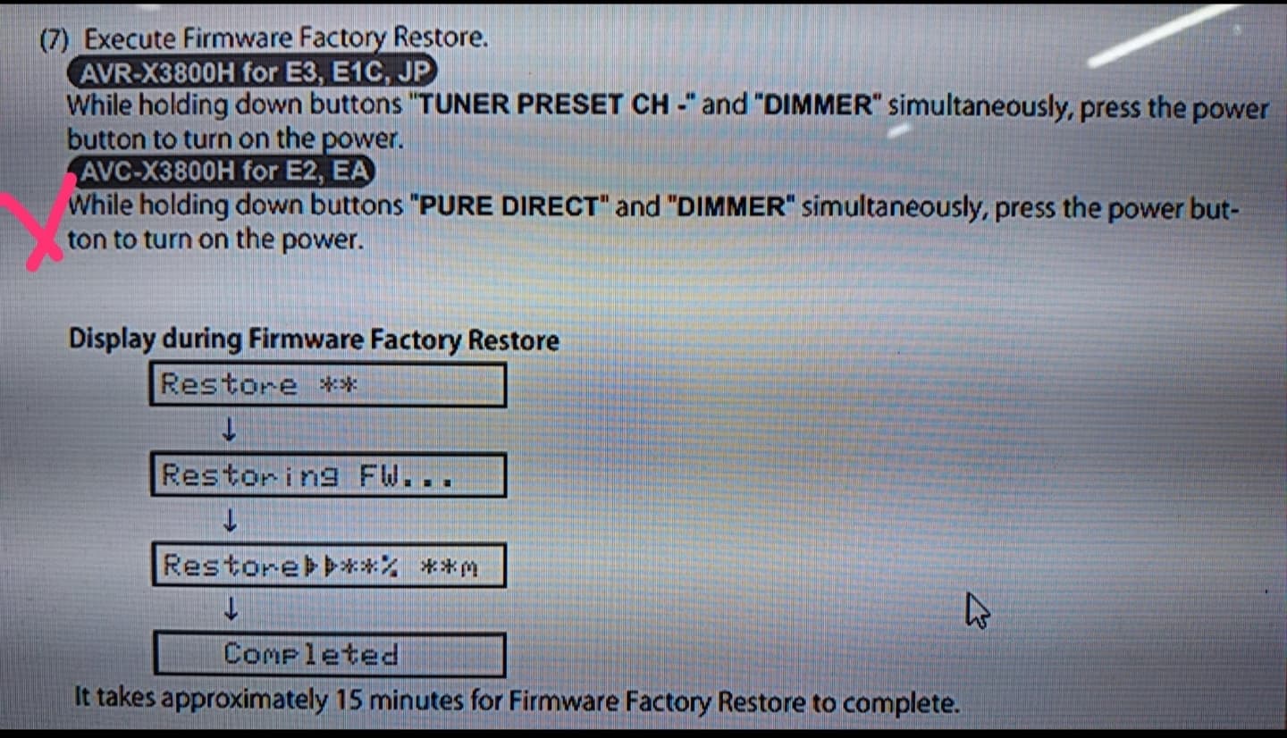

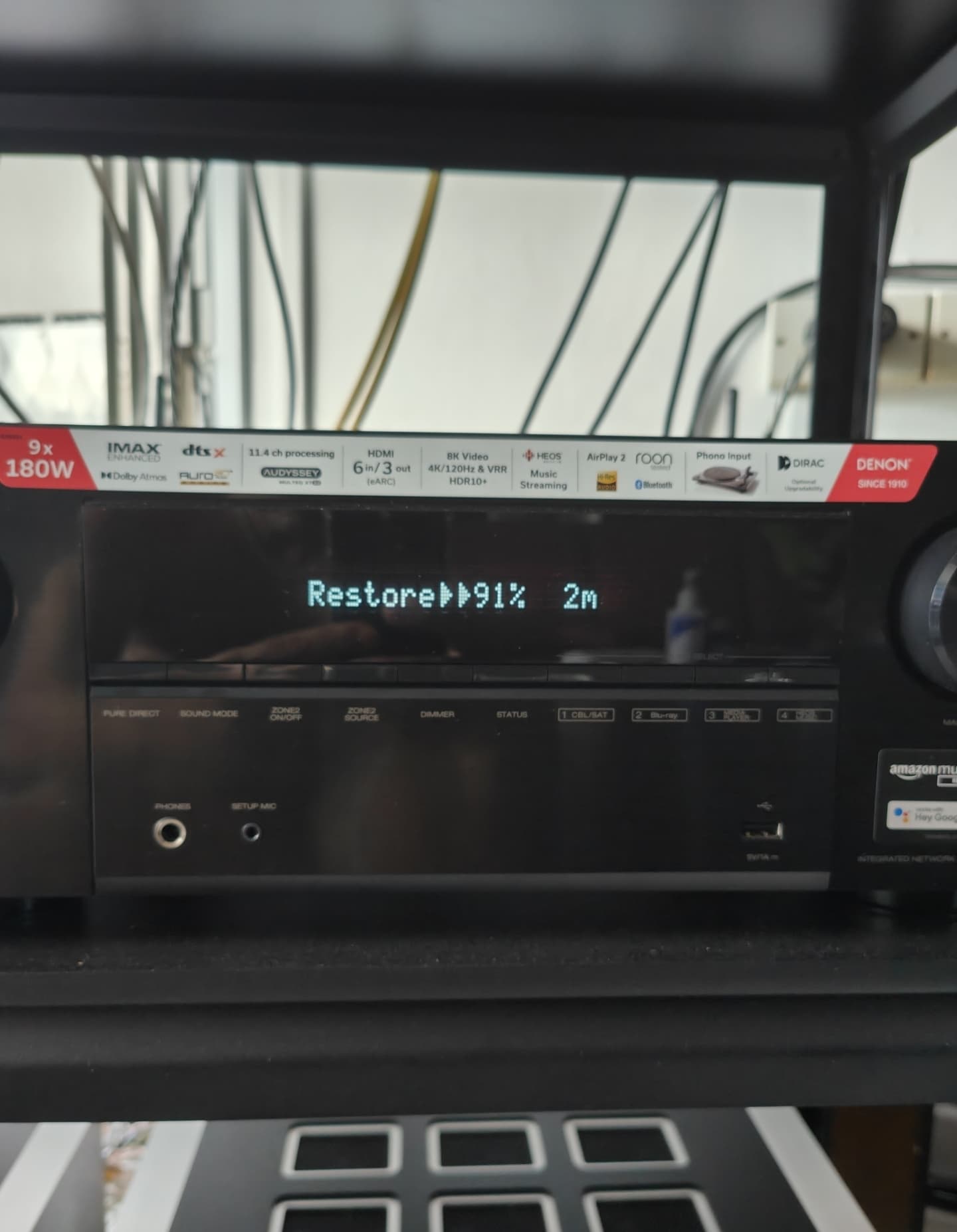

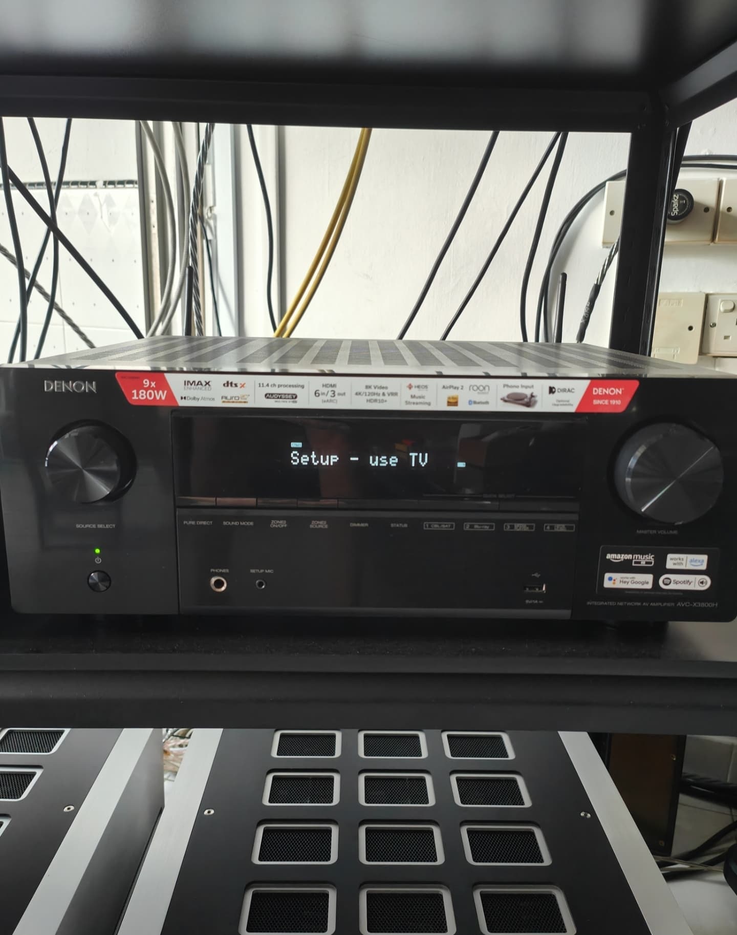

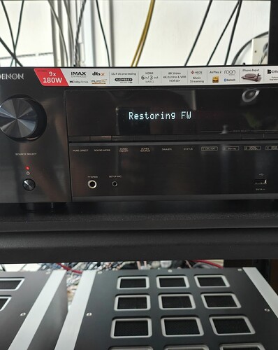

At last Denon SG Replied n Sorted out the problem for my X3800H…
They told me to do a “Firmware Restore”
Steps are in the picture below…
N yes, looks like if u have updated your firmware to the latest update, u will lose the ability to set the AVR to “Full Preamplifier Out”
Looks like I confirmed the bug to Denon… as they told me “Don’t update just yet”

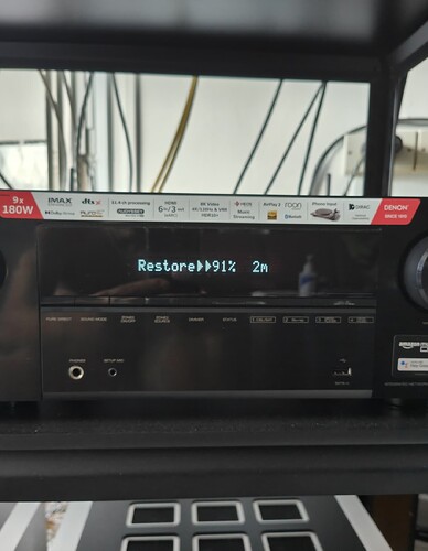

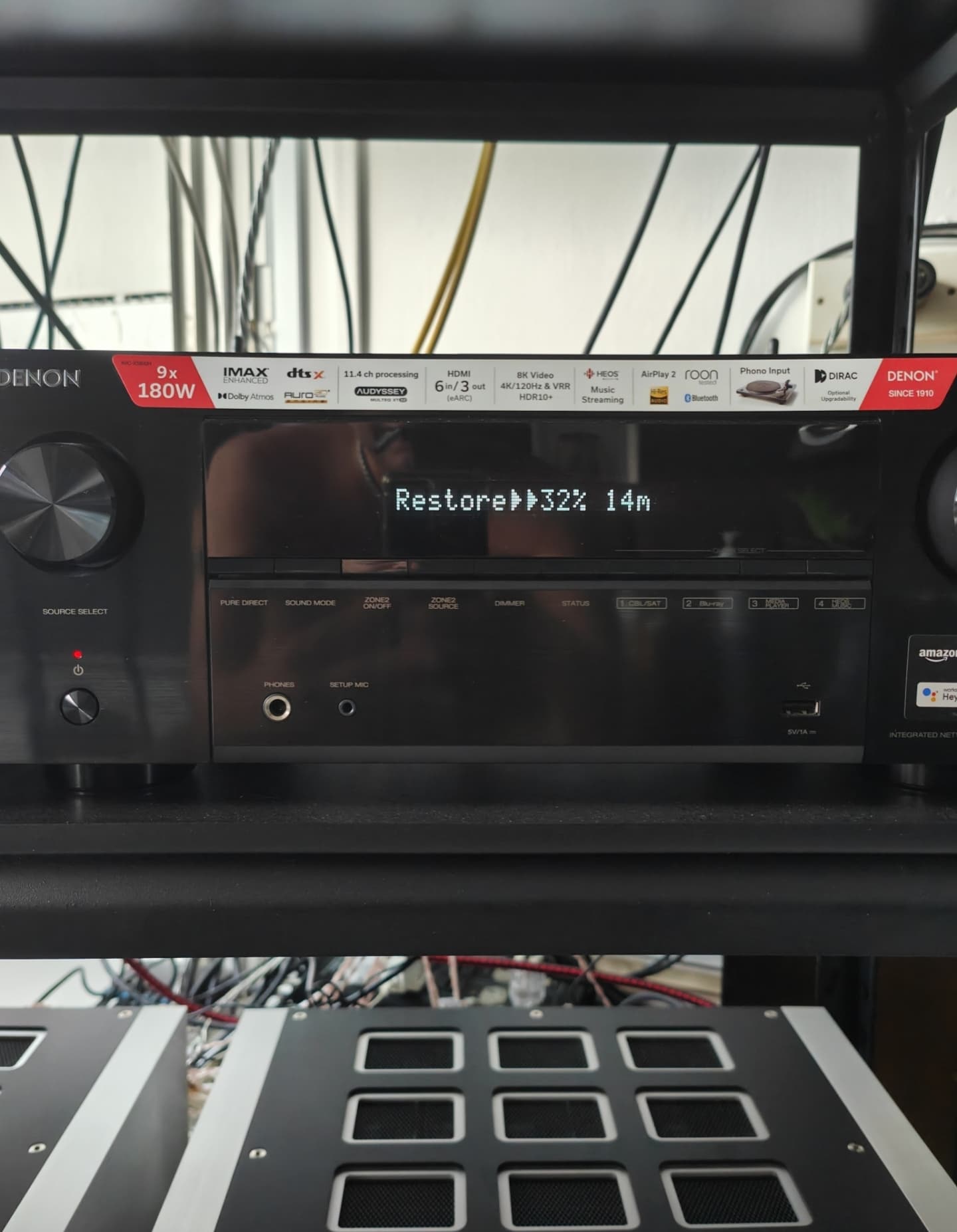

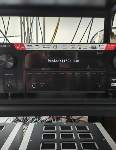

So now my X3800H is back to the “Initial Factory Firmware out of the Factory”
It took a total of 7-8mins in all to do…

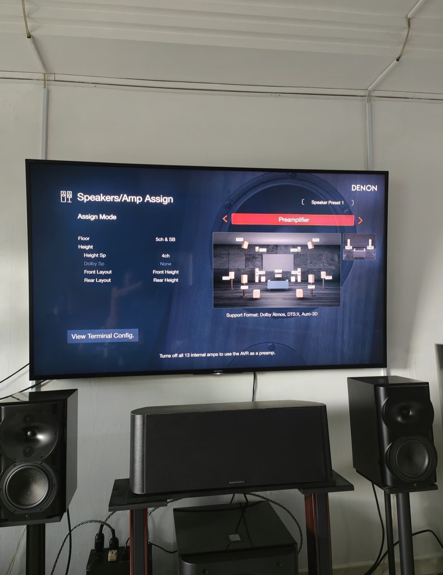

Now I can see n choose the option of “Preamplifier”
In “Amp Assign”
But Denon told me not to Update my set just yet…
