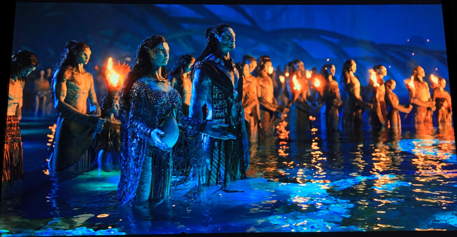

Ya that’s why the hdr-x version is so addictive. I can also see the difference on the OLED screen HDRx vs the normal HDR10 version from the studios
Somehow we tend to have preferences for these type of colour depth, they look so much more appealing to the eyes
I also noticed the red on the hdr-x version is always different, it has so much more depth in the reds…
But it’s good we all have a clue on what the reference looks like with the pictures from 20th century studios… at least we are on the right track and able to discern the difference between reference vs preference…
If the avatar turns out like the above :point_up_2:t2:, then you will need serious help with getting the colours to look decent on the display……
See how important it is for the display to be calibrated, without any calibration, this movie will reveal a lot of flaws…

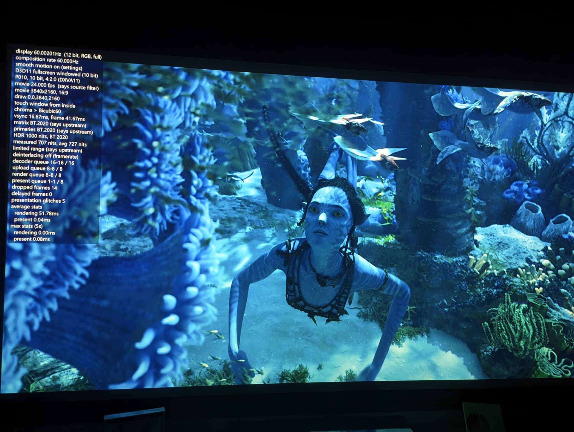

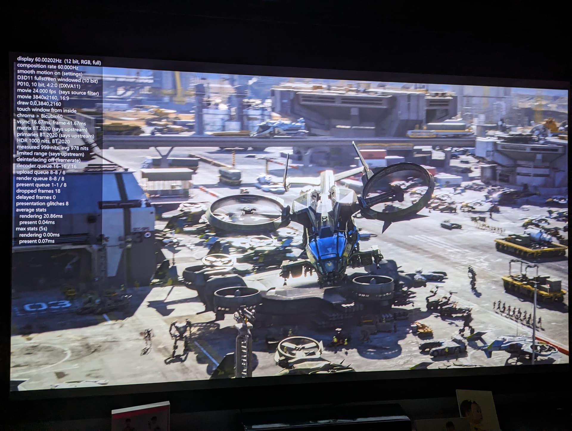

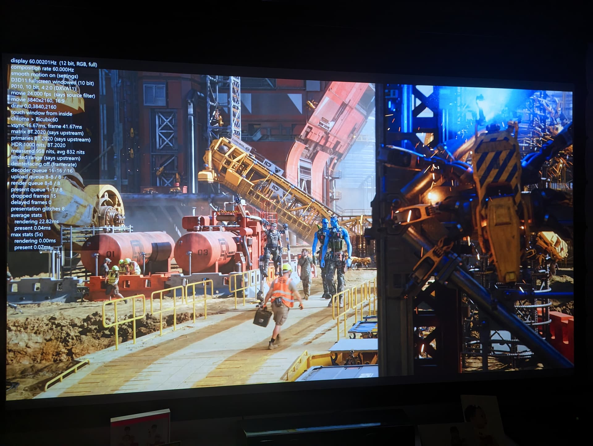

Here is my result

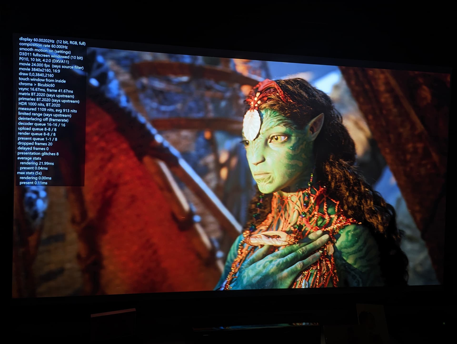

Looks great. Another MadVR with LG HU810
I would say our BT2020 color calibrations are darn near identical. MadVR seems to be lifting more shadows in yours

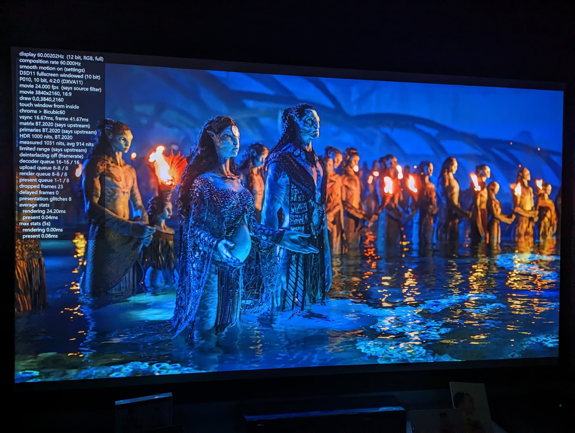

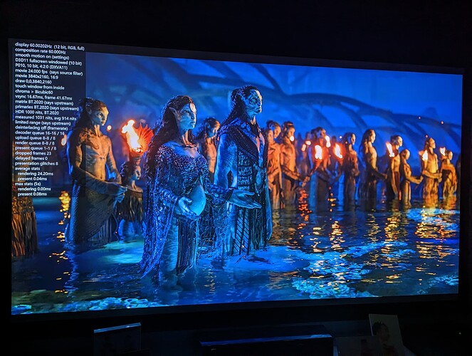

abhuj887 :point_down:
Sammy :point_down:
I like yours better

It’s an iris of 3 and calibrated at that. Not sure if it makes a difference
what’s is your measured leak luminance and the nits setting in madVR?

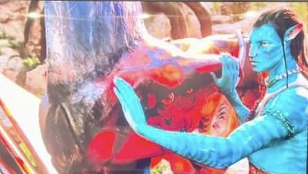

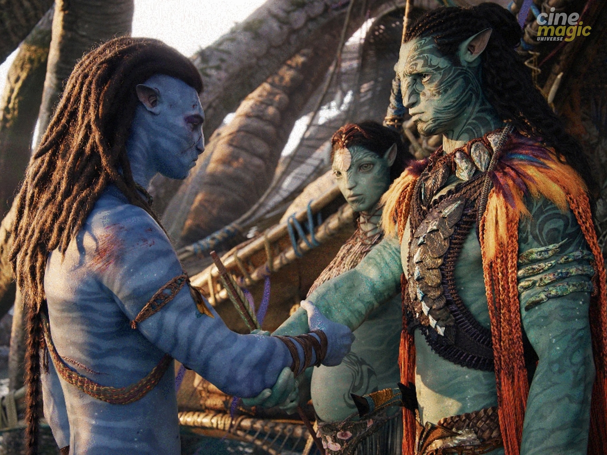

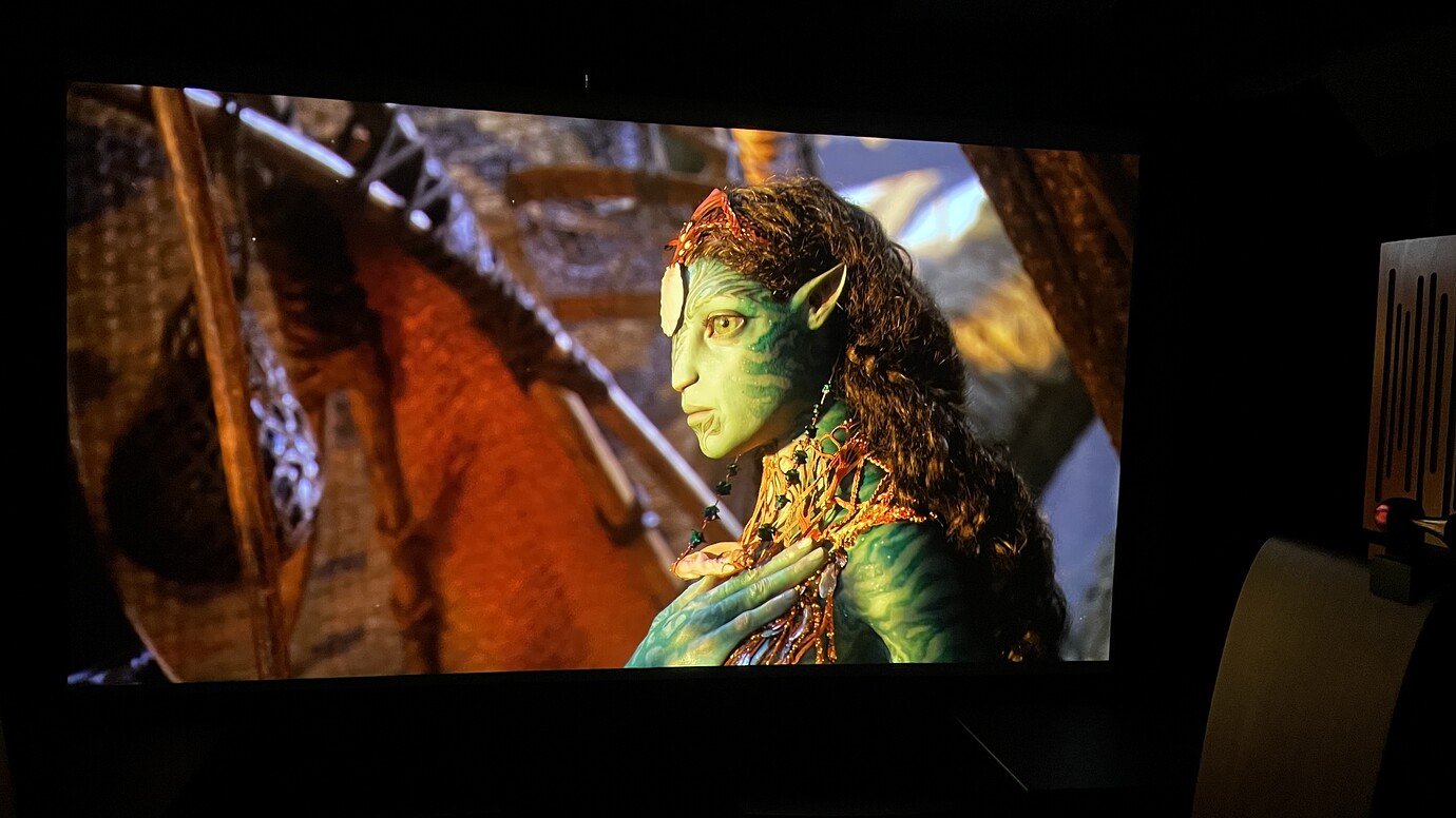

Now that we know the Century reference is in SDR (likely SDR with a BT2020 colorspace), the skin color of the water tribe has vastly different tones. It leads me to think that since both are using BT2020 colorspace, what’s causing such a big color tone shift? Just look at the ornaments worn around the neck area, the hair colors, and dare I say, literally, everything looked vastly different!
We are no longer talking about PQ curve (or gamma 2.4 for SDR) or tone-mapping anymore, this is all about colors. The MadVR and Lumagen each sports a different color tones and shades, as were other OLED TV brands handling it. What are your thoughts, which one is true to the Director’s intent. If I were to ask J Cameron to give his opinion, which is faithful to his original intent, I wonder what he will say about the drastic difference in colors.
In fact, if I am to revisit the JVC N7 screencap (courtesy of Roni’s pal), I beginning to see some proximity in terms of the color reproduction matching the Century version despite being dismissed by many of us as having a “green push” effect.

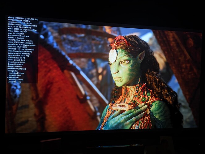

Here’s another screengrab from another source:
My final thought on this is Avatar The Way of Water probably isn’t the best material to faithfully showcase HDR. Instead, we should focus on real-life material (e.g. nature, fire, water, landscape and “flesh tone”) to have a better gauge on the color fidelity in HDR.
