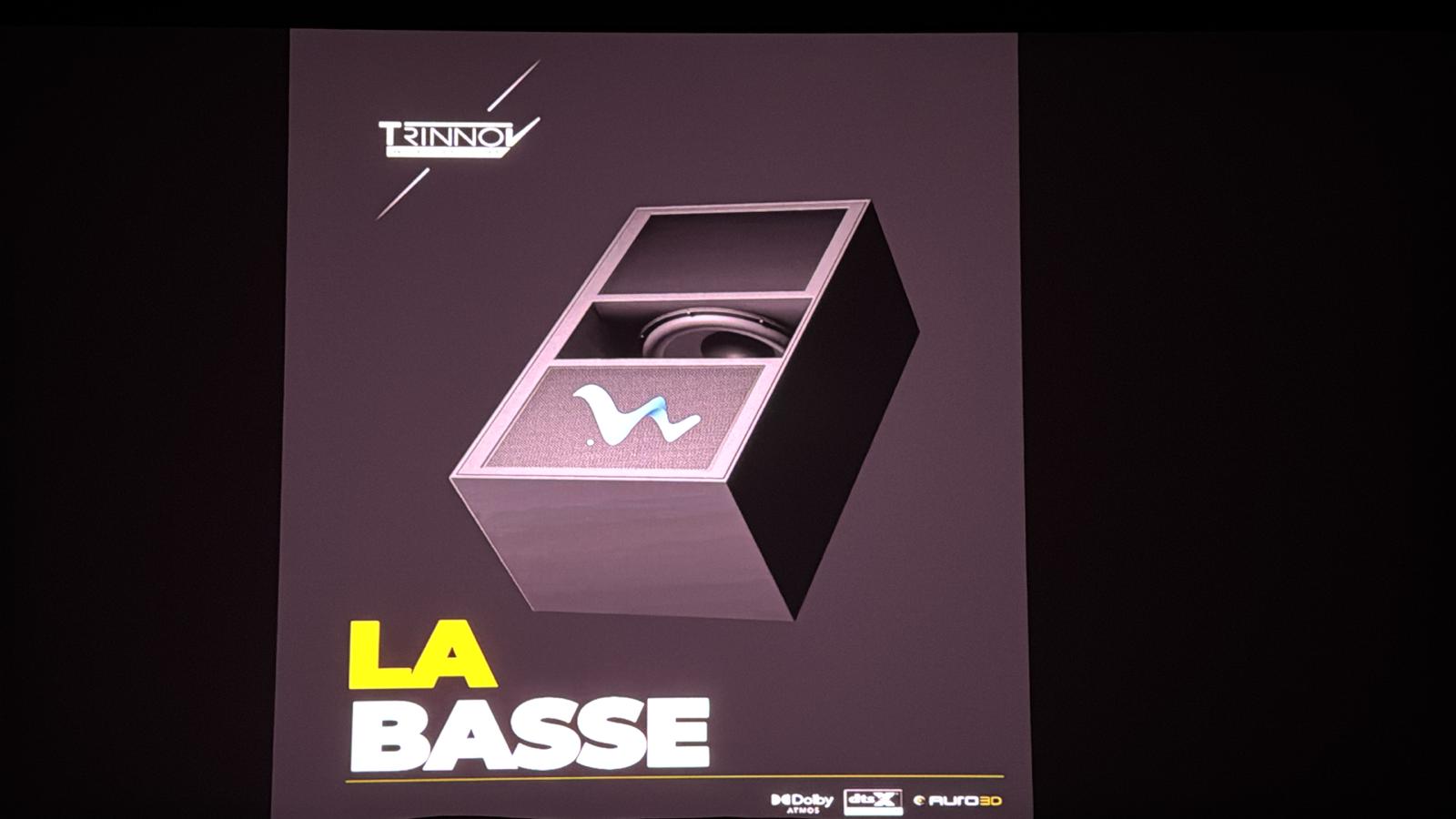

Bassheads can try this trailer. Insane 4 mins of infrasonic Awesome bass!!
