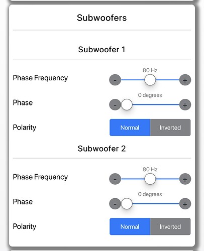

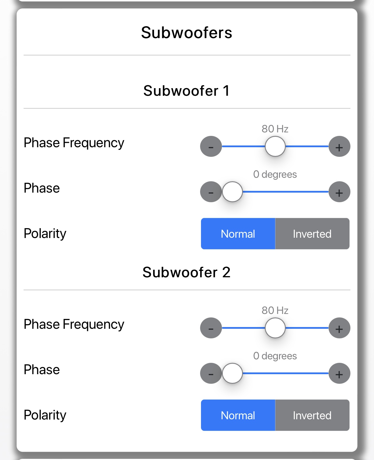

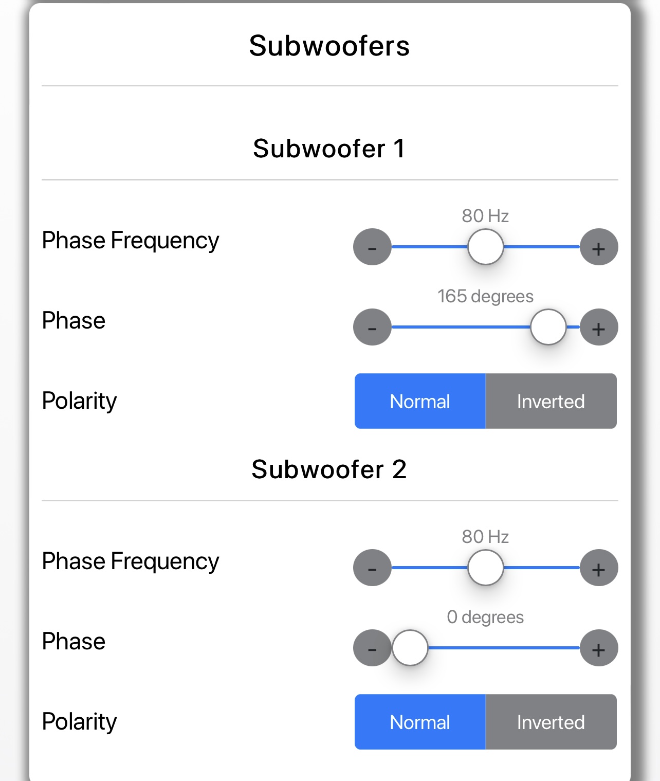

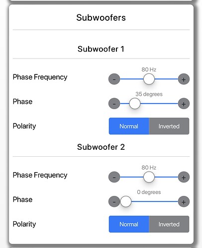

I’ve 2 sets of speakers and setup 4 profiles…
Strangely the ARC assigned different phase correction to all of them;
I ran 2 measurements
Phase align only for Focals (there’s no option to run separate phase alignment for the different sets of speakers).
Pro1 - Focal 7.3.2 adjusted curve
Pro2 - MBL 2.2 adjusted target curve
Pro3 - Focal 7.3.2 ARC original calibration
Pro4 - MBL 2.2 ARC original calibration
Profile 1
Profile 2
Profile 3
Profile 4

I understand what you are saying but my point is that those are not old/prev numbers.
If ARC only updates the main profile then Profile 2-4 phase settings should remain unaltered (ie prev values).
However in my case these are not prev values and I do not know where it came from. Cud it be randomly generated- but then why,… or cud be just a sw bug.
In any case for my specific situation it makes sense for Profile 3 to be same as Profile 1 since they are the same spkrs;
But for Profile 2&4, they are different speakers in different position/location in the room and and rightfully should hv different values
