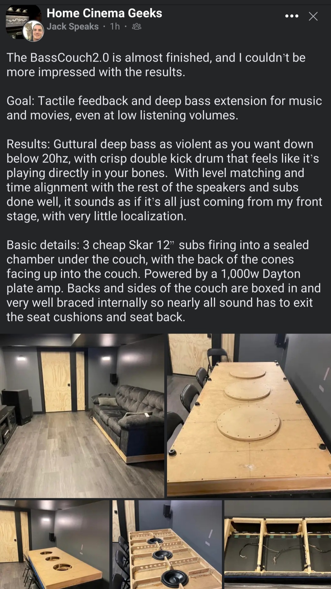

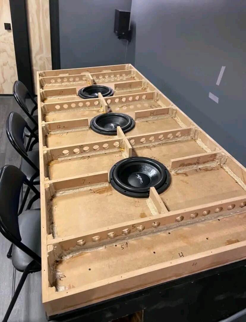

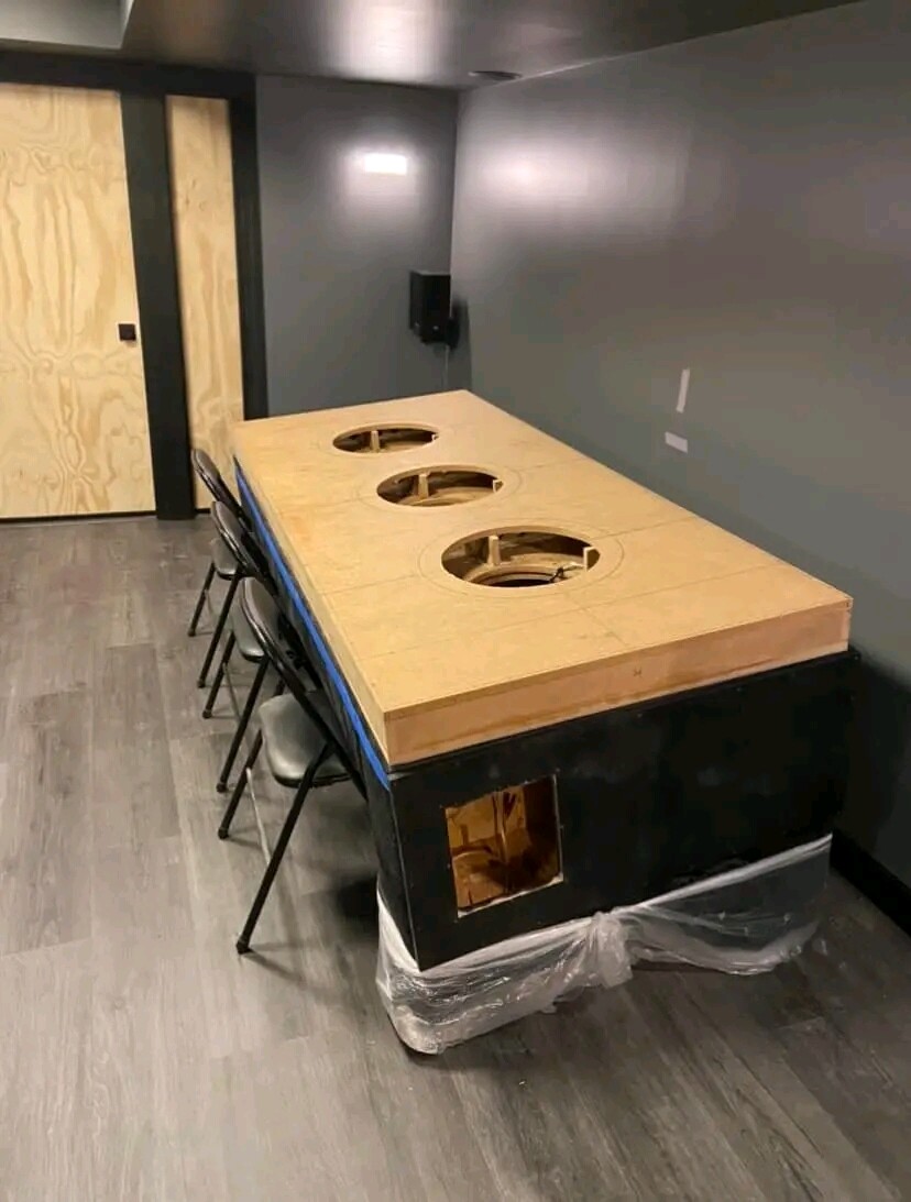

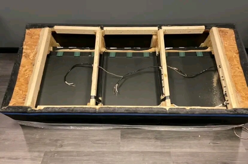

Coincidentally, saw this this post that is a unique take on the tactile sofa. It is quite different from the BOSS system, as it makes use of the air pressure wave from the driver.
A sub enclosure is built around the bottom of the sofa. The key difference is that all the bass pressure output of the driver has to exit ‘through’ the seat and back of the sofa…
The sealed subs fire upwards into the cavity below sofa.

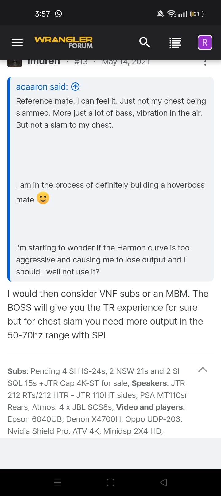

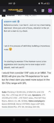

See this one from Aaron, it looks like the chest slam is also not happening on his set up, and he is looking to solve it… one old post … he seems to be guessing it could be due to house curve
I think Aaron knows what is missing on his set up, like what he is expressing, he can feel it just that his chest area is not getting slammed , lotsa bass in the room but not at the chest slam
The above :point_up: is exactly what I’m talking about when I started the thread…

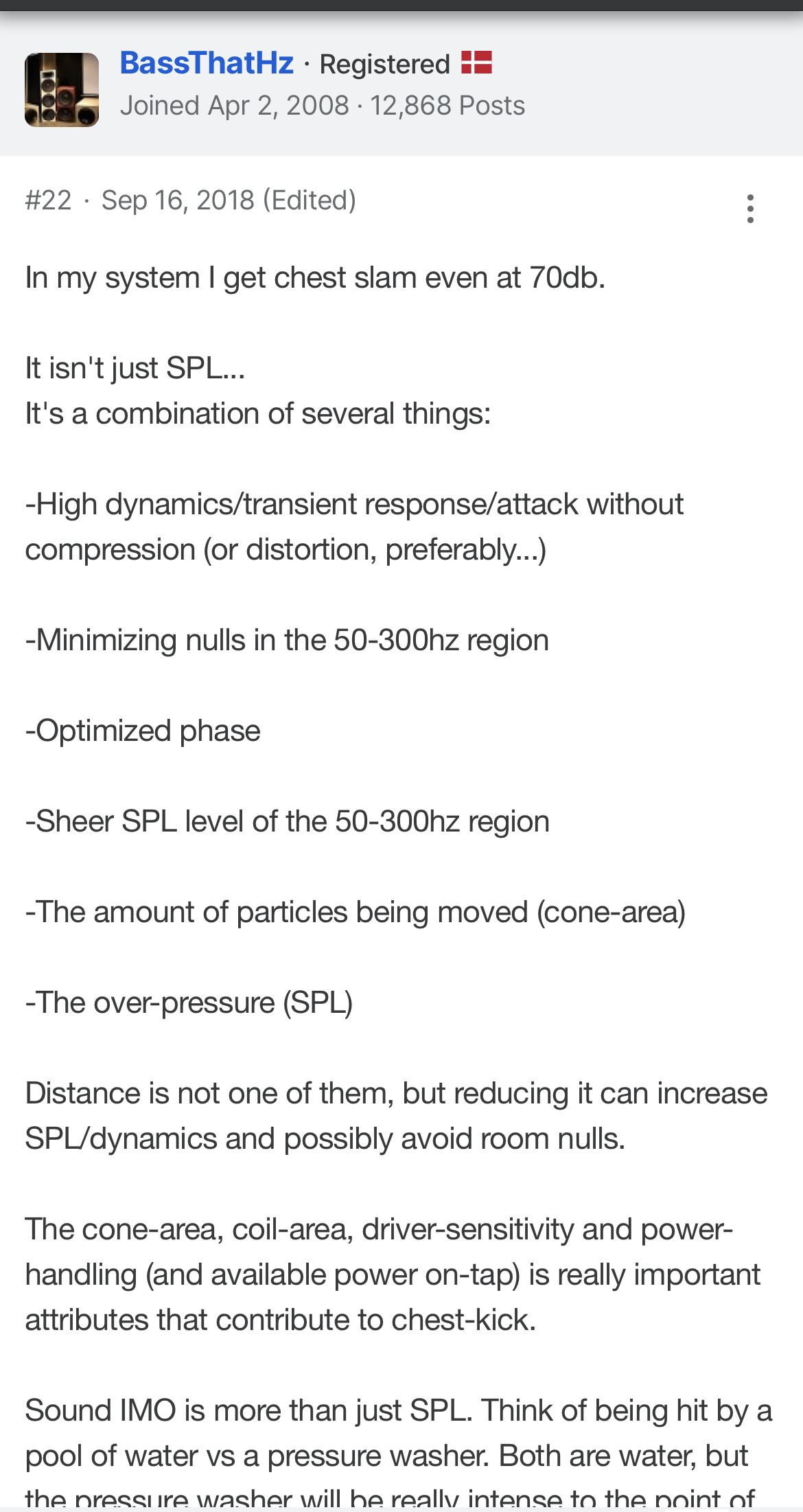

I was still looking around and came across this on AVS forum , this is quite interesting I thought it’s worth a share
As you would abserve above, bassthathz guy had the same experience, he got it with only 70db SPLs
I believe it could be a combination of several things as well

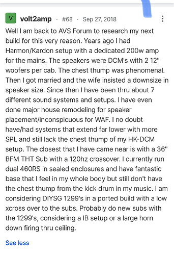

Then we see volt2amp, he mentioned that he achieved it with just 2x12” subs, the same experience I had with that Dali set up…
See how he explains it, it’s a similar tactile thing that he is after, similar to Aaron above, they are not after more subs , more SPLs , more infrasonics or how big the subs etc etc, they only want a simple thing, “chest slam”
This is very addictive for many, because not only it tracks better with on screen action, it slams the body at different heights & gives one that layered feel when watching movies or listening to songs . Doesn’t matter how much u boost, it just either exist or don’t…
