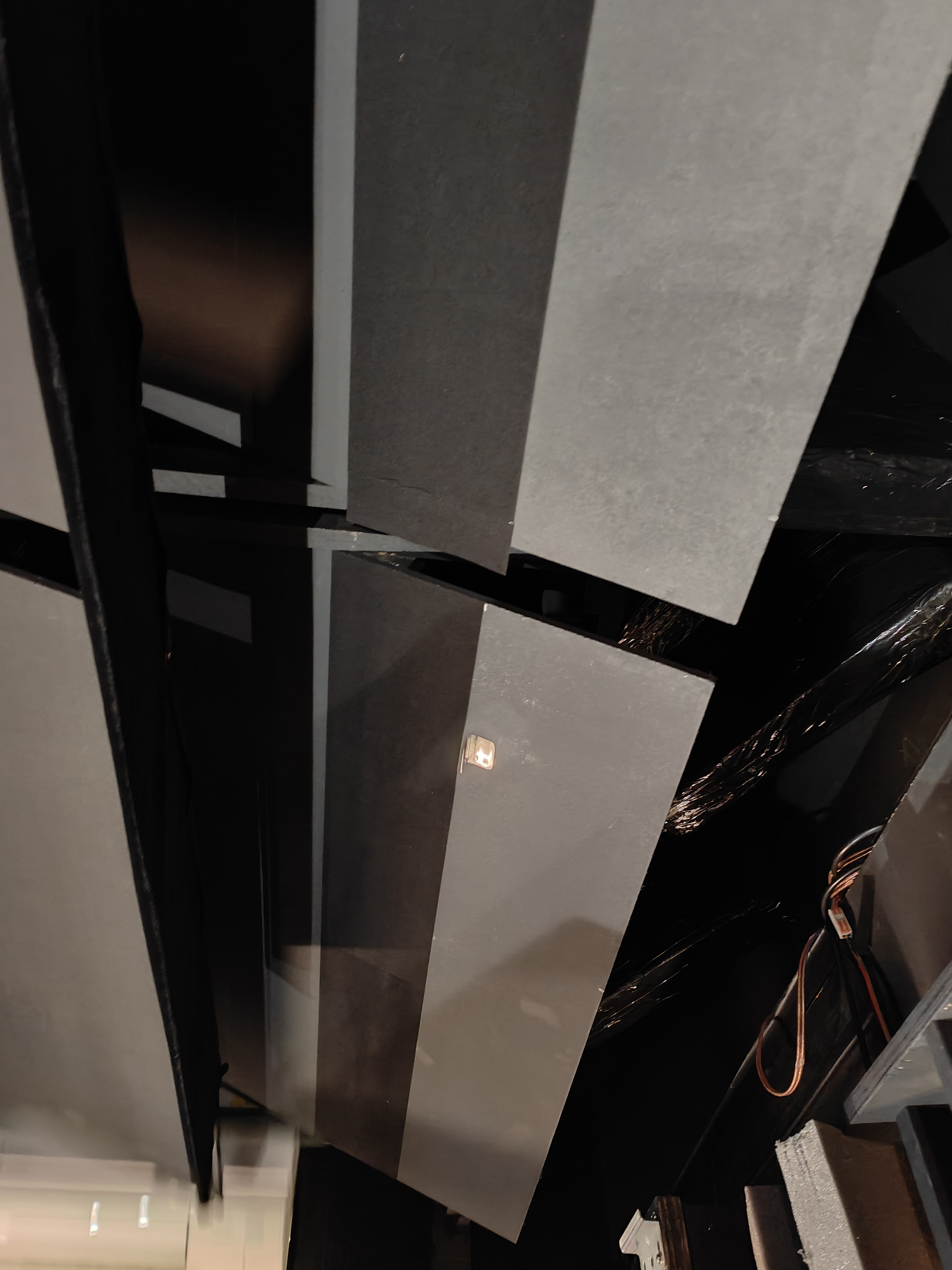

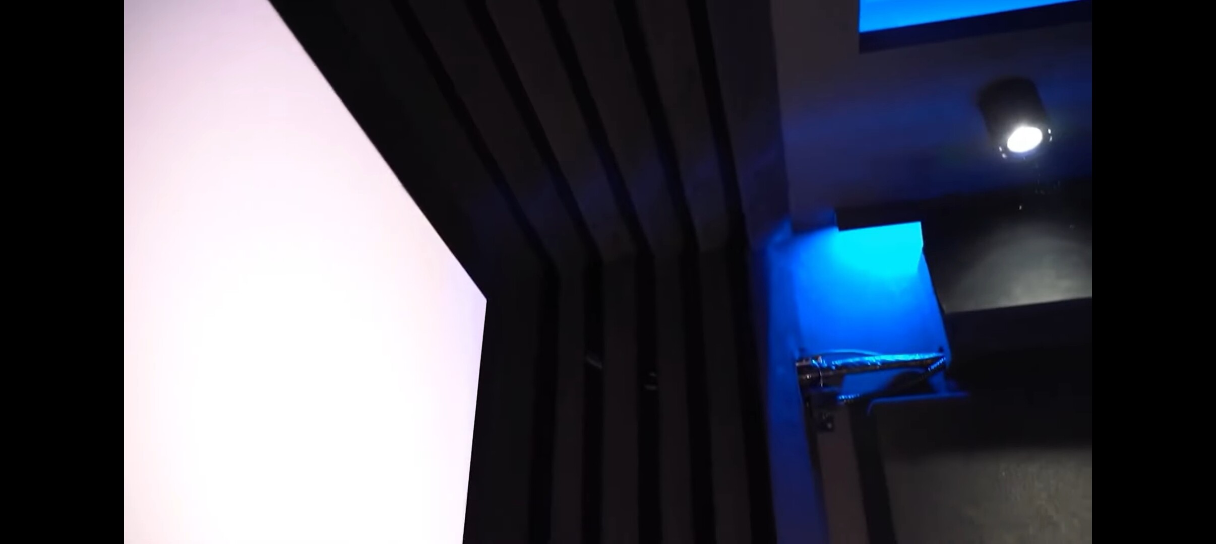

One of my original ideas is to use angled slats to redirect the light reflection. This is from my personal experience looking at reflections in the room from various surfaces. Some surfaces, even though they are not black, look totally pitch black with no reflection from the screen. This is due to the angle of the surface, there is no light path from the screen to reflect off the surface to the viewer eyes.
To my pleasant surprise I see the concept implemented by Black Room cinema. He calls it optical diffusers. 11 mins onwards in the video link.
This can be used on any surface that is very close to the screen - ceiling, sidewall or floor.
They consist of an array of panels at ~45 deg to achieve this non reflective angle.
In theory, the panels can just be painted black, don’t need to be super black felt non reflective material to avoid that kind of reflection effect that you see on my floor.

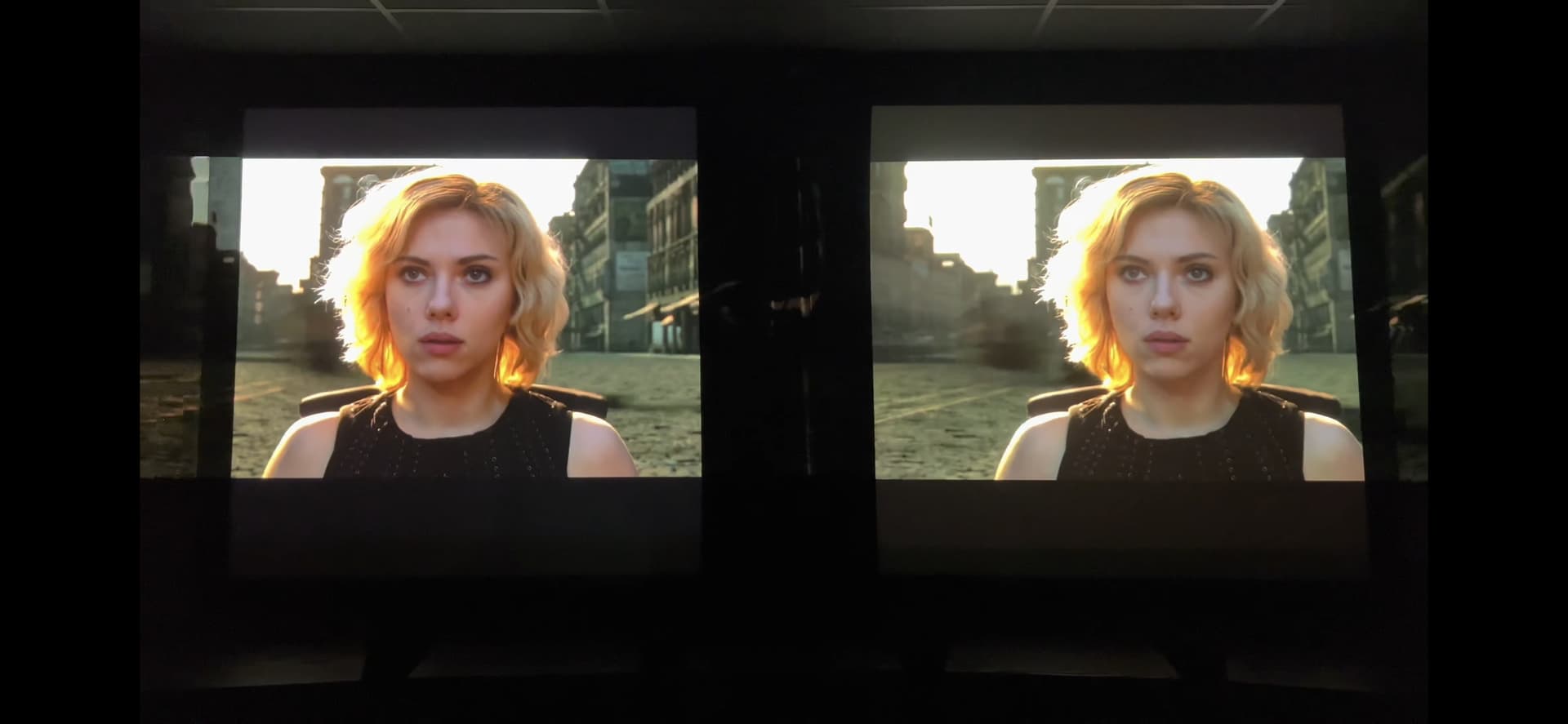

But here’s a photo that shows what I mean. Which one do you think think is the JVC NZ7, which is the Epson LS12000B?
Photo from Avsforum. If you stalk the projector discussions like I do, this may be familiar.
What is happening in that image, is due to reflected light internal to the projector optical system and light engine. Bright areas spilling into the dark areas, washing out the colors, reducing mixed contrast and ANSI.

The optical diffusers achieves the first, but doesn’t achieve the 2nd, unless you also treat the surfaces Behind the slats to absorb instead of reflecting the light back onto the screen.

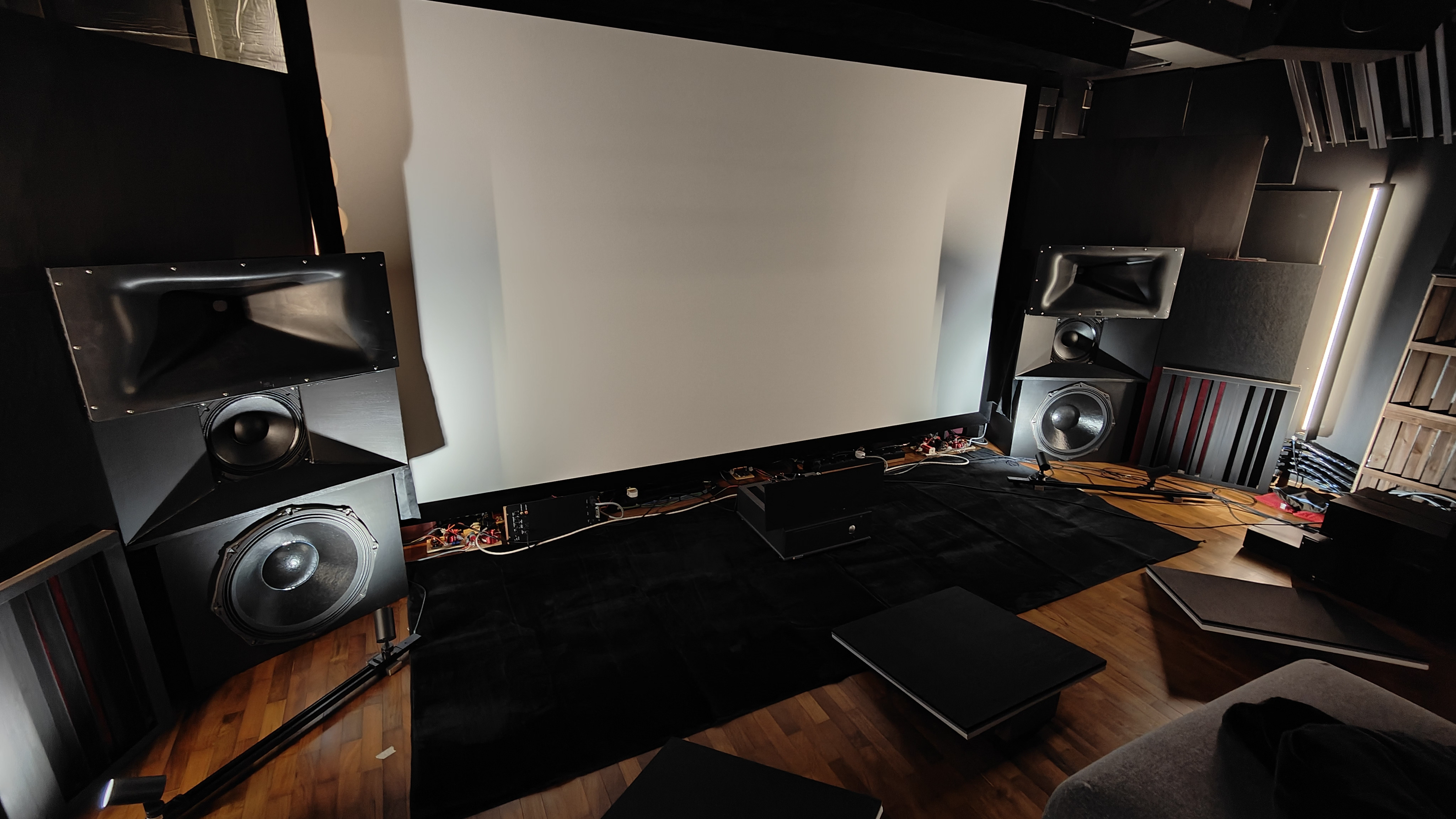

I have some preliminary experiments on my ceiling. The angled panels are large slats, and there is definitely still a lot of reflected light back to the screen. Recap - I added some felt strips to try and reduce this.
Long story short, will try some black thin carpet for the floor directly in front the the screen. Just ordered.
That then requires the front power amp to be moved. Will also rewire the front LCR speaker wires and XLR interconnect, maybe change the LR amp, reposition the 5ch amp, various other iterations as I figure out how to place the equipment - processor and amps.
New rugs arrived.

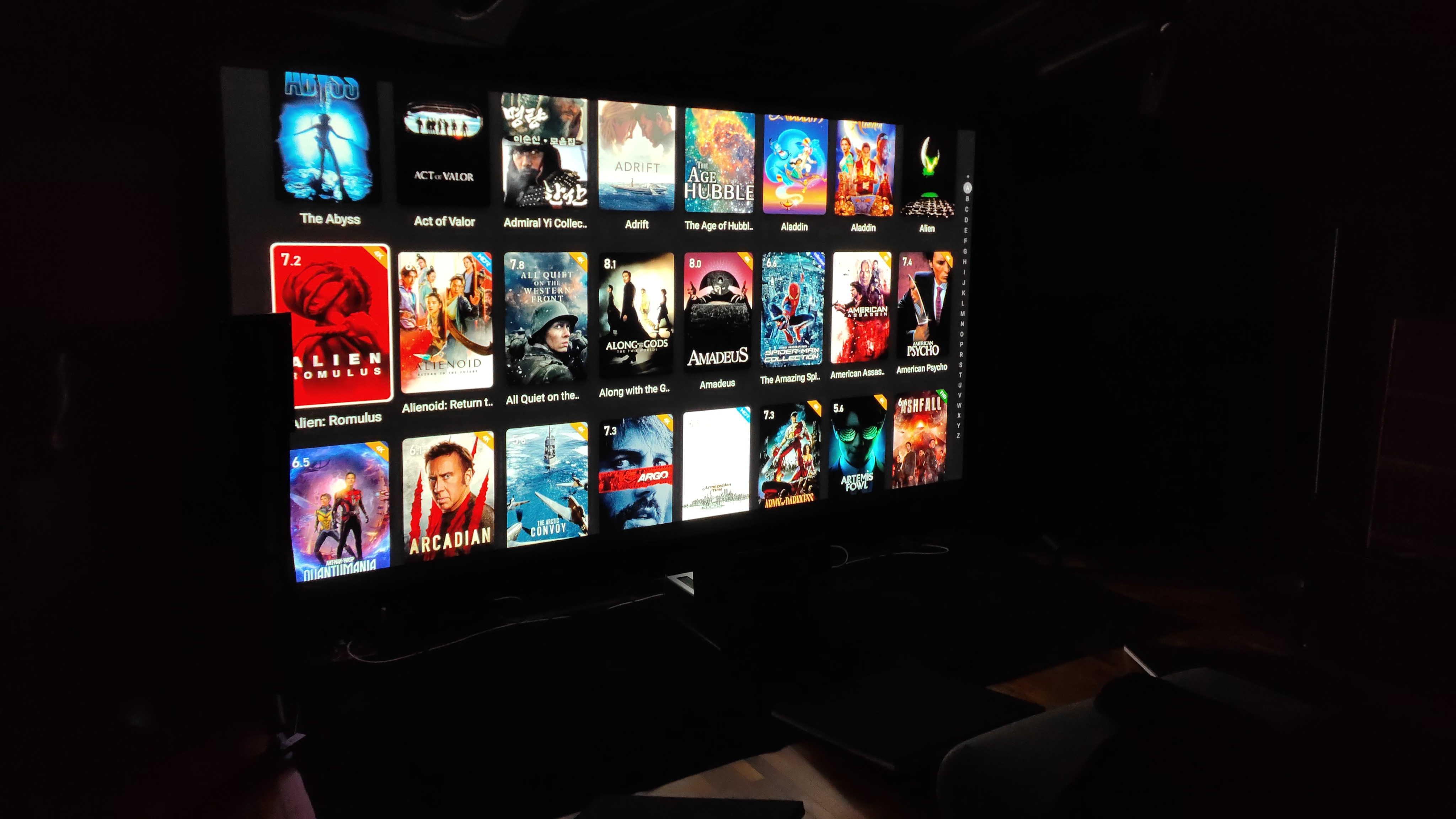

Nice improvement in blacks, even more contrast and pop.
Black letterbox bars also less distracting.

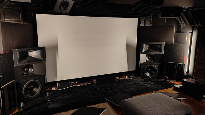

One more shot non wide angle.

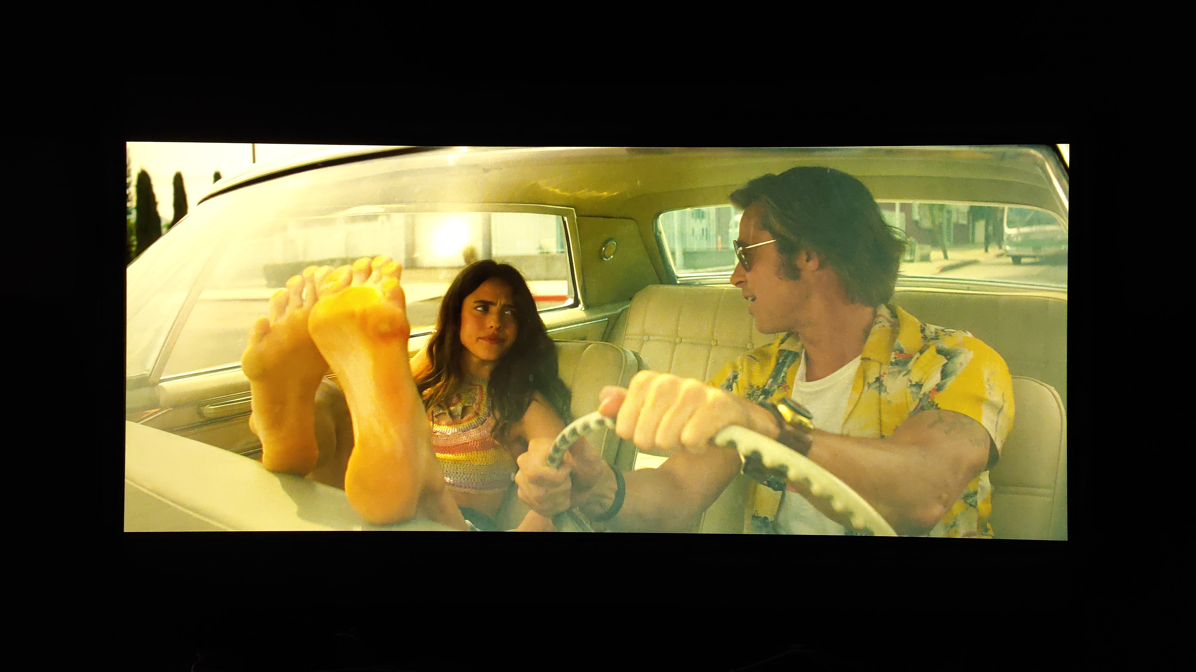

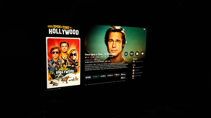

Happened to be watching this last night.
Tarantino’s foot fetish :joy:
Black hole effect.

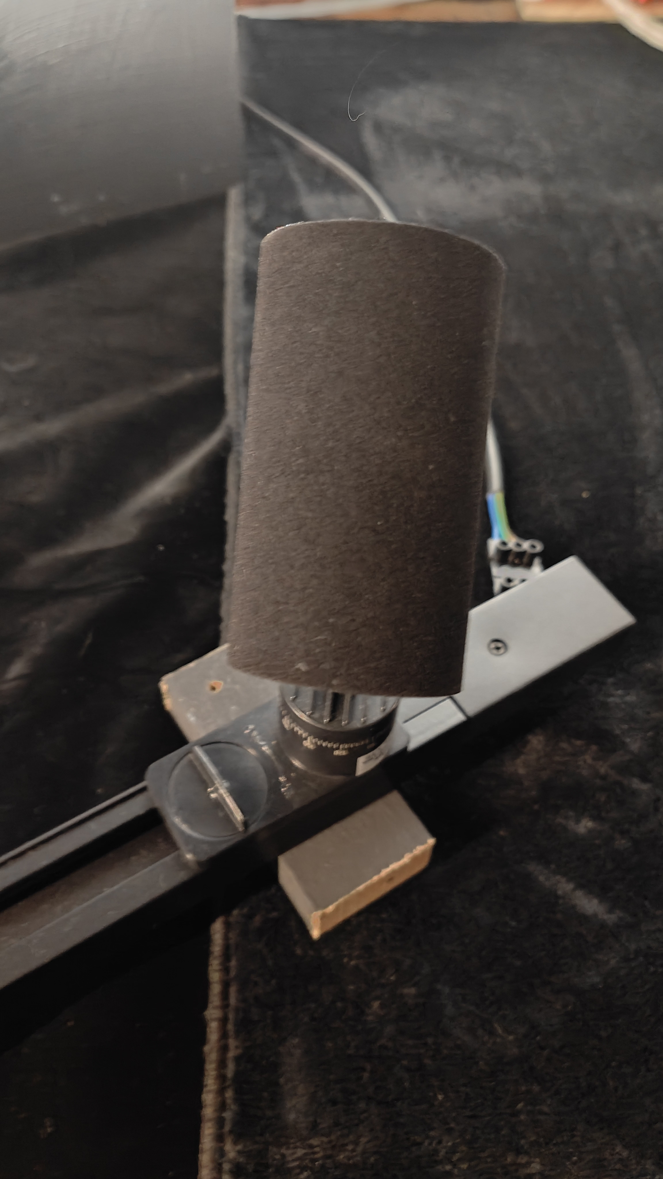

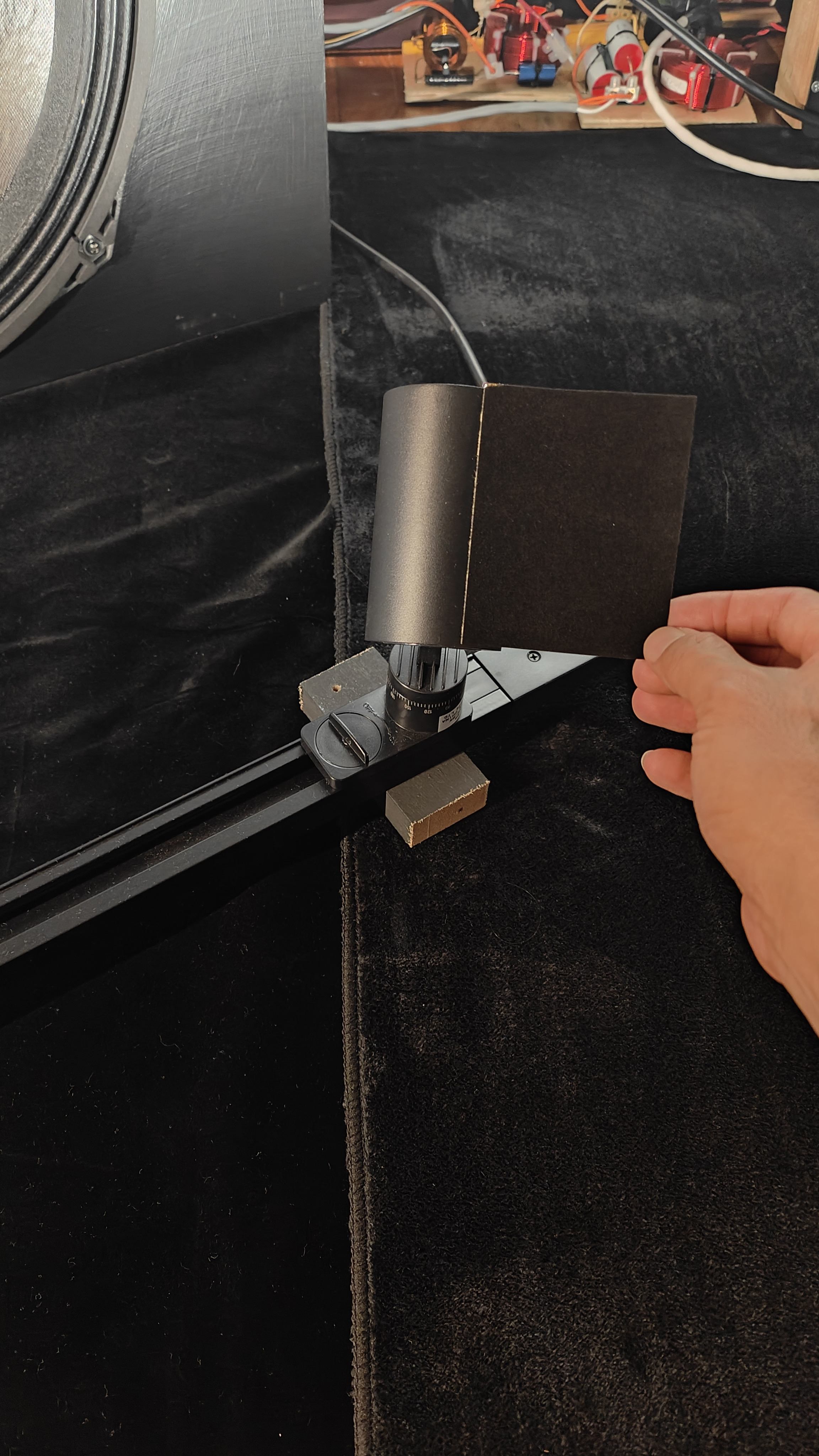

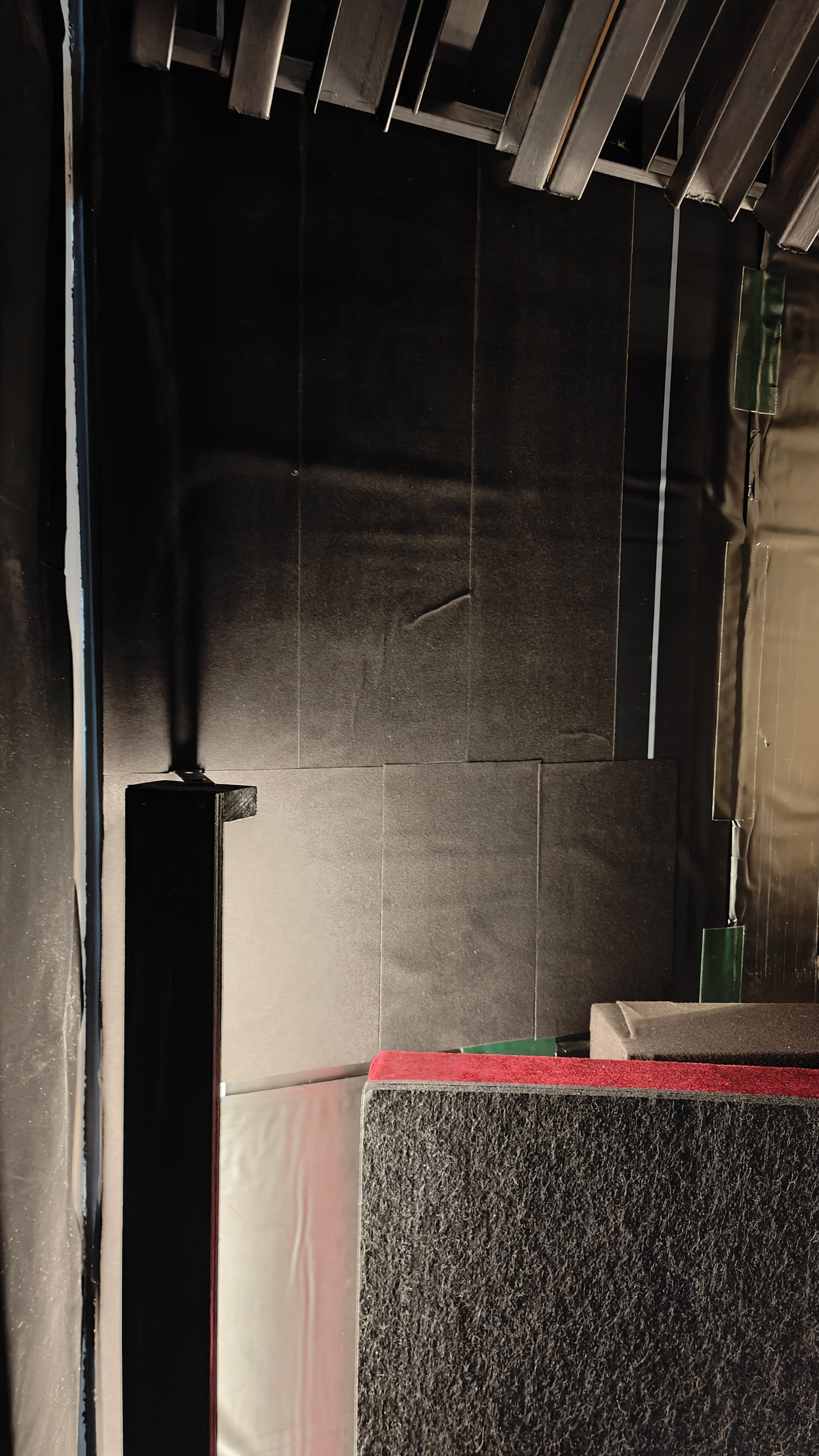

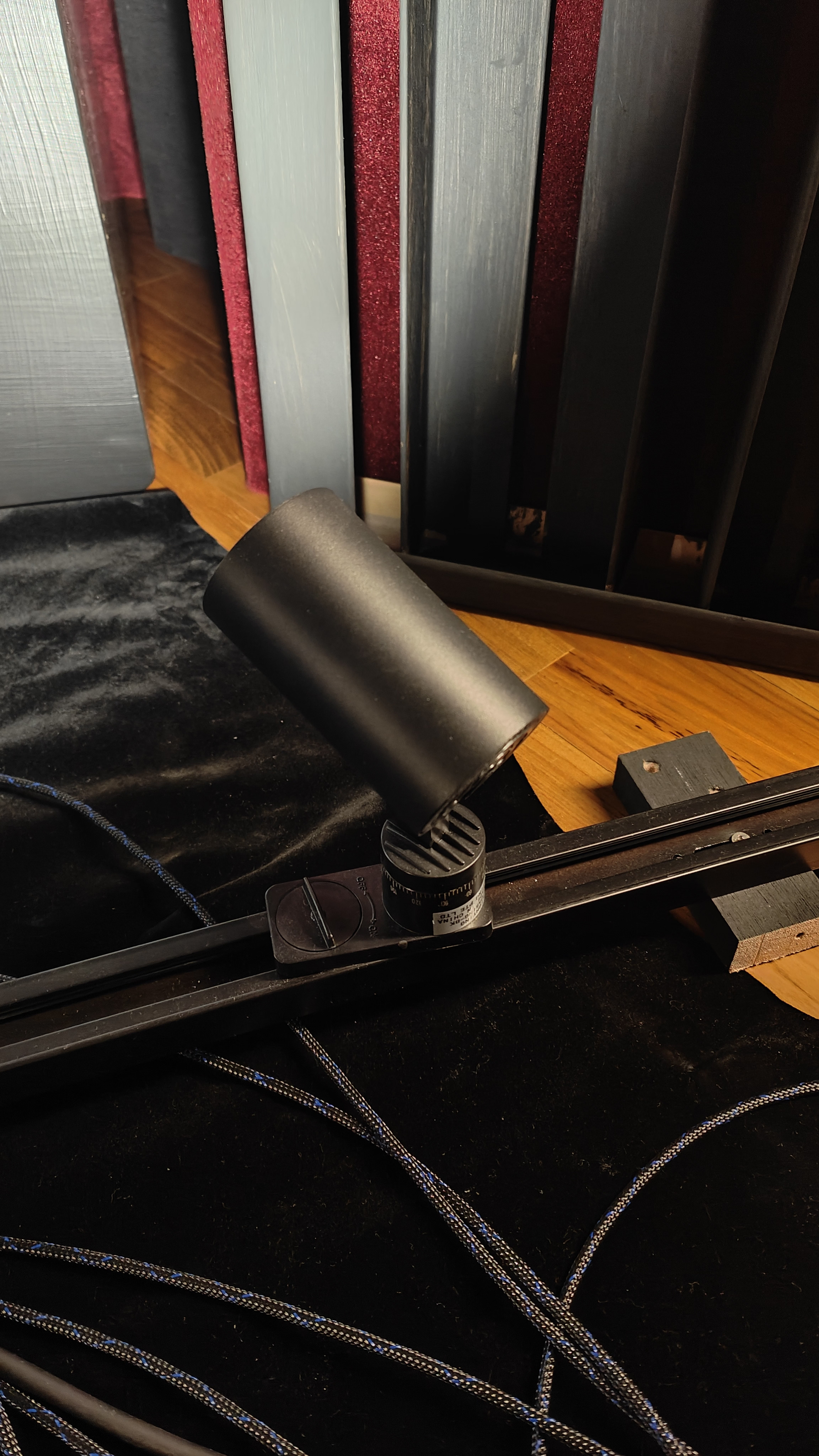

Noticed abit of screen reflection glinting off the black housing of the spotlight.
Also glinting off the bitumen sheets on the left wall. Felt over it.

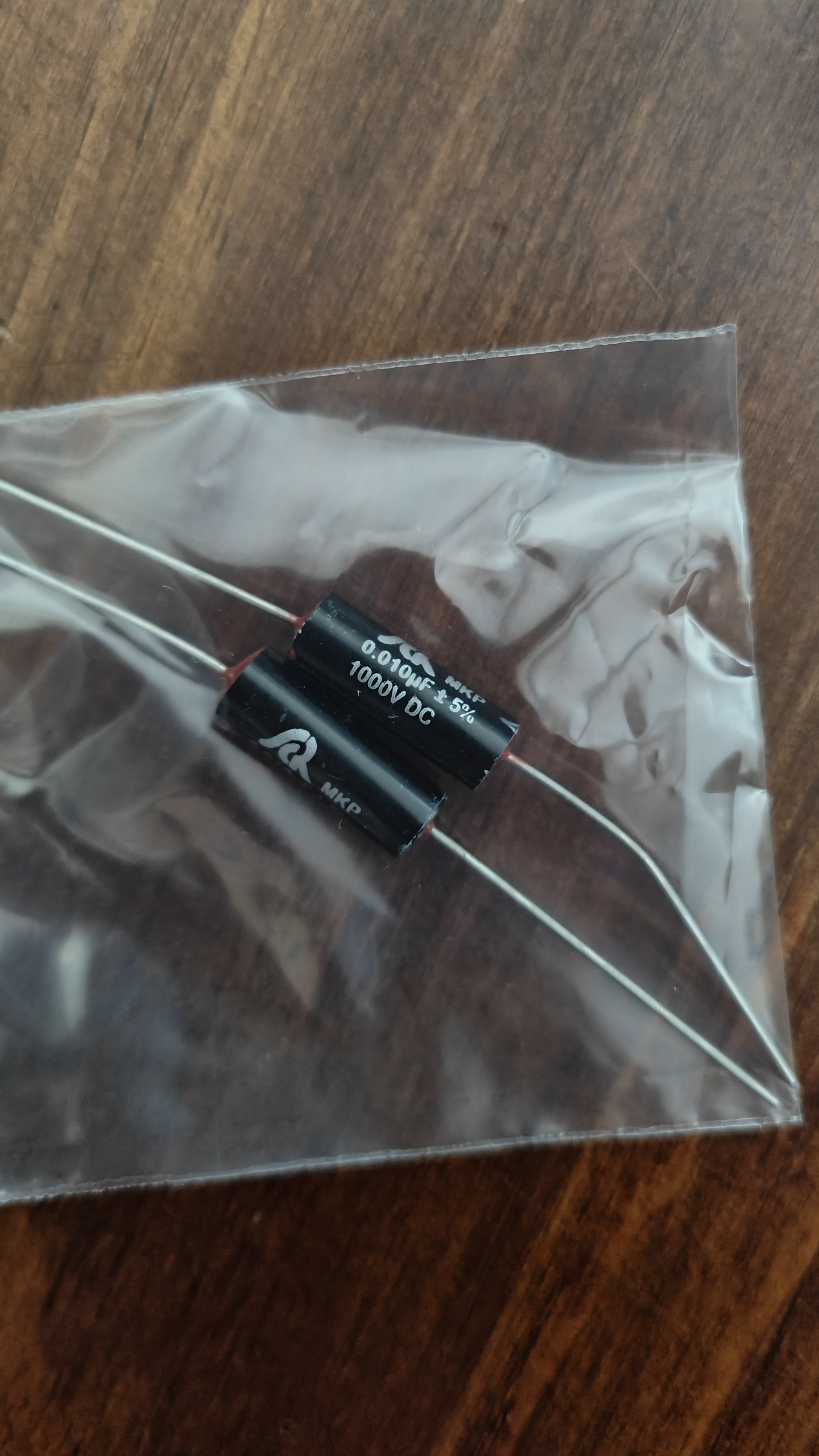

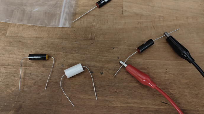

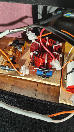

Bypass caps for the HF.

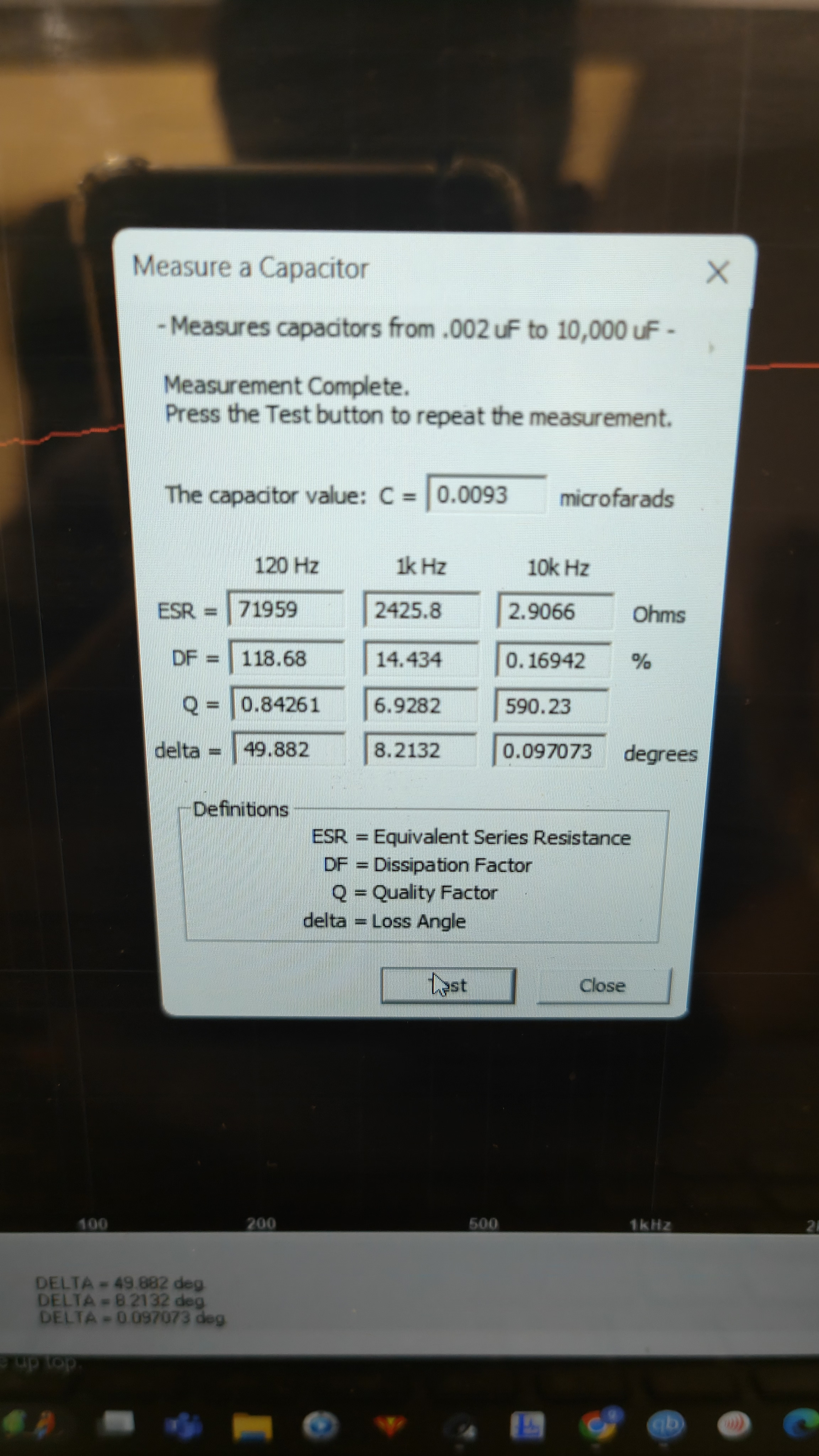

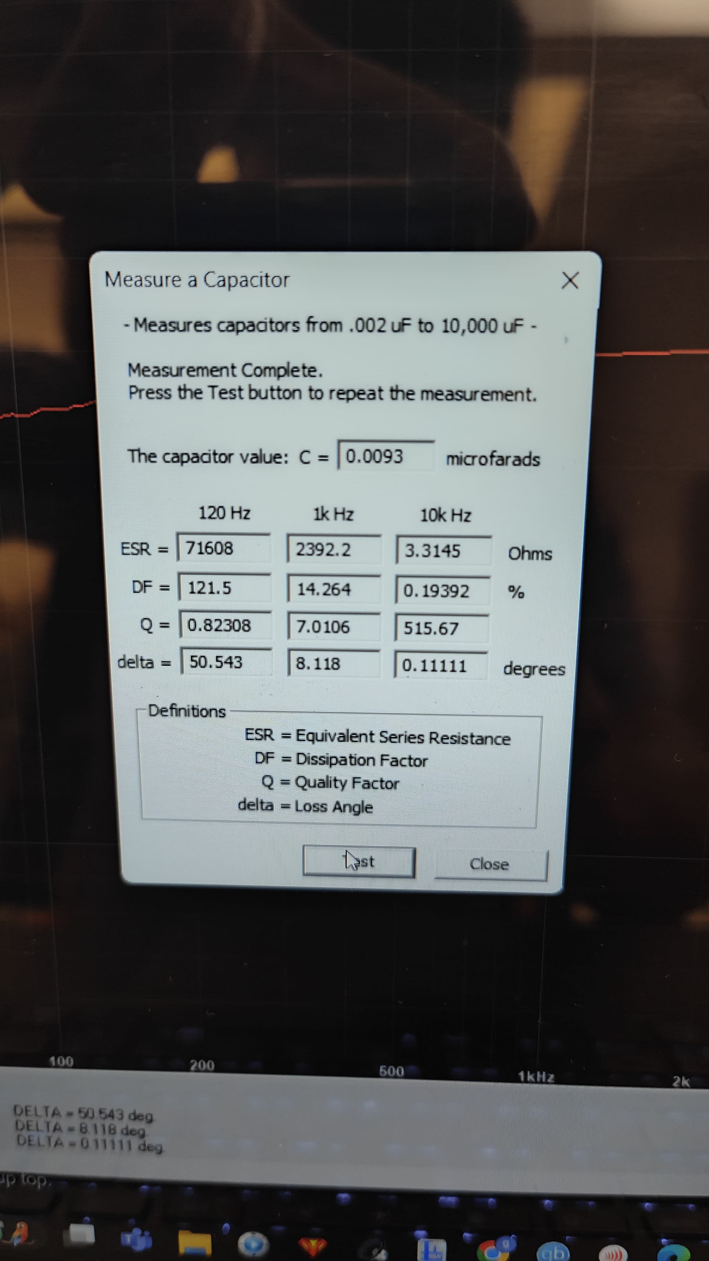

Shoot some measurements first for sanity check and data for future references.
Seems well matched the 2 caps.

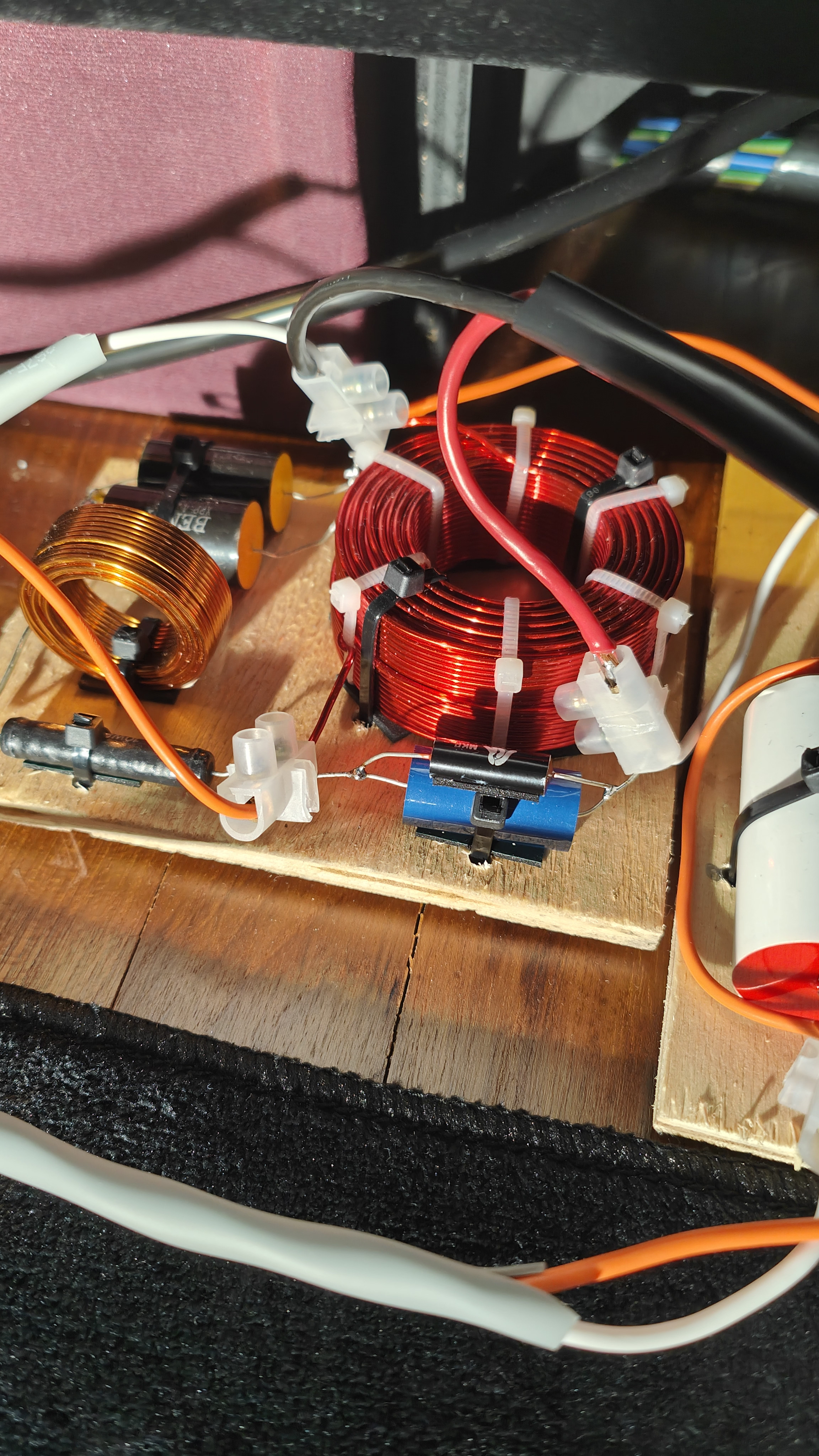

In situ solder on the bypass caps onto the main tweeter cap.

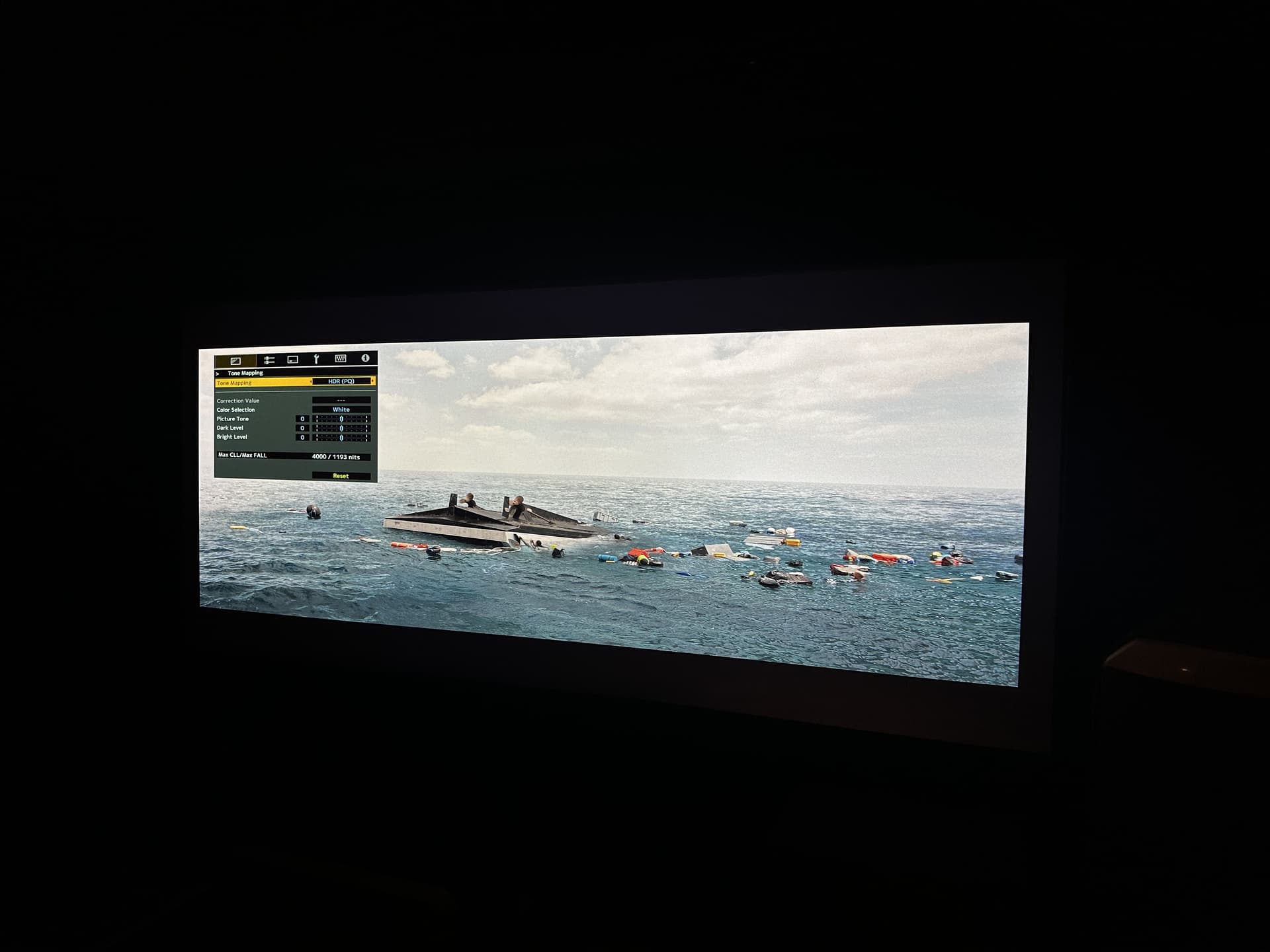

This is from The Meg, which is the torture test of tone mapping 4,000 nit scenes that have been shot. The Lumagen does well here with nice cloud detail, which is usually washed out for most projectors. Even Dolby Vision LLDV doesn’t do very well. I’d post a shot of this from MadVR, but am currently traveling until early August.
