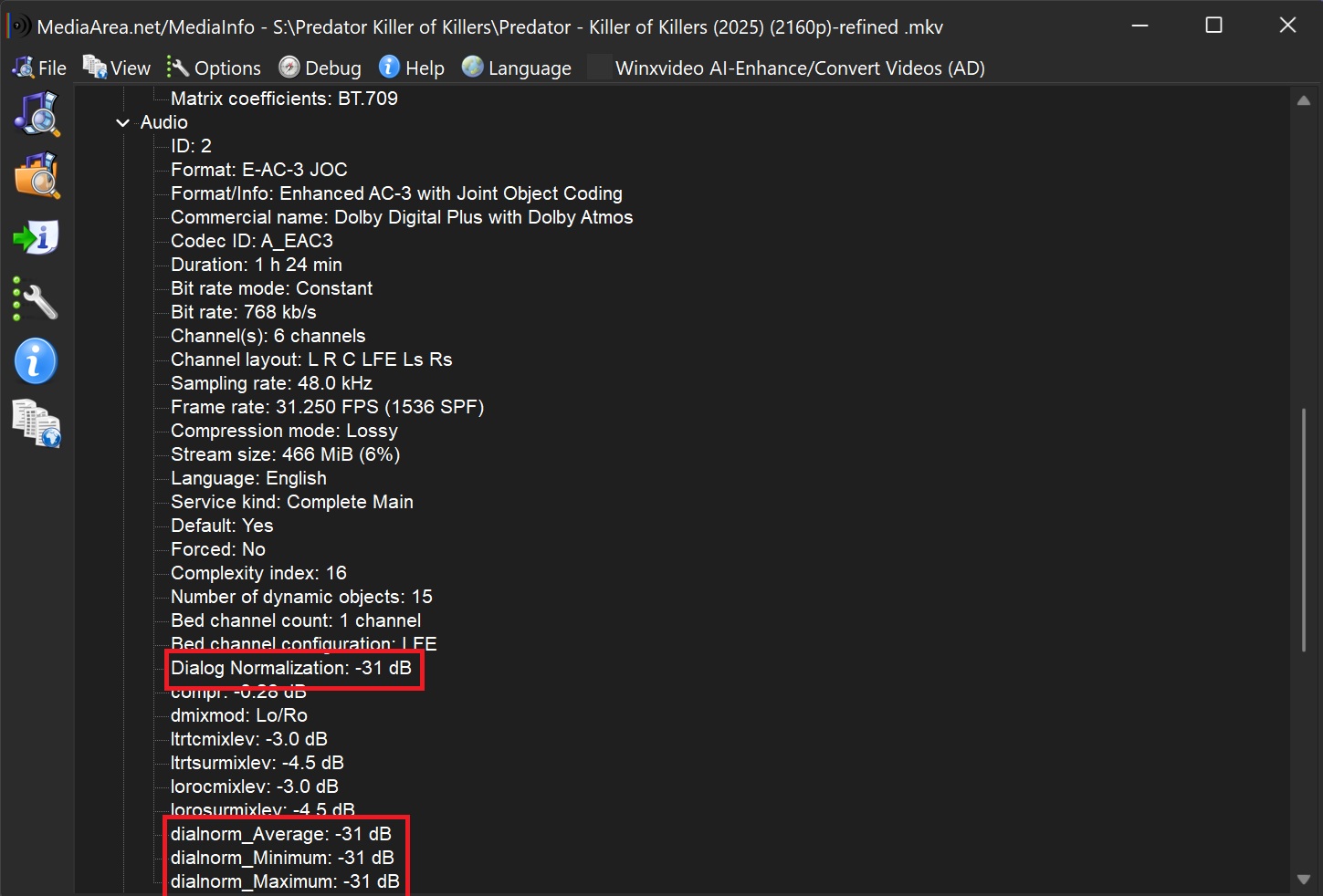

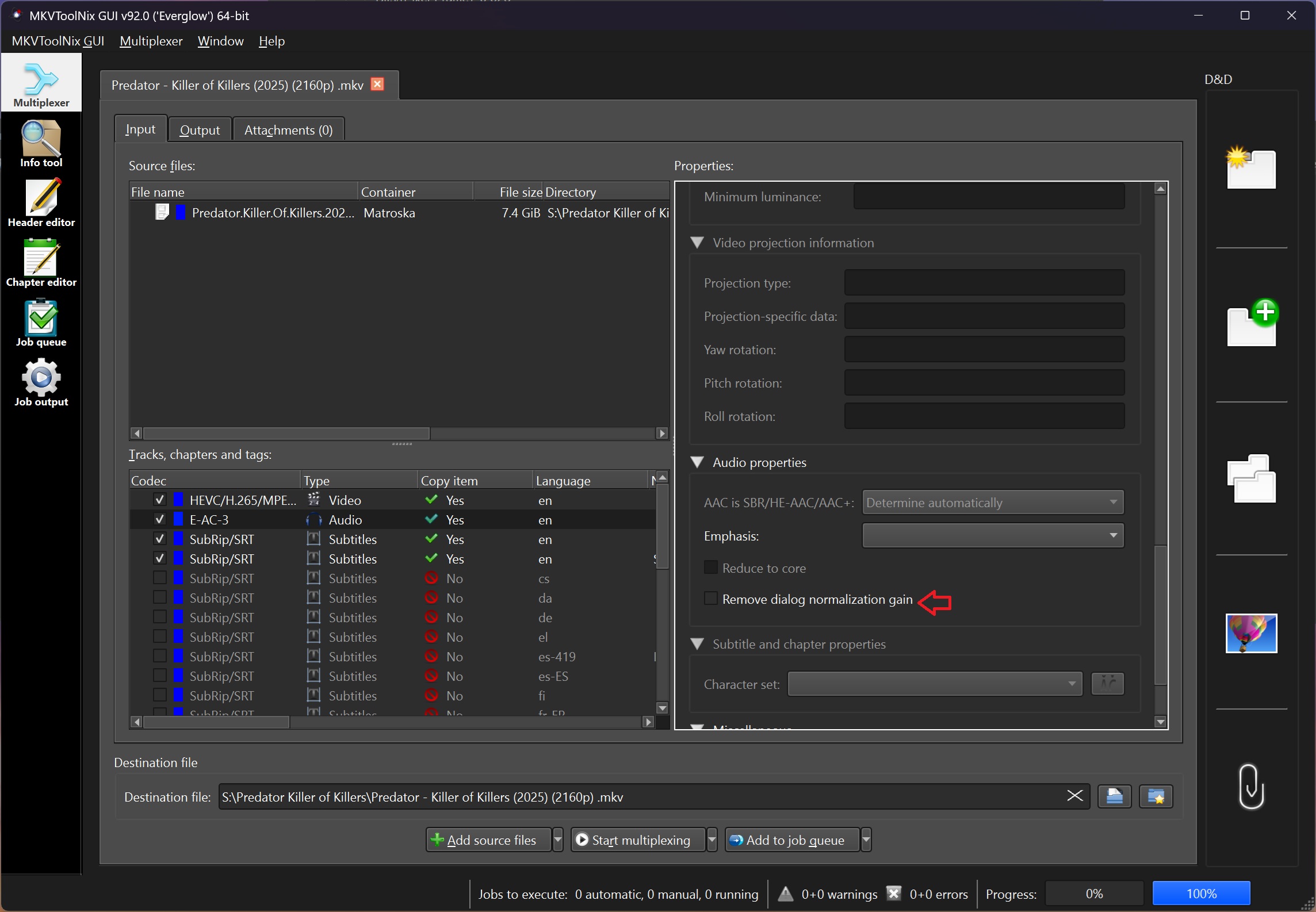

The best way is to defeat the Dialnorm if you can but there are only a handful of AVR and Pre-pro that can do that, mostly D&M Amps and AVRs. For Anthem and most other brands, no luck! One way is to re-author the movie (.mkv or .mp4) to remove the Dialnorm and reset it to -31dbFS (no offset). This can be easily done by using MKVMerge utiltity (freeware). Here’s an example of how to remove the Dialnorm.
Using MKVMerge utiltiy to remove the Dialnorm

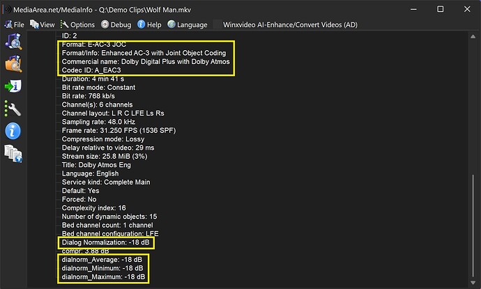

One example where the sound engineer clearly knows what he/she is doing is the movie, Wolf Man (2024). The Dialnorm for this movie when authored in a E-AC3 + Dolby Atmos track, it has a huge differential in Dialnorm in the upwards of -18dbFS. This is almost 13dB of difference, meaning you would have expected the overally sound level to drop very drastically considering such a big attenuation.
However this is not true. In fact, if we re-authored the tracks and “normalize” the Dialnorm to -31dbFS, then the sound level at your normal listening level will be extremely loud. This is one rare caseload that only came to light after I have experimented it.

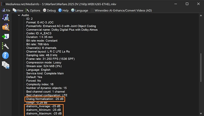

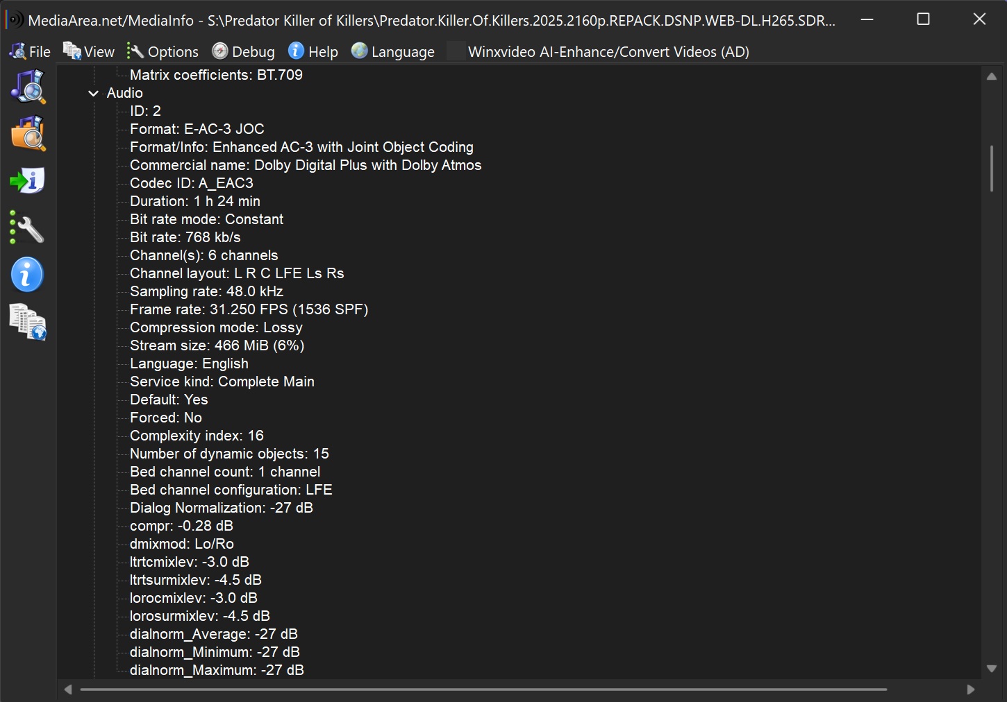

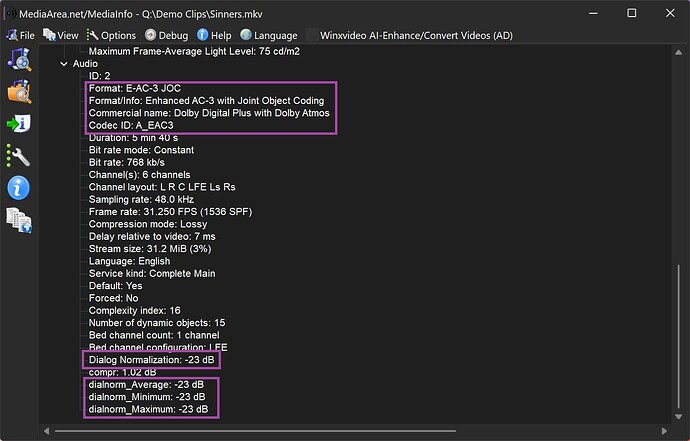

Here are some examples of Dialnorm in some of the recent movies encoded in E-AC3 + Dolby Atmos. Noticed not all are using the default Dialnorm of -27dBFS.
