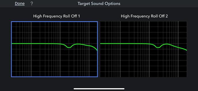

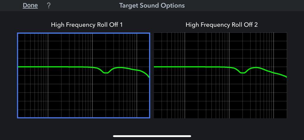

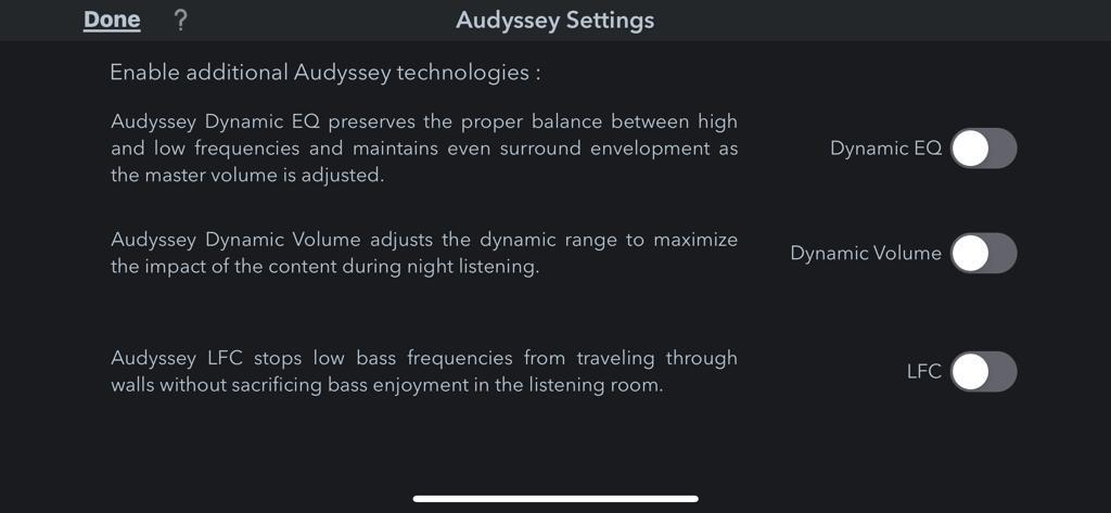

The problem with Room correction is that it most often relates to over equalisation… that’s the biggest problem.:.

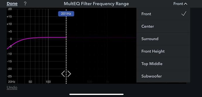

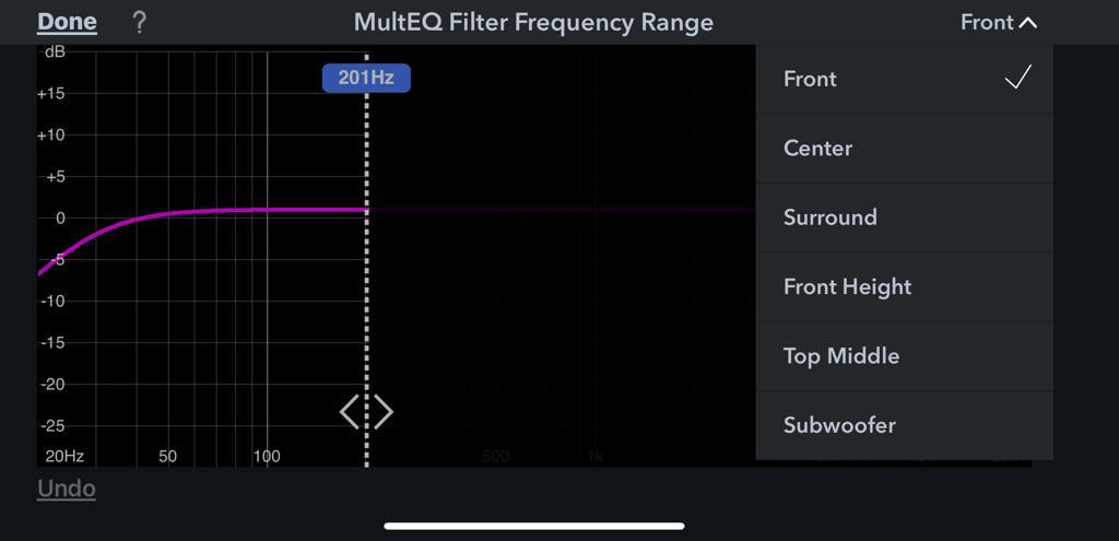

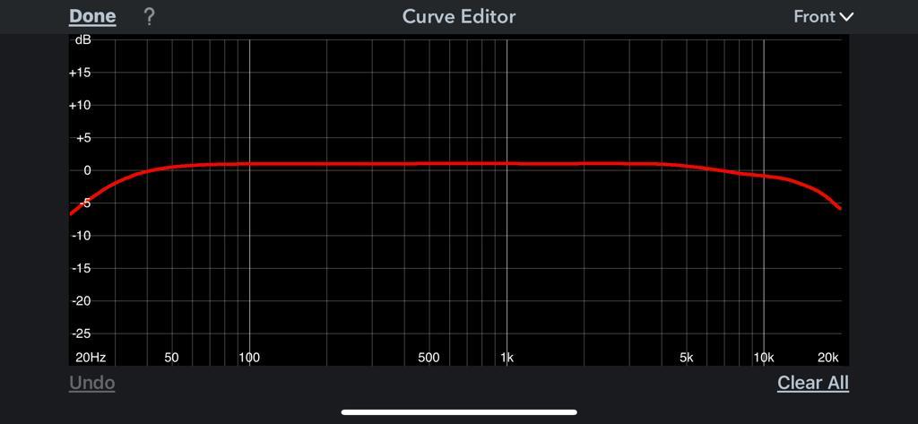

Recently I headed over to my relatives place and helped him tune his denon 3700 with the multeq editor, it was fantastic, the denon 3700 sounded really good…
We can switch off bbc dip
We can choose to eq up to Schroeder freq, or only eq where necessary
You can tweak with house curve
All turned off option…
We even compared the manual calibration I did for him vs his audyssey calibration vide the preset option, you can actually A B on the spot which sounds better… and decide from there… clearly he preferred the manual calibration vs the audyssey calibrated version… we also had the minidsp 2x4 hd to dial in the bass
A lot of improvements from denon, quite impressed ! A lot more options for the calibrator to tweak to his heart content … not bad really…

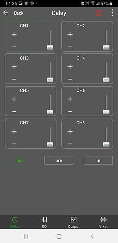

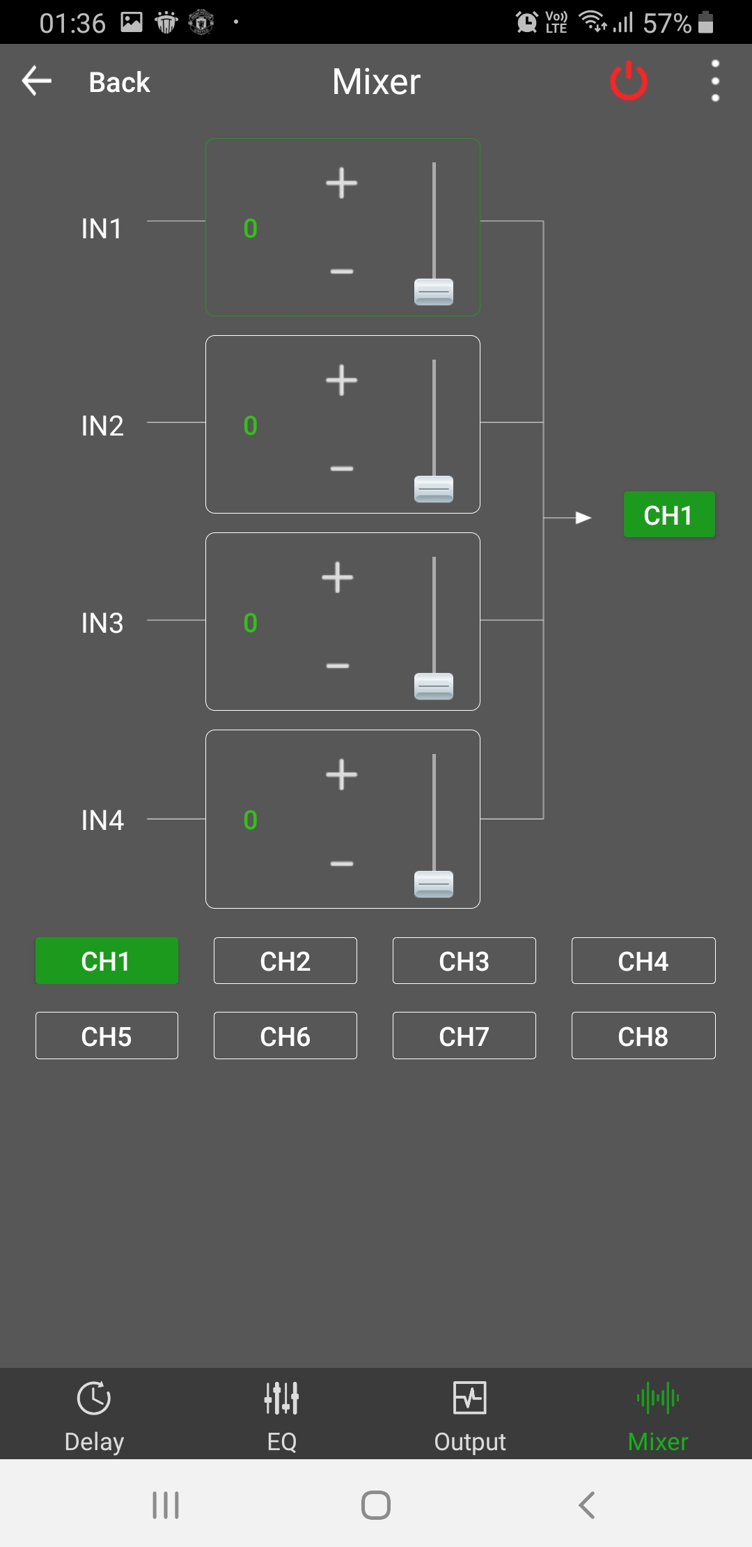

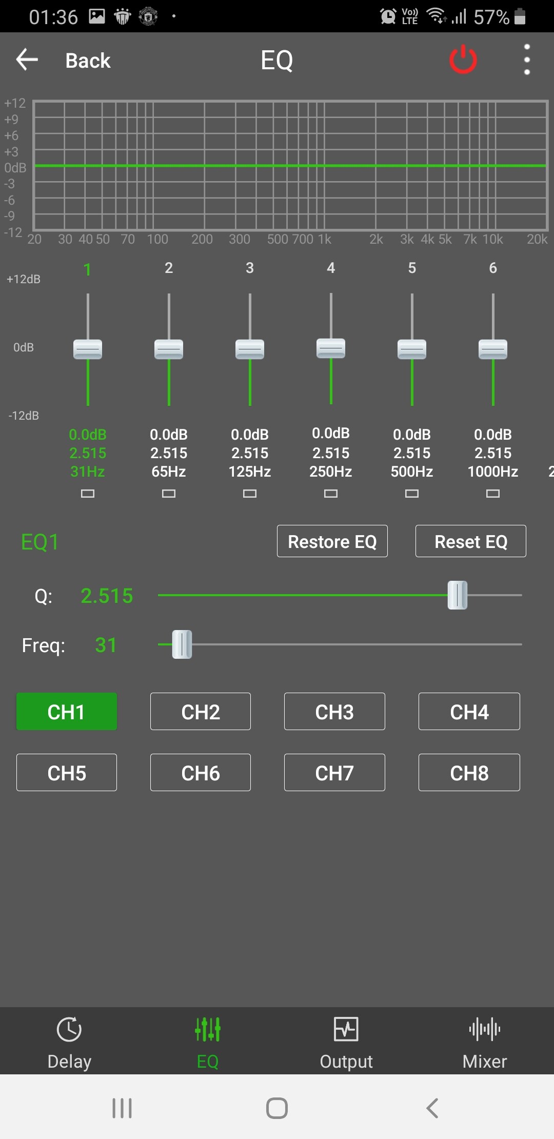

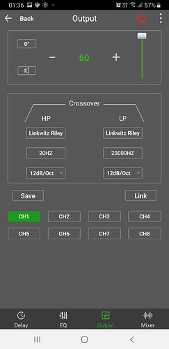

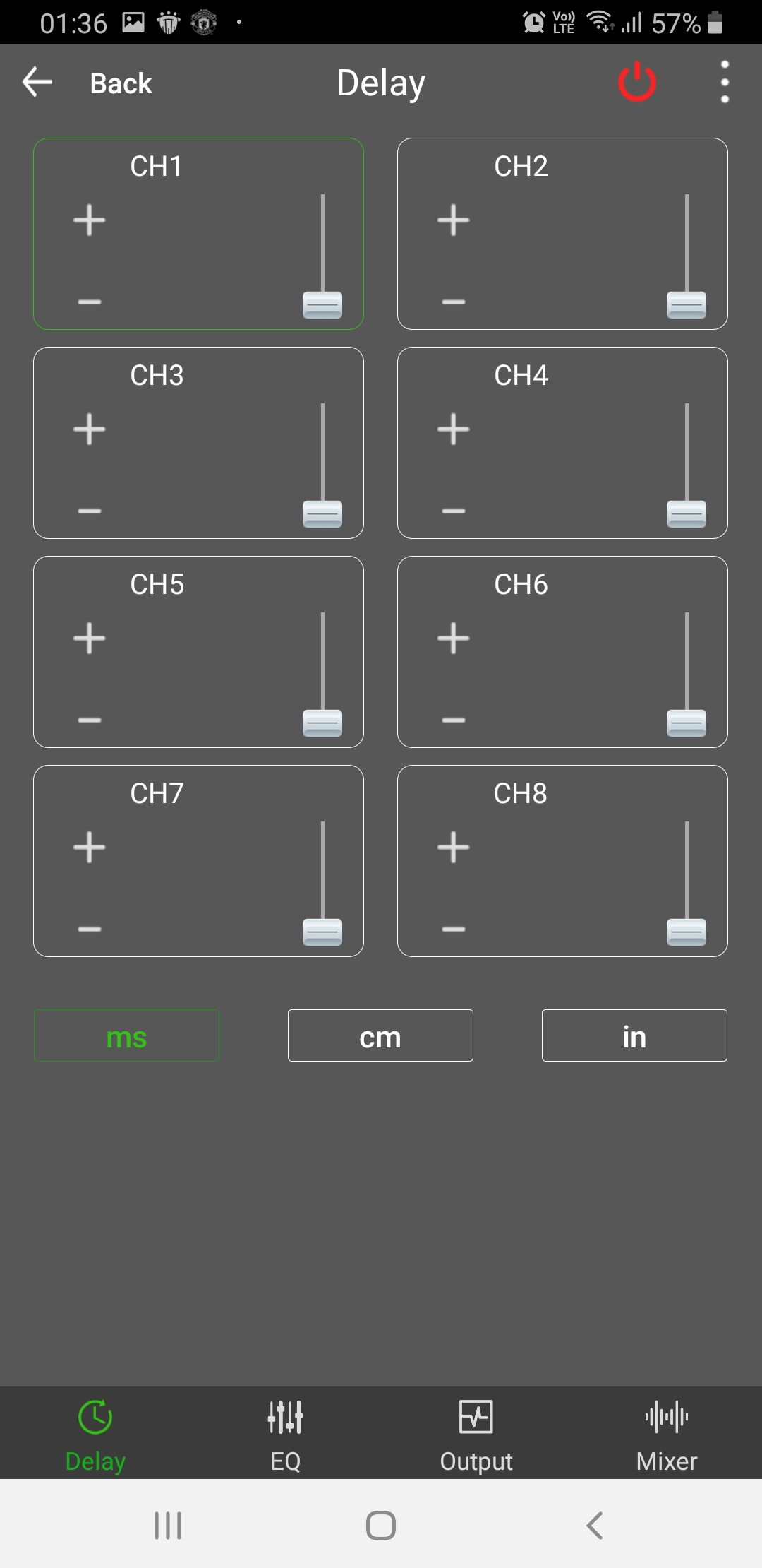

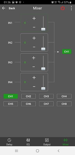

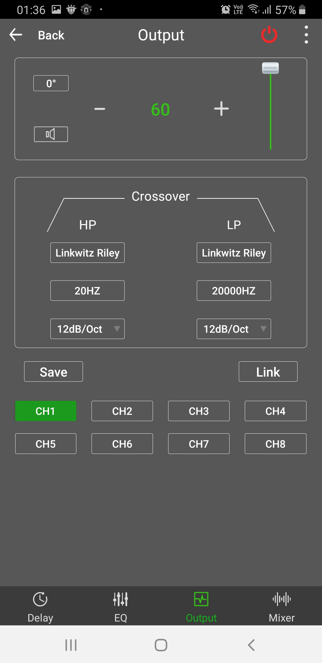

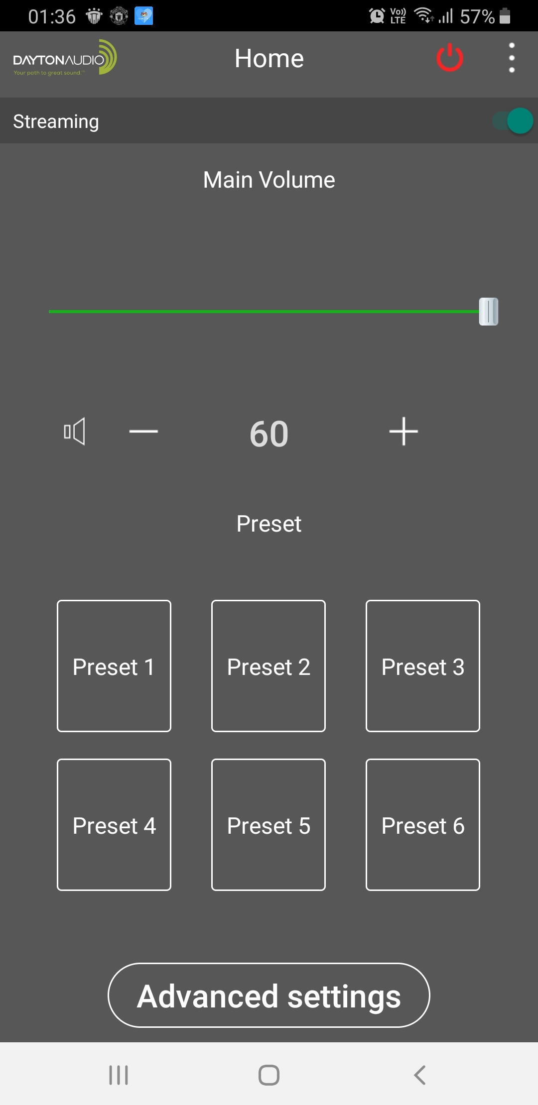

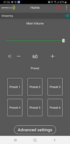

I been using the Dayton DSP 408 for almost 3years.
Just need to Download the app to phone and using a bluetooth doggie to connect to the DSP-408.
It is a In4x8out dsp. Can adjust everything on the fly from your phone once it is connected. Very convenient to do tweaking on the fly when you test the movie clip. If you found some movie bass was a bit weak or soft. You can have up to 6 preset house curve add and rename. You can also adjust each individual sub gain or all at once on the dsp itself. At time if you want to off (reducing the gain from dsp to zero) a few subs while watching movie or listening to music… :blush:. This is also useful when you want to take measurement for each individual sub.
